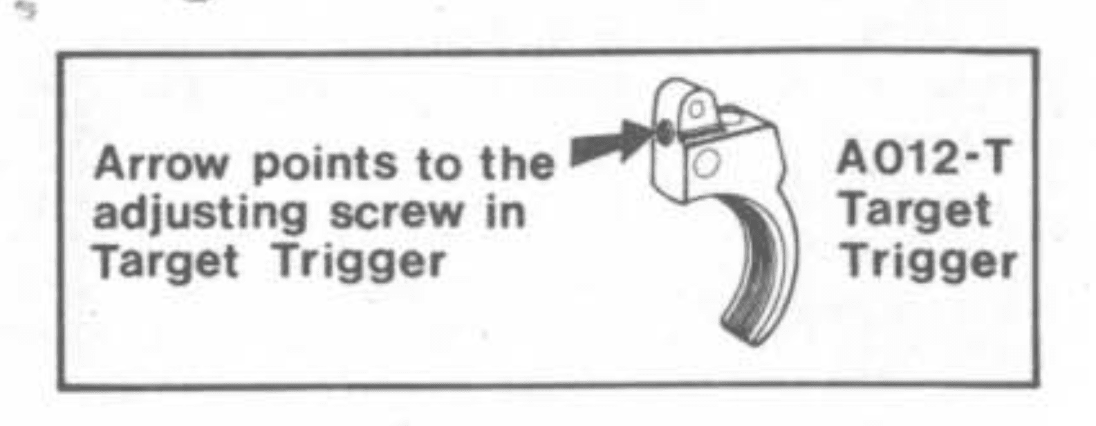

Actually, there was an over travel screw on the MKII Target models but it wasn't visible externally, you had to disassemble the pistol to get access to it.
This is correct. The adjustment screw is on the front face of the trigger instead of being in the shoe. You have to pull the trigger out to adjust it.
The Standard models were not made with the screw. Only the adjustable sight models were.
I believe this is what you are asking about as mentioned by TE.

wproct is correct,, but considering the OP was asking about a gun he saw,, BEFORE buying it,, the internal screw would not be visible. So,, that's why I knew it was not a factory overtravel screw adjustment.
