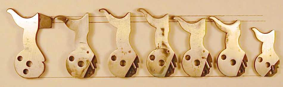

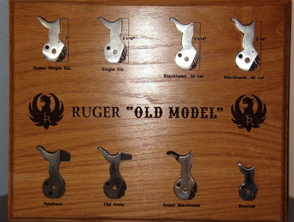

"Aren't the Super single six hammers a little shorter to clear the rear sight? Maybe it has a single six hammer installed?"
This was my very first thought when I saw the "problem" explained. It's always possible someone replaced the OM parts with an incorrect hammer type. (Think; factory transfer bar conversion, later reversed.)

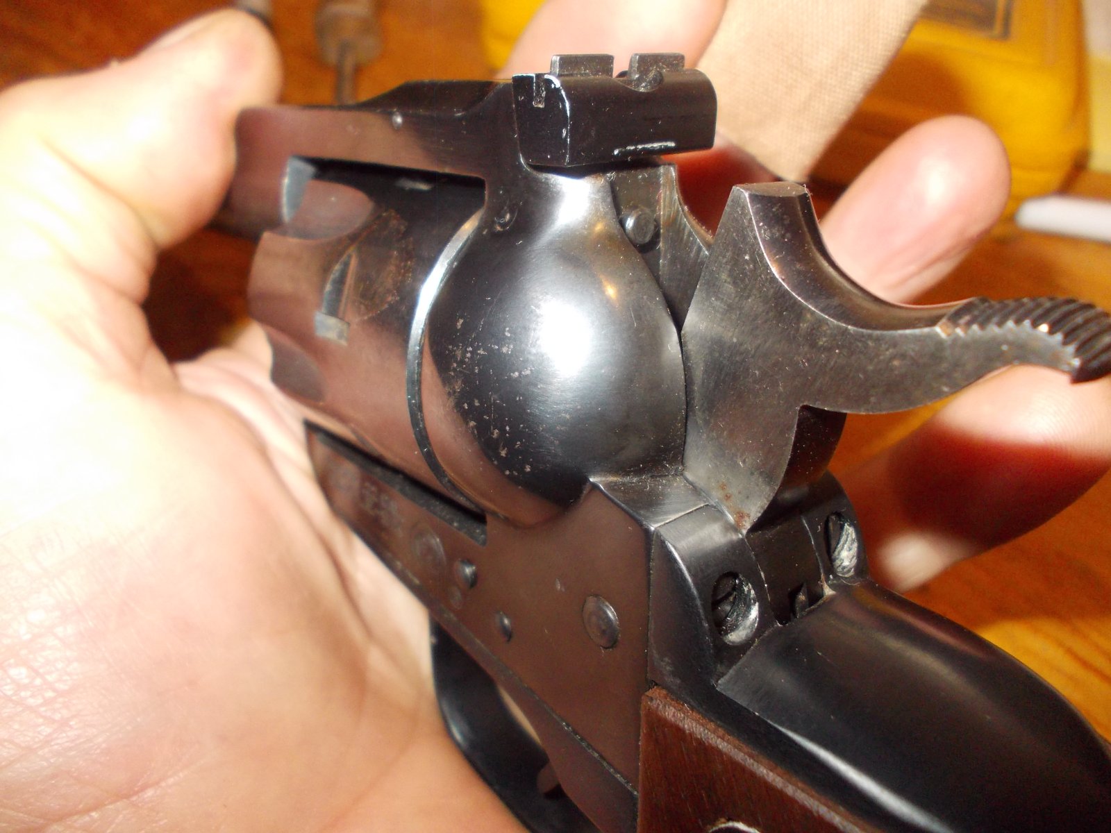

This discussion got me checking my S6's..... Here is my 3 screw flat top and you can see a hammer scar on the rear sight, at least that's what it looks like. But even if I push down on the rear sight while working the hammer I can't make them contact.

I just checked the hammer to sight gap on my old model Super Single-Six and it was 1/32" or less.
mirglip That is a old model Super Single-Six in your picture not a flat top. Unless you have had it since new maybe someone put a taller hammer (Single-Six) in it and found out it didn't work.
For the OP. Get the correct hammer, file down existing hammer, correct your sight picture, or file down existing hammer to clear sight. If all of these fail sell gun:-)
I'm thinking I'll see where the rear sight needs to be with sights regulated correctly. If that means it won't clear, I'll probably just take a little off the top of the hammer. It could be an incorrect hammer, I suppose - it had been converted, then put back "original". I got the conversion parts with it. It's a pretty nice SSS, has the box, but it will be a shooter. It's a 5.5", so I'll probably leave the .22 WMR cylinder in this one and the long rifle cylinder in its twin 4 5/8".
