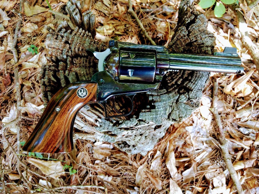

I have three Ruger revolvers that were in a house fire, but were rebuilt by a quality gunsmith and are great guns now. I think it depends on how much exposure to heat they had. None of the wood grips were burned, just slightly damaged. The guns finishes were damaged more by water than fire. The gunsmith tested the metal on each gun before he agreed to rebuild them. The Bisley in the photo is not one of the three in the house fire.

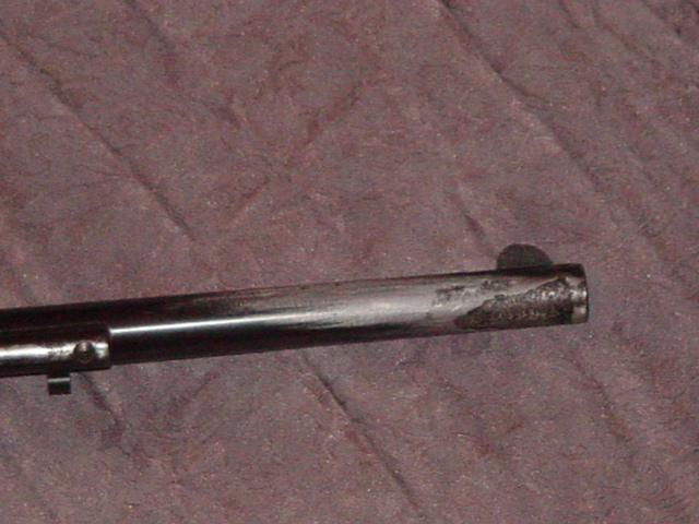

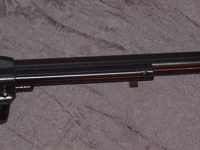

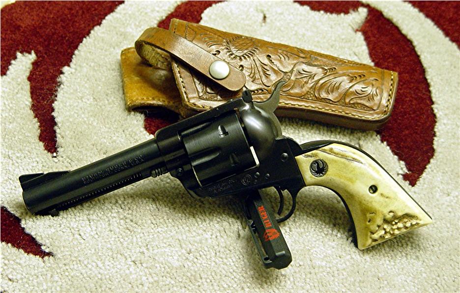

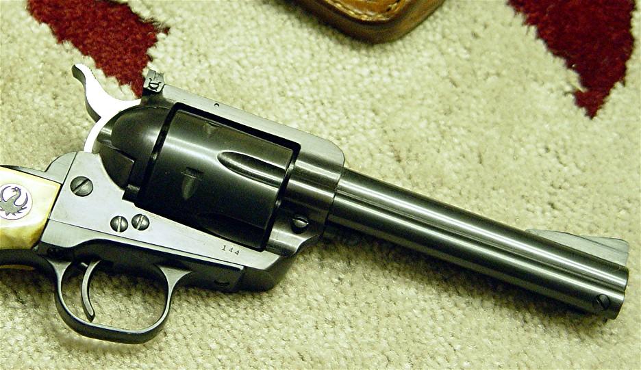

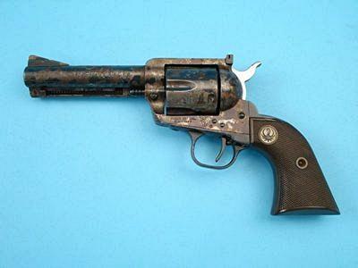

when we had our shops from the mid 70s til the mid 90s we did many guns for insurance co.s, and most all came out excellent, yes need to be inspected, evaluated, on an individual basis,,,whether in fires or out of a river, stolen ones ,recovered some time later.............one I was most proud of and was NOT an insurance job was our late friend from here on the Ruger forum, Dan Meigs, lost a 3 digit Ruger in an apartment fire, and I redid that for him ,personally.........it was burnt to a crips, melted the hard rubber ( plastic) off the frame.........
here are two pictures he took after the fire , put a new grip frame, trigger& hammer and hard rubber grips on it, then I redid it and sent it back ,he put the stags on it,,May he rest in Peace..... ;) (y)
    12 KB
    119.5 KB
    97.1 KB

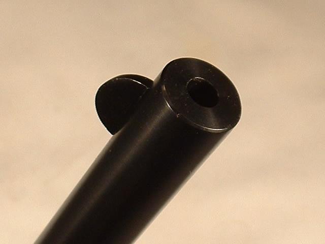

ah yes, the water left in the basement after the fire, the fire department does not lose the foundation, but time and water does its job..........;):cool:;)
    40.9 KB
    30.4 KB
    48.3 KB
    52.3 KB
