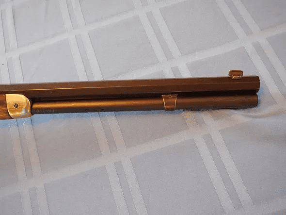

FWIW here is a 66 that I rust browned the barrel and magazine tube due to rust and scratches. I like the browned look and it holds up better than home bluing IMHO I have two muzzle loaders that I built and browned the barrels in the mid 70s and they look as good as the day I did them.
Awesome! Have you considered Plum Brown?
