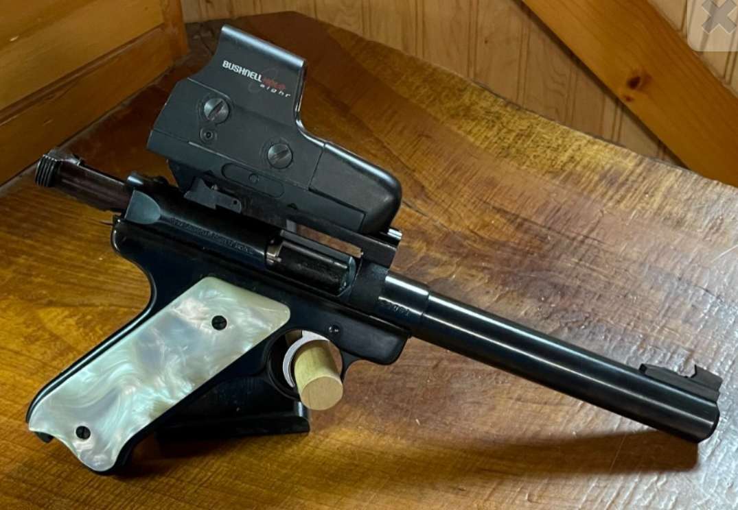

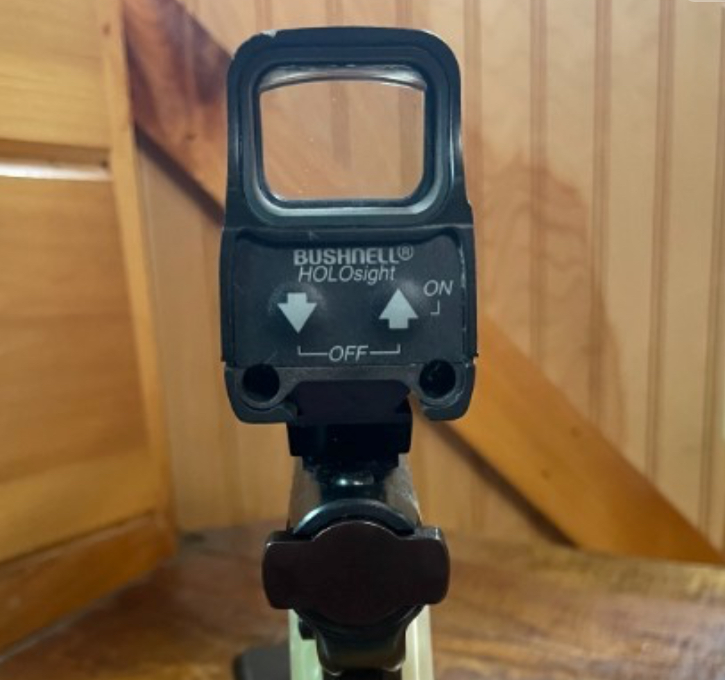

Nevertheless, I'm tempted to try out a black one on a Mark II Government Target Model I recently picked up on Gunbroker. I got it for a pretty decent price because (1) its _really_ weirdly configured, and (2) the seller listed it only as a Target model and not a GTM. It's missing the elevator for the rear sight because the previous owner fitted it with a honkin' _huge_ Bushnell Holosight (a cheapened EOTech model I'm assuming is non-functional) on a fairly ugly, discontinued Weaver 306 clamp-and-screw-down mount that anchors to the elevator screw hole. Not to mention the white pearl LS Grips, the kind General Patton famously suggested would only be "carried by a pimp in a New Orleans whorehouse":
I gotta say, though, General Patton not withstanding, the pearl grips on the blued pistol are growing on me….
If the Holosight actually works, I'll probably slap it on an AR upper or a Tippmann M4–22, and consider myself lucky.
