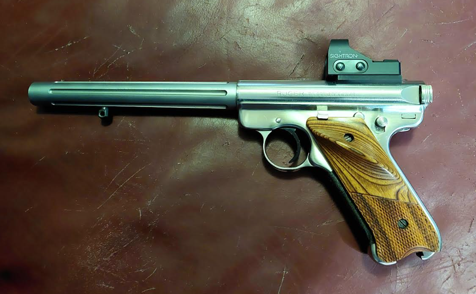

Mine was born as a 10". The swivel stud was on it when I bought it. Still all stock except the barrel bob, the RDS, and the grips.
The only thing my mk2 needed for "improvement" was a reduction in the trigger pretravel. Overtravel was fine, even though the target triggers have a screw to reduce it.
I had already installed an adjustable Volquartsen trigger in my mk3 and found that there was no need to have adjustments after it was set up right. So I chose to keep the original mk2 trigger installed and added a pin to remove the pretravel. I simply filed down the pin until I had reliable resets. This approach was less expensive, looks better, and works every bit as good as the aftermarket triggers. It was kind of fun to do also, which is cool - because I enjoy tinkering with my guns.
