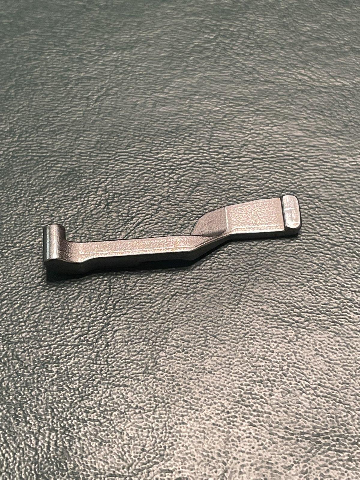

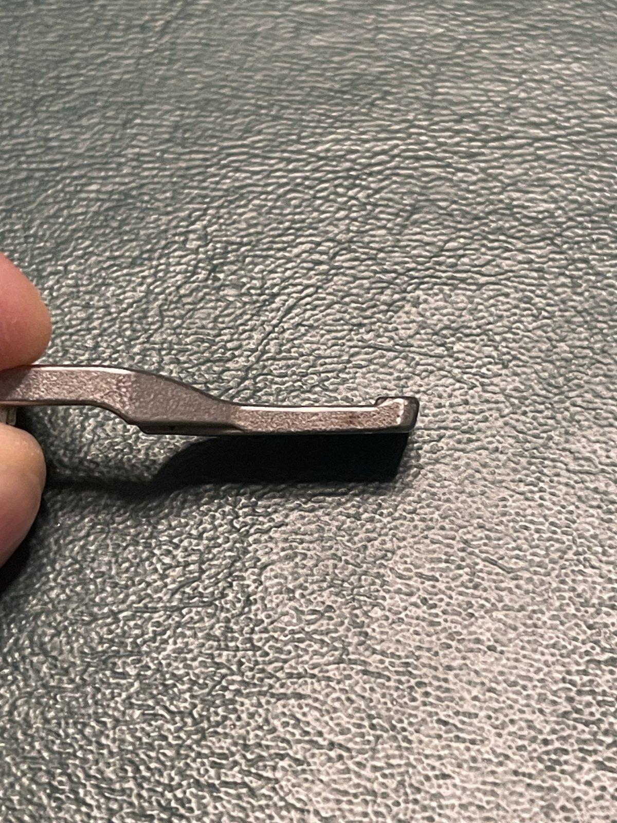

However- if it turns out it isn't an option, then from your description " there is some play in the transfer bar…". If this is with the hammer down, trigger depressed so the transfer bar is in the "up" position, I would guess the hammer nose needs to be shortened.
Ruger does have a transfer bar assembly that is thicker and compensates for what you are describing. This one came off my mid frame flat top originally. I'll attach a picture.
You can see how the end where it contacts the firing pin is thicker.

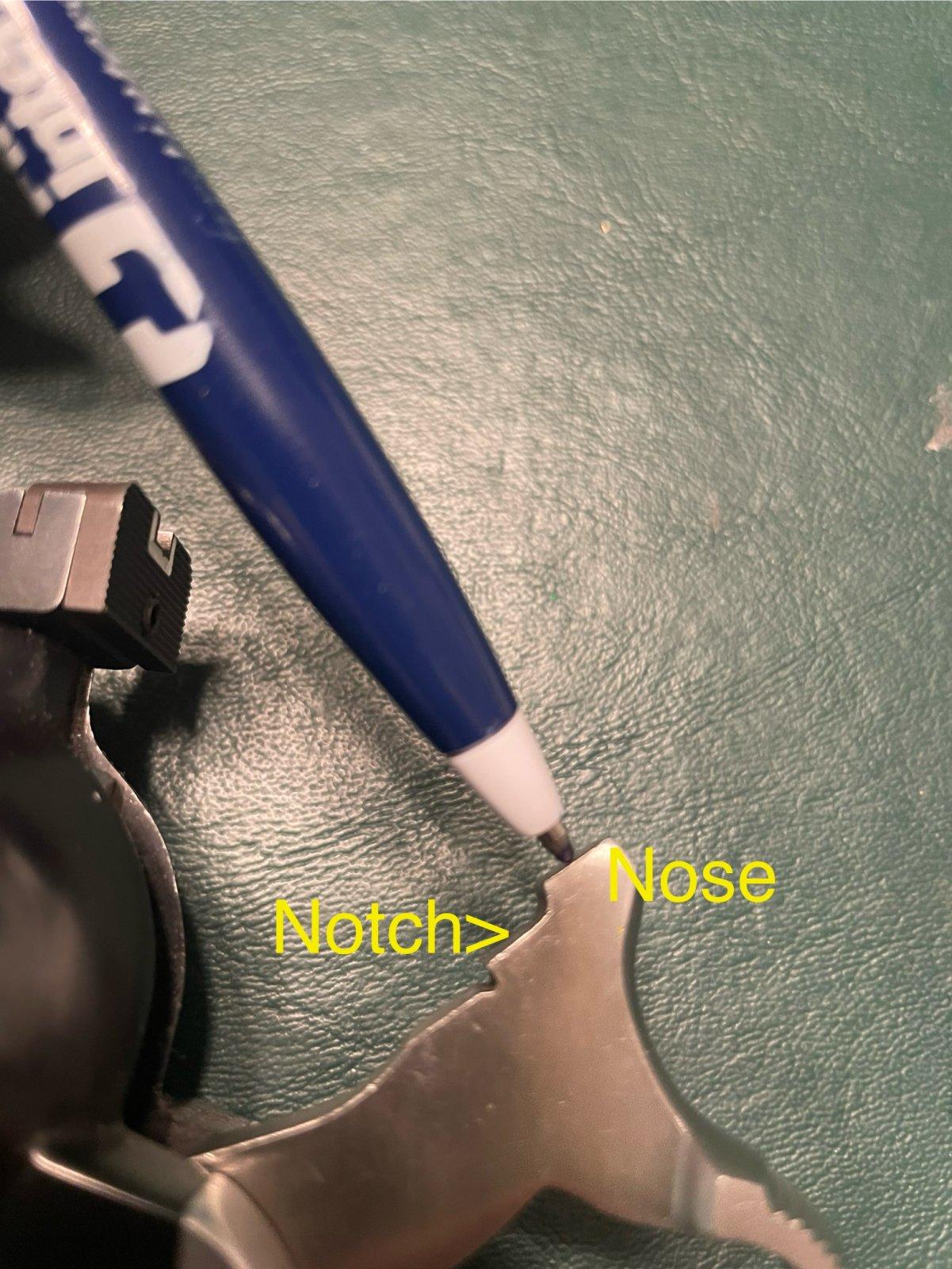

By "Hammer Nose" this is what I am referring to, indicated by the pen. Shortening this portion effectively decreases the depth of the notch below it. The transfer bar is impacted by the area of the the notch. If you have a way of measuring the thickness of the transfer bar and then the depth of the notch, if there's a big difference that might give you a clue as to what's happening.

However…going off the picture I posted before- how about taking a few thousandths off the nose of the hammer? That would accomplish the same as the masking tape, except in permanent fashion. That's what I would start with now that you have 100% identified the problem. I've had to do this before. You don't have to remove the hammer from the gun if you're careful. A few swipes of a file, test fire and repeat until you get reliable ignition.
I'd send you that thicker transfer bar I pictured but I think there's some restrictions pertaining to sending firearm parts out of the country.
