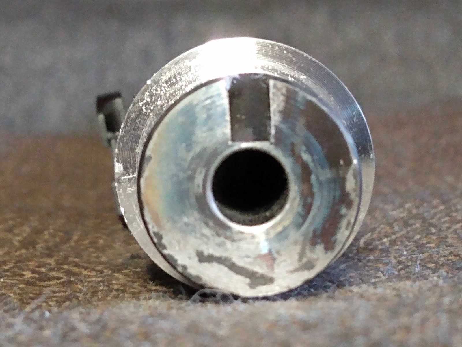

I am deeply disappointed with this rifle, the bolt hangs half way into battery about 25% of the time and I cannot manually extract an un-fired shell from the chamber.

The first thing I noticed was the extractor could not even get a hold of the shell because the relief cut in the barrel for the extractor was not deep enough for the extractor to get behind the shell.
So I decided to remove the barrel and the two screws holding the barrel in were only FINGER TIGHT, and the barrel is a rather loose fit into the receiver.
Then after removing the barrel I can see the extractor cut in the barrel is not even true to the bore, what a POS this thing is.

After this I will try to figure out what the bolt is hanging on, if you slowly close the bolt it will actually hang and stop on the extractor but that is not what is stopping the bolt halfway into battery.
I sure hope this thing will be accurate enough to hit a rabbit after all of this, I would be surprised though.
No, I have no confidence in the factory, and I just have a "thing" about re-qualifying to receive a rifle that I already qualified to purchase to begin with, I am sure that was the idea of "handlers" of the last POTUS.
I could file out the cut until it worked but I decided to purchase a new aftermarket barrel, when I get that properly fitted I will tackle the bolt seizing issue.

I am a machinist and amateur gunsmith, I have built a few 1911s from un-fitted frames and slides (Caspian) along with many other firearm projects and I can guarantee I could have made that cut more accurately than the factory did, I also could make that barrel work but my OCD and the opportunity to upgrade the barrel have me going in another direction, also I doubt they would replace the barrel just grind enough clearance for the extractor to work, not what I would want from a barrel that was improperly machined to begin with.
The big issue to me is that that 10-22 would not pass a simple function test so how in the world did it get out of the factory?

A friend of mine had a B. C. bull barrel he never installed so he gave it to me and it solved 95% of the issues, it will manually eject now and the extractor no longer hangs on the barrel. out of 4, 10rd mags it did stove pipe twice, but other than that it never failed to chamber the next round.
