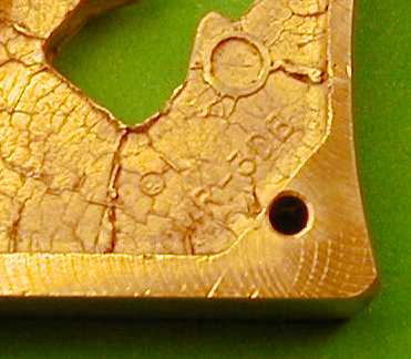

MR-3DB bottom Right on a really clean pristine frame.
Very typical porosity on the Ruger frames. This one is from a "lettered" SBH.

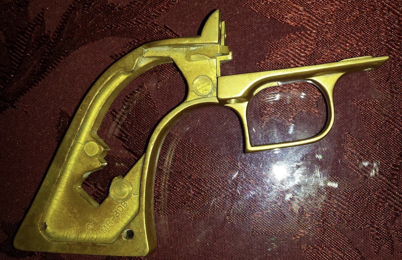

Sadly,, as it's been posted above, there are no verifiable records known to the MANY collectors here about any New Models leaving the Ruger factory with a Ruger factory brass g/f, marked with MR-3DB. And as noted, the trigger return spring on an Old Model,, (the MR-3DB) is very different than the New Model types. There have been a few custom fittings of OM grip frames to a New Model, but it takes a lot of work.
On an original MR-3DB,, the frame has more material behind the trigger guard, and a hole in it to allow the return spring & plunger to fit into.
A NM g/f has a milled out slot,, to allow the coil spring & it's "legs" to go rearward, and the legs hook onto a post.
Basically, two totally different designs.
As noted,, if you truly believe you have a factory built NM with a factory installed MR-3DB,, it will require a letter from Ruger to verify it. And as such,, it'll become the first & only one known.

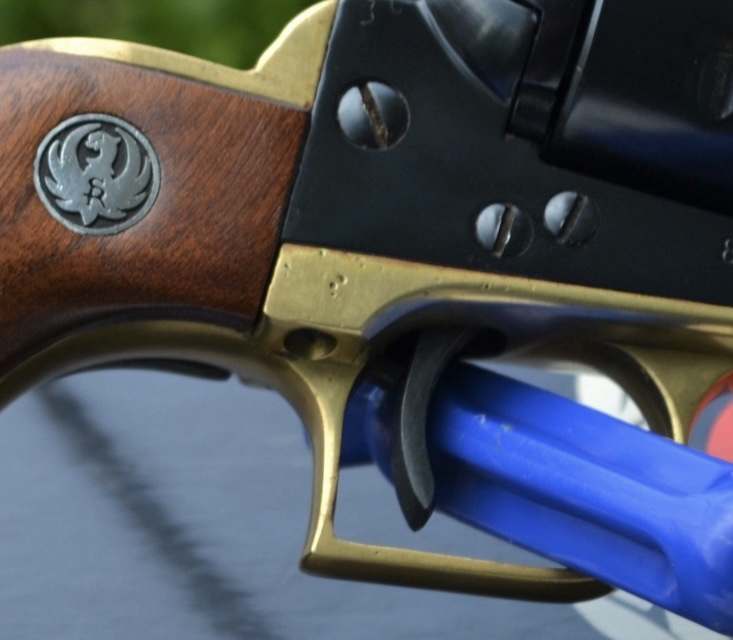

It has the. MR-3DRngrip frame on it and it appears to be factory. Perfect fit

I have the gun with the MR-3DR grip on it - through research and the serial number there is a possibility of that grip going out on that gun. I have pics and can't find any reason it isn't genuine - Ruger themselves say it might be original - trying to get a letter of authenticity from them. Even without letter it is possibilility. The grip frame fits perfect.
