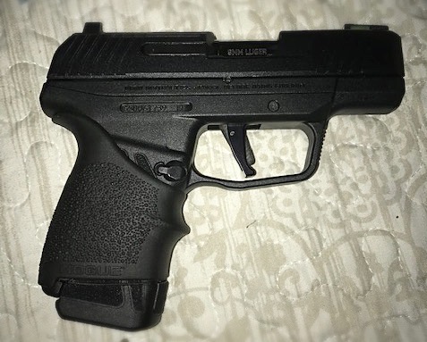

I did install one on mine, and it's a definite improvement. It does reduce the pre-travel a bit as well as improving the overall appearance. I too am a fan of flat faced triggers and install them whenever it's doable.

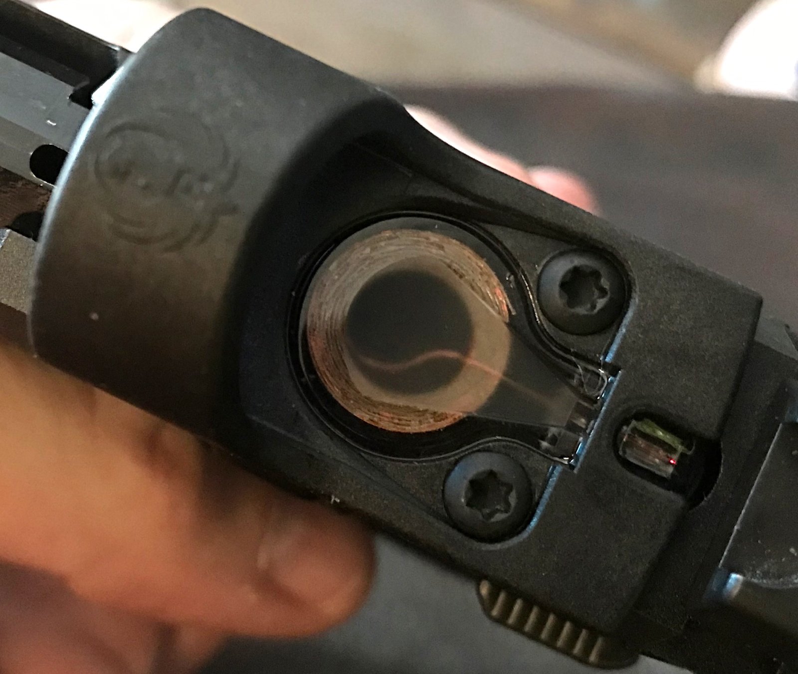

The Dot is the Ruger ReadyDot. No windage or elevation adjustments and no battery. Made specifically for the Max 9 to co-witness with the fixed sites.
From Ruger : “The fiber illuminated reticle adjusts to varying light conditions and has been specifically designed for battery-less operation at typical concealed carry pistol ranges”

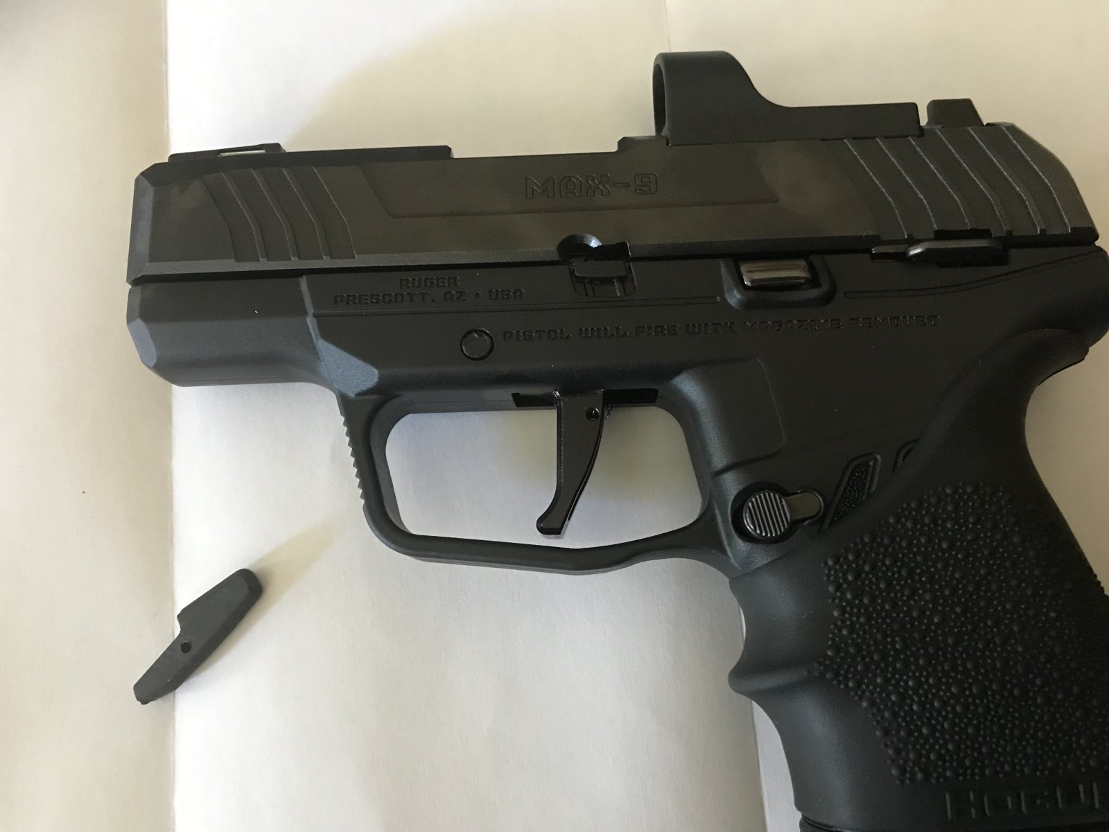

the new trigger broke 🫨…. The little Glock safety blade thing fell out. Pics Below. Contacted the Mfg when I got home via email. Got back to me in less than an hour and shipped me a new one that day. the Little pin holding it in came out. He didn’t know why but several other customers have had a similar issue so they have changed how they set that pin. they were never able to recreate it. No biggie, their response was swift and acceptable, so no hard feelings. Even with the stupid blade safety it works much better than the stock trigger. It’s an easy install, so no big deal.

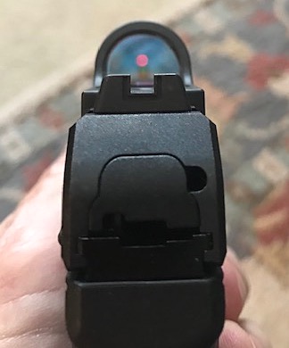

The Ruger Readydot worked just dandy. It’s not real bright in the lane but the dot was bright. because it has neither an elevation or windage adjustment available I was suspicious. When I dint shoot like a moron, it was POA…. Very cool. I also need more work with it.

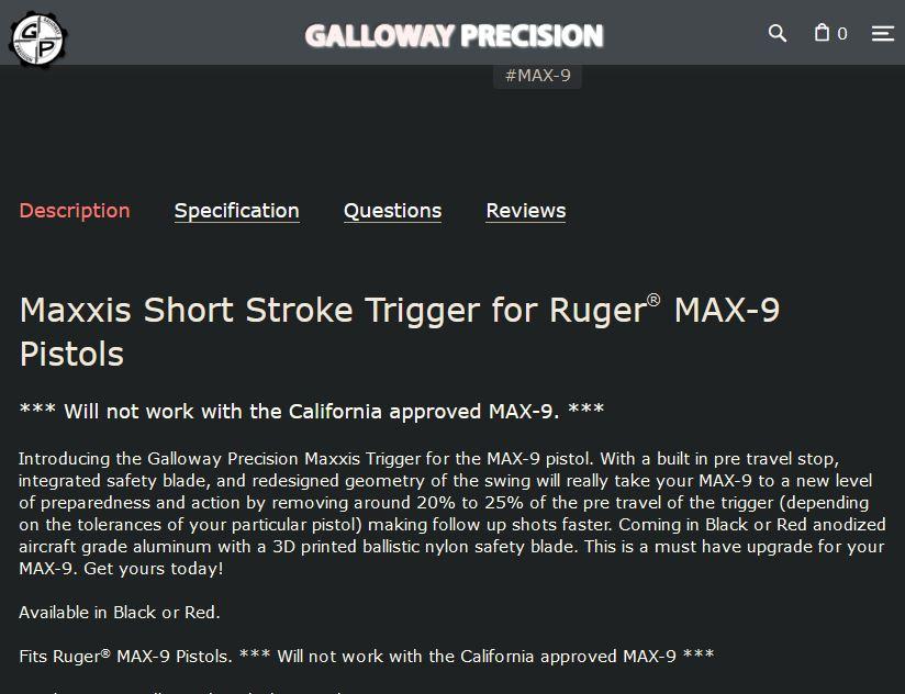

Just got a Max9 and had to immediately replace the sloppy & wobbly stock trigger.
Much better now that Installed the Maxxis trigger kit from Galloway.
Word of caution:
1.) the Maxxis trigger will NOT reset properly on the Max9-CA model unless you remove the magazine safety!
2.) the safety spring is prone to flying off so be really careful to cover it with your finger so you don't lose it... also it's a bear to reinstall.
FYI, Galloway recently revised their description on Maxxis trigger kit for the Max9.
They now state their trigger will NOT reset on the Max9-CA pistol unless you REMOVE the magazine disconnect.
