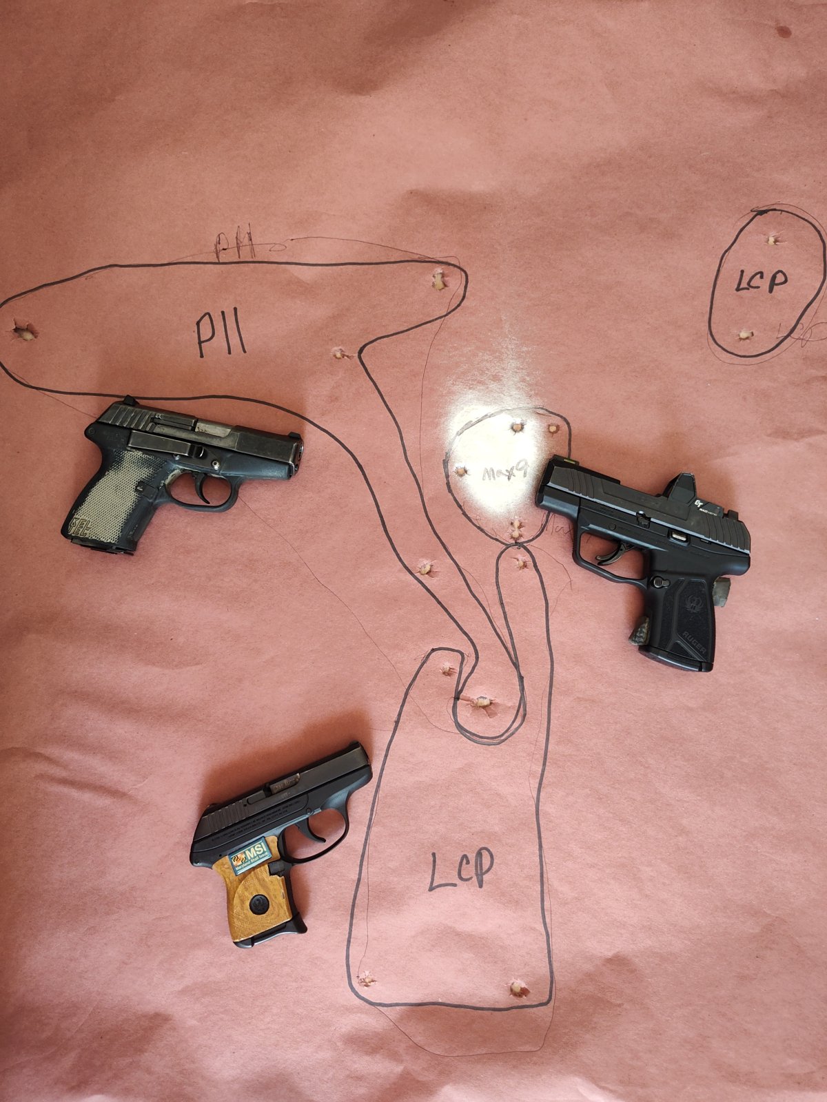

BTW, I've put nearly 300 rounds through my Max 9. I don't have a lot of experience (licensed, shooting for 3 months) and only one other 9mm to compare this to. This pistol seems to be a reliable, "good" shooter. This was Tuesday at 10 yards.
