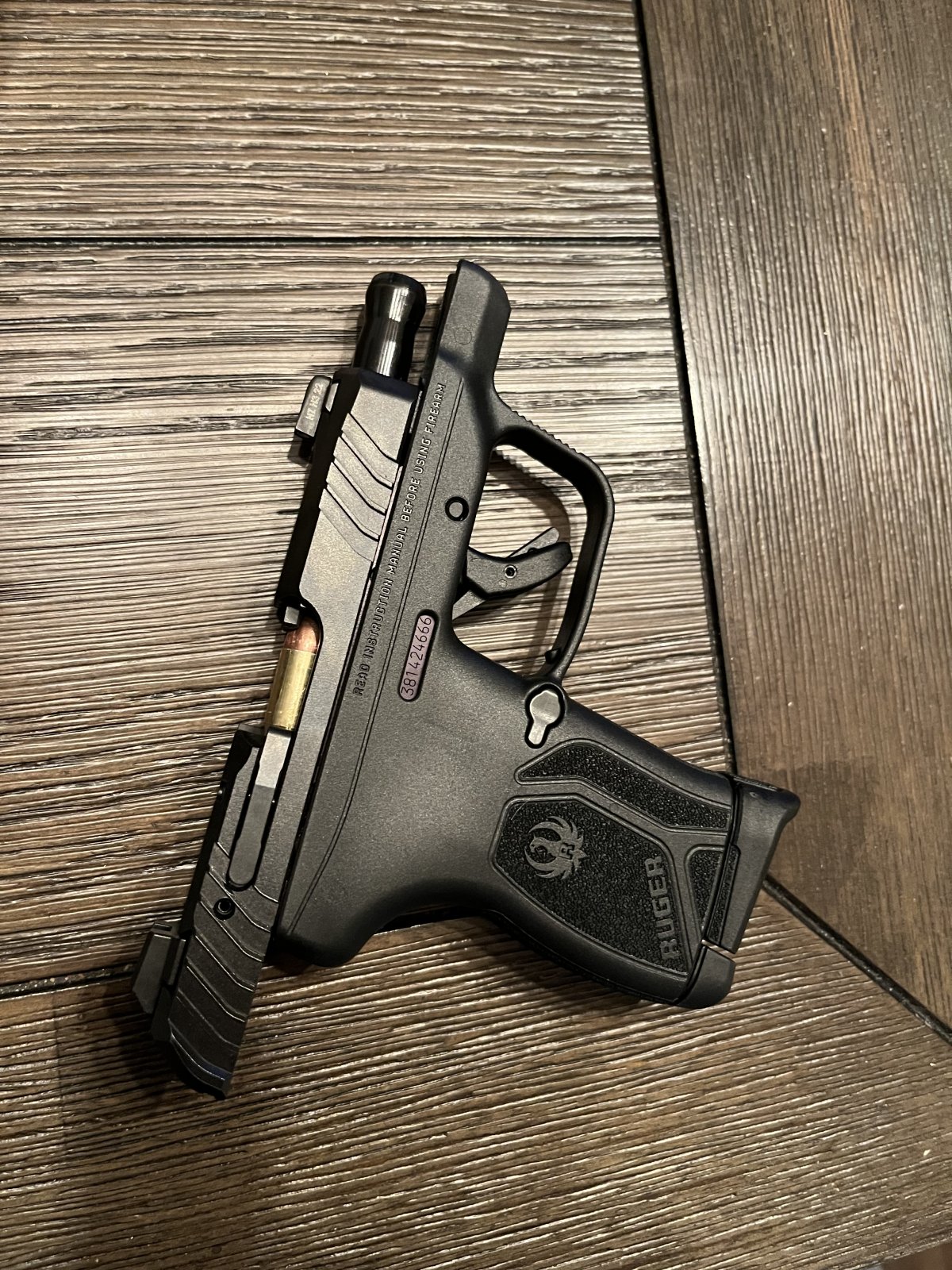

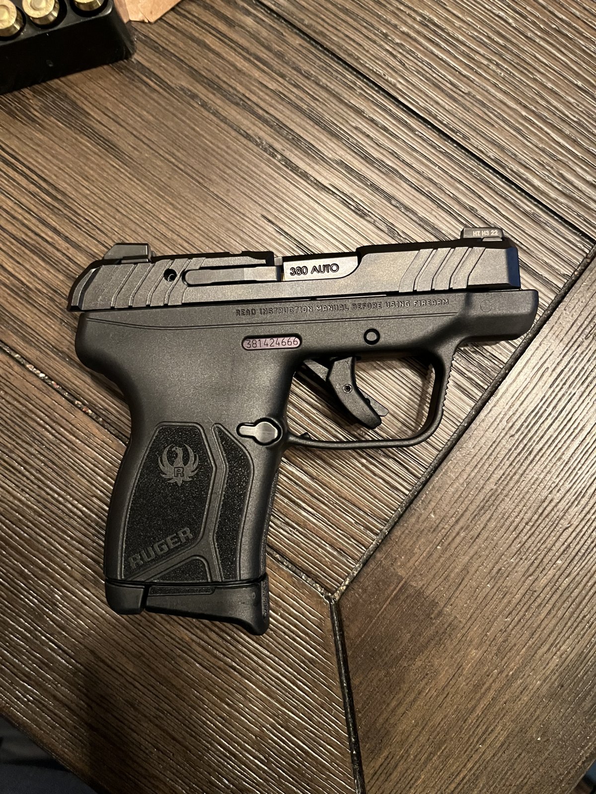

I’ve had guns break in before but nothing like this. I think there is a defect with the barrel that’s making it stick, but I am no gunsmith. I have heard of polishing the feed ramp and I have a little polishing tool so I may try that but I have also emailed Ruger so I guess we’ll see what happens.
I want to like this gun, when it did shoot it was a blast and I was very accurate up to 75 feet with it so it would be a great carry. I’ll attach pictures of the two most common issues. Any input or suggestions would be much appreciated, this is my first Ruger!

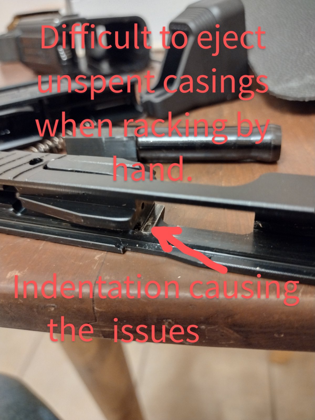

Purchased an LCP Max yesterday. Never fired it yet but found the same issue. Noticed a build up of brass shavings on the slide, cleaned it off, and found a manufacturing defect. There's an indentation on the slide that grabs the rim of the casing and causes the ejection issues when racking by hand. Not being able to clear malfunctions using the Tap, Rack, Bang technique is unacceptable. Notified Ruger via their website and got an email response the next afternoon saying to call in to support for an RMA number. Was quickly emailed a prepaid return label and it's going back today.

I believe the indentation shown above is the ejection problem. Mine collected brass particles at that place. I called Ruger (great CS)
They sent me a new barrel, slide and spring. Installed them yesterday and I now have the gun I wanted. Manually ejected 10 unfired rounds without a hitch. If the indentation is in the new slide, I can't see it. No brass particles and the first mag put 10 in a 1 3/4 group in the Bullseye @ 7yds. Me happy.

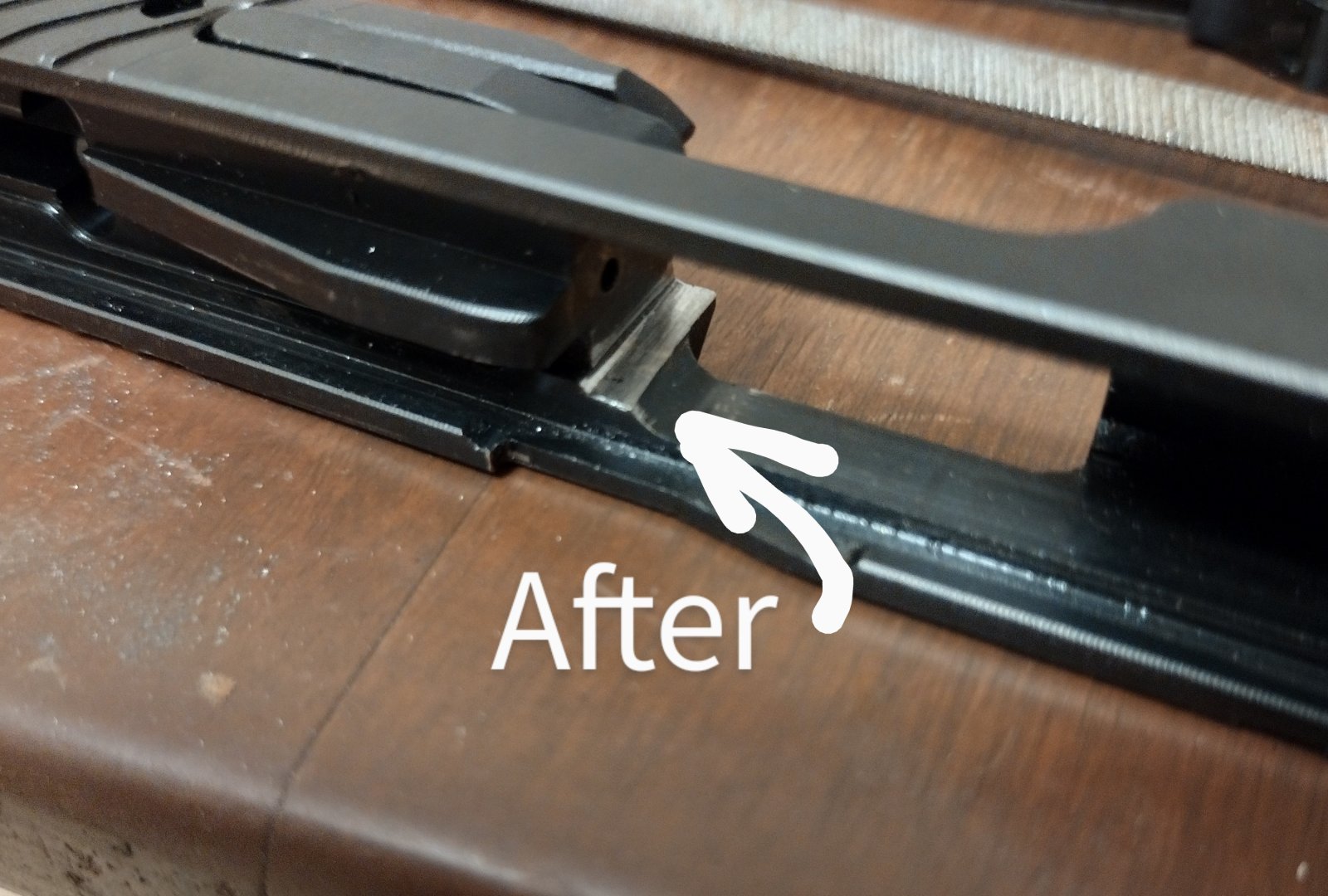

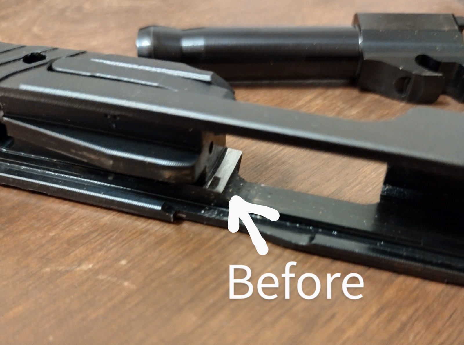

I decided to file down the area until the indentation was no longer visible. That fixed it. It is no longer difficult to eject unspent casings when racking the slide by hand. I can now do the "tap, rack, bang technique" to clear malfunctions. I can eject all 10 rounds quickly and easily by hand. I will still ask Ruger to send me a new slide because the protective coating is now gone and the metal removed might be important. Cheers!
