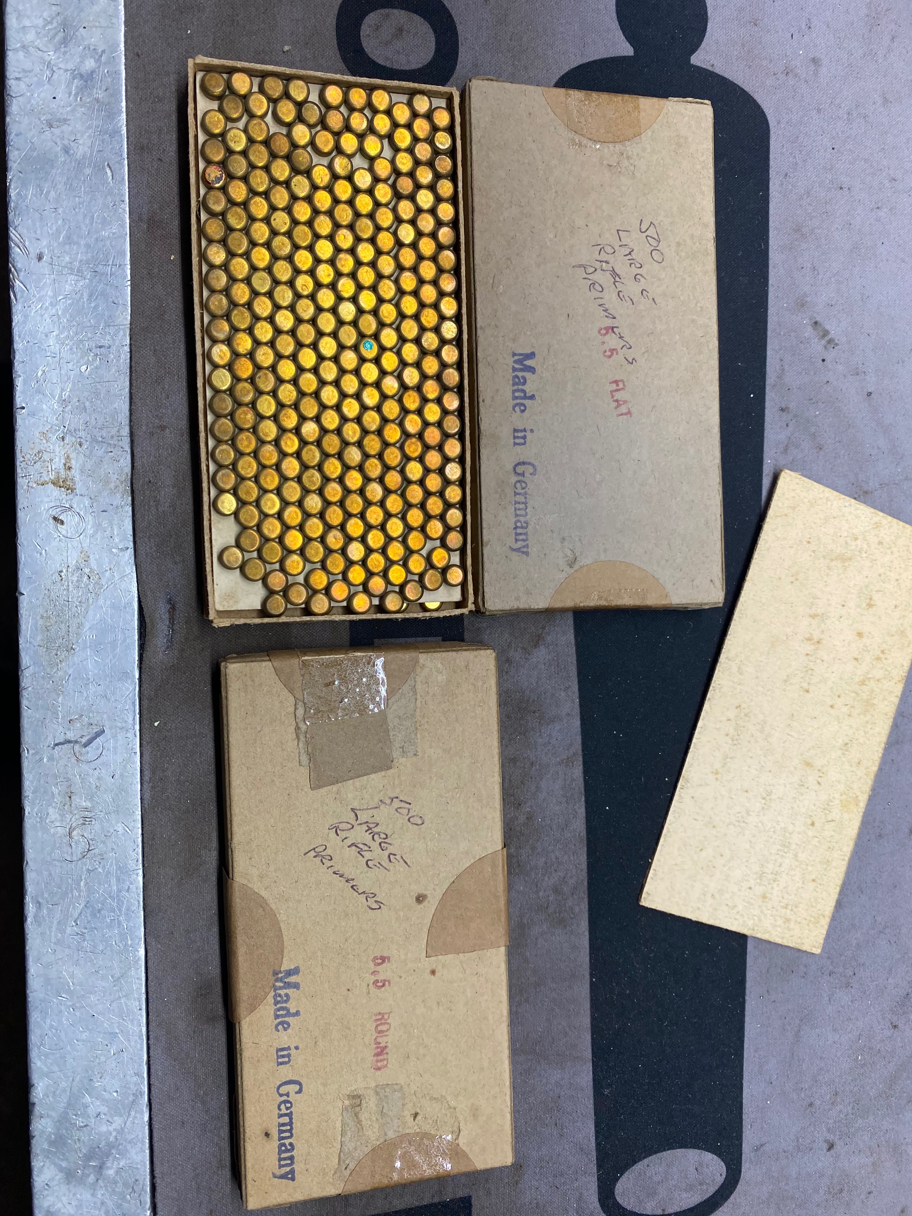

Anybody know anything about these primers? Found them at an antique shop. One box of flat and one box of round. Would they be ok to use? Made in Germany.

Not knowing the "power level", standard, magnum, etc, not sure how we would know what they could safely be used in 🤷‍♂️
That’s what I’m worried about. Would like to use them in my 45-70 but don’t want to create problems I don’t need. Hate to pitch them but……
I will agree with s4s4u. It is not worth the gamble. They are likely corrosive if they are as old as you think. Corrosive is not the end of the world but a pain to make sure your firearm is completely scoured clean of the residue. .
I've messed with old primers a lot. They would be fine to use. Not unsafe at all, especially in 45-70 as it's a low pressure round. The problems would be , brittle skirts and gas leakage, duds, and the era they seem to be pretty good chance of corrosive. So based on actually owning and using similar over the years they are junk.
Shoot a primer only onto a piece of clean, degreased mild steel and wait a week to see if they're corrosive. If not, load a few with starting powder loads and go from there. I'd likely shoot them up even if they're corrosive, just use an ammonia based cleaner to swab the bore after shooting. I've fired thousands of old surplus rounds with corrosive primers with no ill effects.
May load a couple of really light loads just to try. As far as being corrosive I clean after every shooting session and I shoot a lot of black powder. Won’t load a lot of them. Don’t like breaking down loads to reprime. Don’t have any ammo collectors around here. If anybody on the forum would be interested in them let me know. Thanks for the advice.

As has been said: Determine if they are Boxer or Berdan. I have loaded Berdan in 7X57 and 8X57, but is a hassle and requires a Berdan decappiing tool.

I wouldn't touch them, stored under unknown and likely conditions that a primer shouldn't have been in. Take a pass on them. Not worth the possible, likely? problems.

I still would not waste anytime finding out if they will fire, fit or work up a load for a limited amount of primers that you likely will never see again. But that's me not you. Do what you want. Yep, I work up loads for all my rifles but using a component of know limited quantity, unknown age and storage. No thanks. Post how they work if you use them.
It is very likely that you have stumbled onto some Berdan primers. If so, they will most likely be corrosive and are designed for a case with two flash holes. I don’t know if they will work well in the boxer primed cases or at all. I understand that Berdan primed cases are difficult to reload and are probably difficult to find in the U.S.

I would NOT use unknown primers of any type. You could get “hang fires,” or, “misfires.” Both very dangerous.
