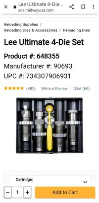

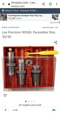

I will try to stop being such a pest.I will post a pic of these dies for my 30/30
Are these what I want? I believe they are carbide dies
Here's two sets I'm thinking thec4 die set is what want
Yes ,No

I have the red Lee set and they work well enough for me. It comes with the Lee Factory Crimp Die that I like for putting a good, firm crimp on the round since they're for my tube-fed Marlin 336.
Edited to add:
I don't think you'll need the 4-die set, as the 4th die is for if you want to only neck-size your brass after you've fired it in your rifle. Not suggested if you're loading for multiple rifles.
