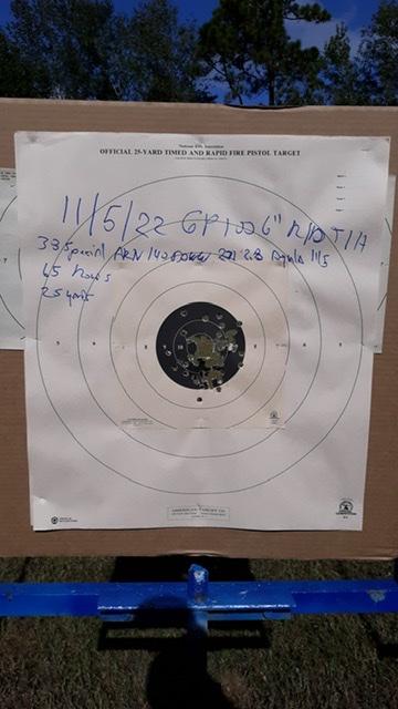

I have a 6" GP with probably close to 50,000 rounds through it, and only a couple hundred of those have been jacketed. Seriously. Weekly PPC matches plus practice for several years really racks up the round count!
In all honesty, the only time it has leaded was using commercial hard cast bevel-base bullets with "crayon" lube. My hand cast RNFPs are fairly soft, have a flat base, and wear soft lube. I've run them a little undersized or oversized, and they don't lead even at magnum velocities. My rule of thumb is that I should be able to easily groove the bullet with a fingernail, and I have found some commercial bullets that claim to be "hard" but meet my standards. The only issue is that if they are bevel-based, they still tend to leave some deposits that I don't get with flat base designs.
Caveat: I shoot 160-180 grain bullets, and I can't vouch for lighter slugs.
