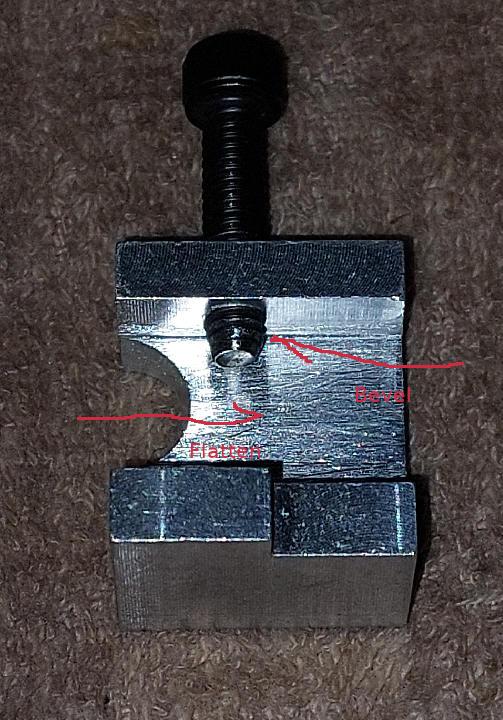

"Technical" review of the Midway gate spring depressing tool / clamp :) .
Summary... Not good.
Problem(s):
1. The cutout / channel that allows the clamp to press into the side of the frame is machined too shallow, and ridges inside made it sit NOT flat against the frame.
2. The screw that depresses the gate spring will engage the frame NOT the spring
Solution(s):
1. Painstakingly file the clamp cutout / channel flat so the tool would lie straight and closer to the frame. A big PITA without an end mill.
2. Bevel the screw tip to make sure it cleared the frame.
After 45 minutes of diddling it actually worked pretty good, likely how the designer planned it to work, but failed. I could have sent it back but that's an even bigger pain than handling it here.
Recommendation:
Buy another brand :-)
Seriously, this tool must have been made on a Harbor Freight grade of milling machine, or had zero inspection of the machined part, or the cutting tool was bad, or just bad setup / drawings.

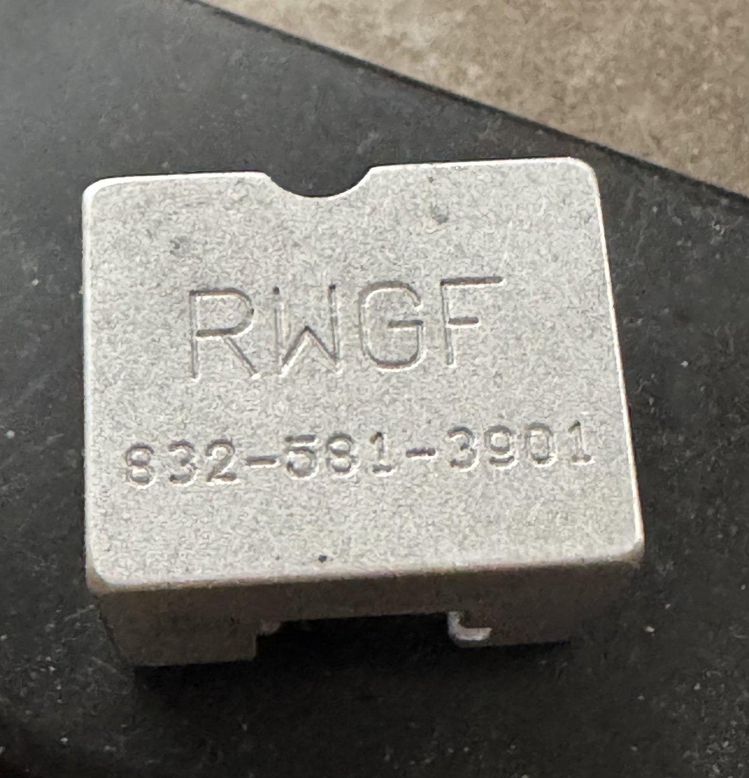

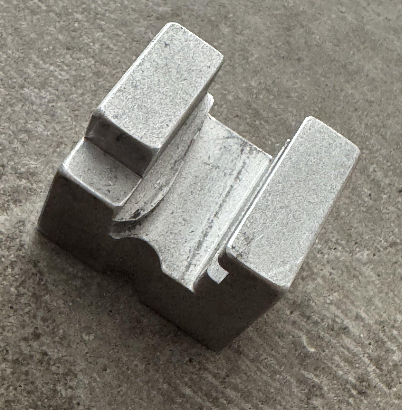

I chuckled when I saw you ordered / reviewed the clamp from Midway, total waste of money and it leaves evidence behind!!!
I have one of Ronnie's tools, it's fool proof and works, NO SCREWS leaving marks.
My suggestion is mail Ronnie a check for $25 and get yourself one. ESPECIALLY if you're going to be in & out of new model guns. A must have for a new model Ruger Enthusiast. A lot of ACCURATE measurements milled into that little chunk of aluminum!
