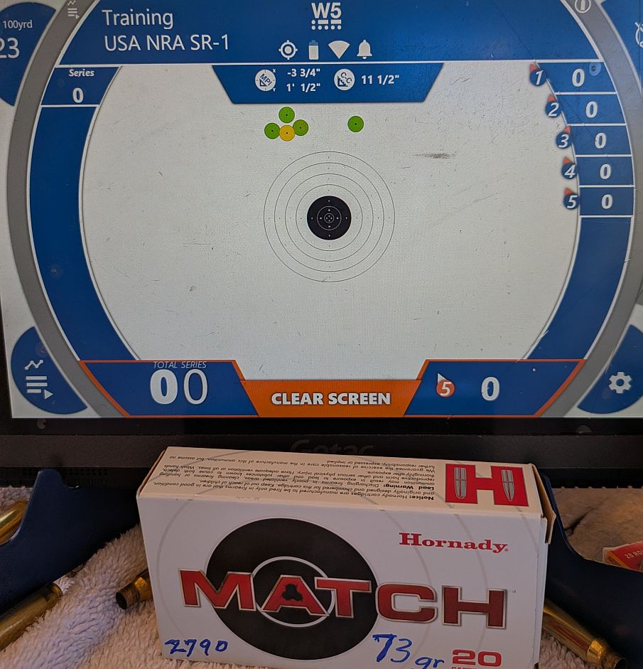

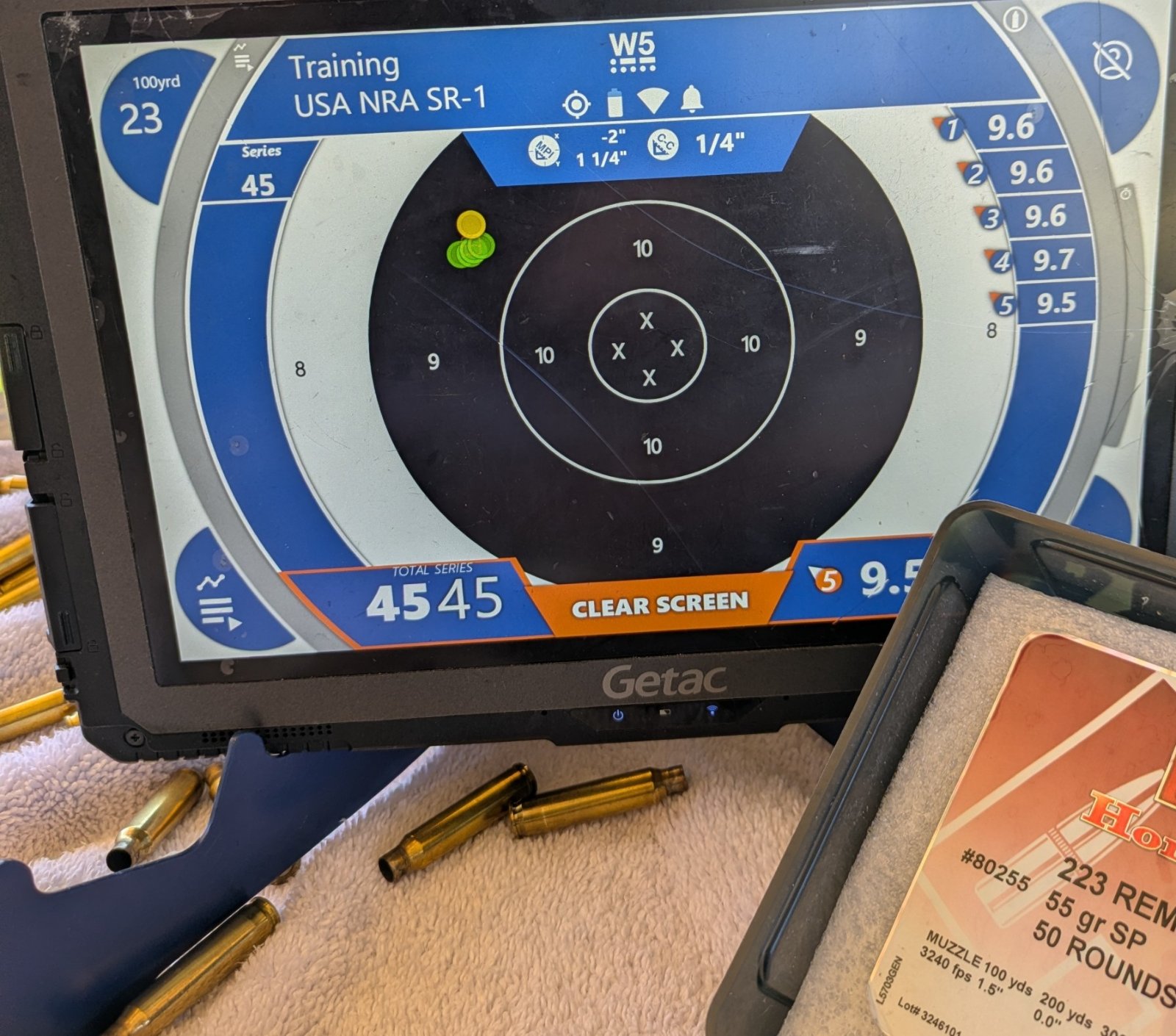

Trying to find factory Ammo my Generation II Predator, .223 will like yesterday and it was surprising. My best group was 1/4 inch with Hornady # 80255, worst was frontier at 13 inches. The gun did not like Hornady 73gr Match, Sig Sauer Marksman 77 gr or anything above 55 gr

Well I did luck out with this 223 Generation II Predator, after testing 28 different factory ammo these are the ones the gun likes best.
Hornady # 80255 SP 1/4 inch to 1 and 1/2 inch$0.60 per round
