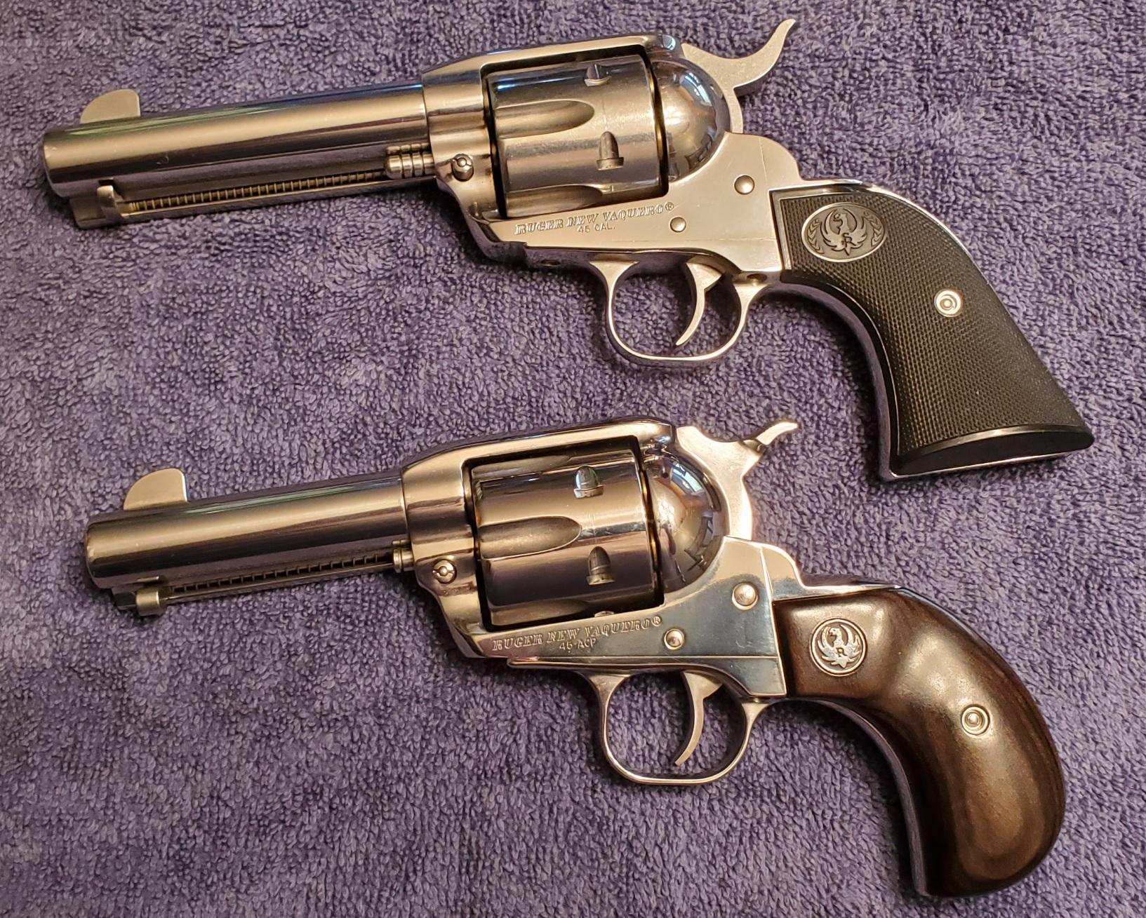

I bought the 45 long colt quite a while ago and later got the 45acp birdshead. I was shooting the birdshead one day and thought I would see it the cylinders would interchange. To my delight they did, the headspace was right on and the timing also right on. So now I can shoot either cartridge out of either revolver. I prefer the 45acp as the shells are more available and cheaper.

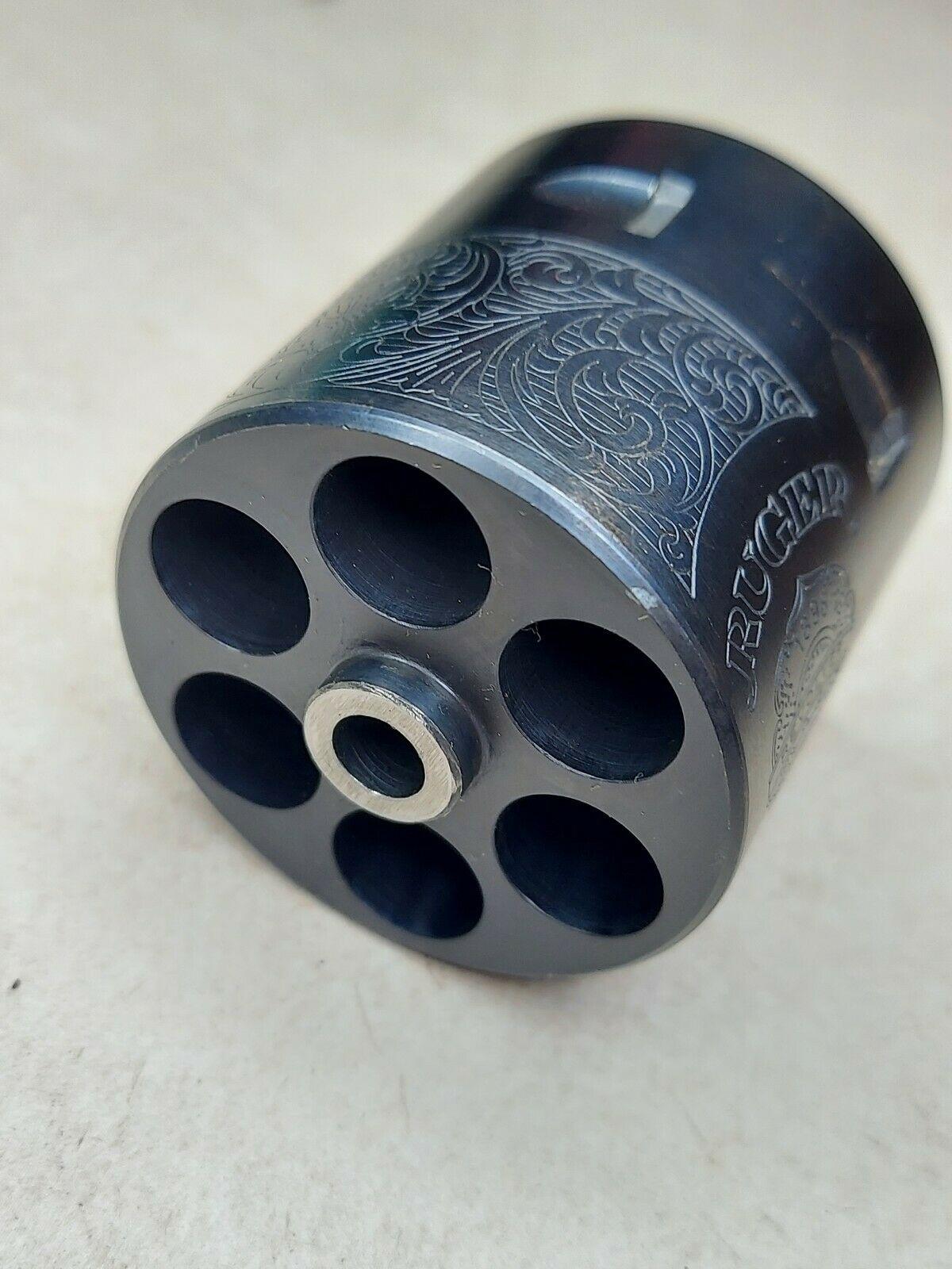

Actually I won't need to do that in this case. The 45acp cylinder has the last 3 digits of the serial number stamped on the end where the bullets exit. The 45 long colt does not.

I bought the 45 long colt quite a while ago and later got the 45acp birdshead. I was shooting the birdshead one day and thought I would see it the cylinders would interchange. To my delight they did, the headspace was right on and the timing also right on. So now I can shoot either cartridge out of either revolver. I prefer the 45acp as the shells are more available and cheaper. View attachment 814
Now that's pretty cool, congrats!
