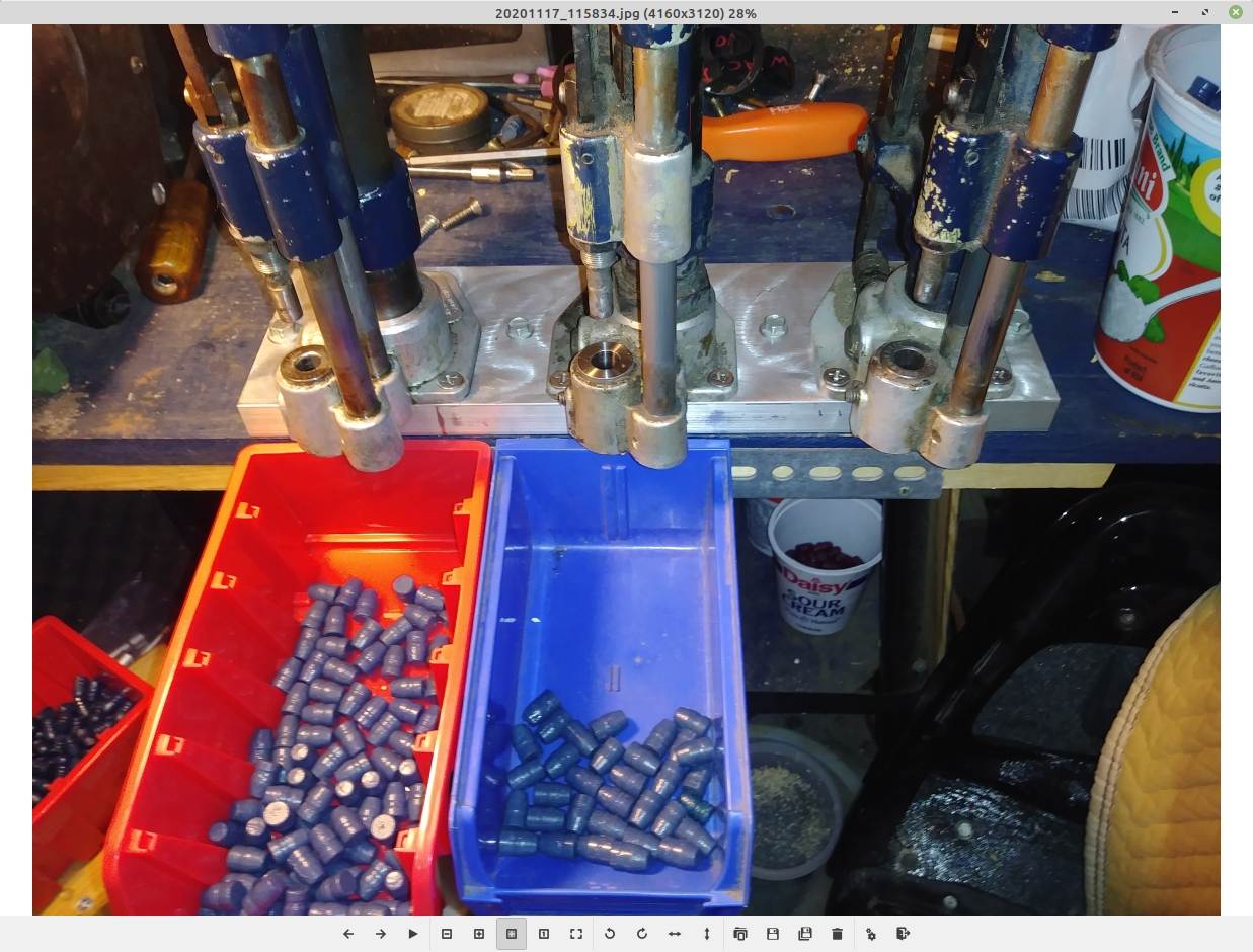

All of the above PLUS I don't have to use the messy, gooey lube that needs to be heated in my sizers
Gee,, you have (3) Star sizers there. NICE!
I'm lazy and back when I used wax based lubes even with a heated base I had to heat up the die to pound it out. So when I found a sizer at a palatable price I bought it. When I went exclusively to powder coatings I did not need to have them spread apart so far and I genned up a drawing and had a machinist make the mounting plate for me.
I never had to pound out lubed or coated bullets. I used a slightly smaller diameter bullet to push out the bullet at the end of a session. And,, I have a 1" long, 1/4" diameter rod piece I use for the same purpose. Otherwise,, the next bullet in the sizer pushes out the previous one nicely.
I was talking about getting the DIE out of the Star not a stuck bullet, sorry I may not have been clear.
Ah, softer lube I was OK with but the stuff I used was hard as chalk. I may still have some around if you want it PM me.
