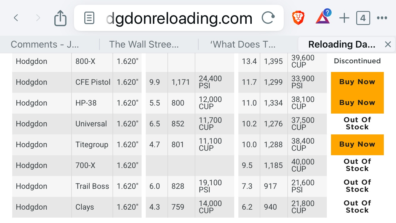

I recently loaded a bunch of 5 grains of titegroup with hi-tek 240 grain Missouri bullets for "magnum" loads. These are advertised as 18 brinell.
I see that MB offers 12 brinell bullets for "cowboy" loads.
I kinda liked the lower pressure loads.
Is it worth getting a box of the 12 brinell bullets for titegroup?
    179.6 KB
