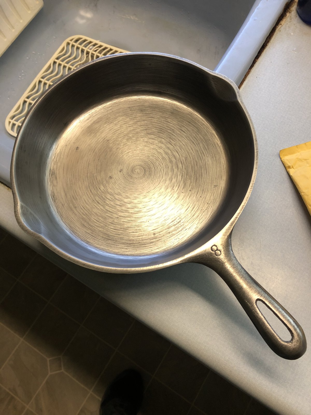

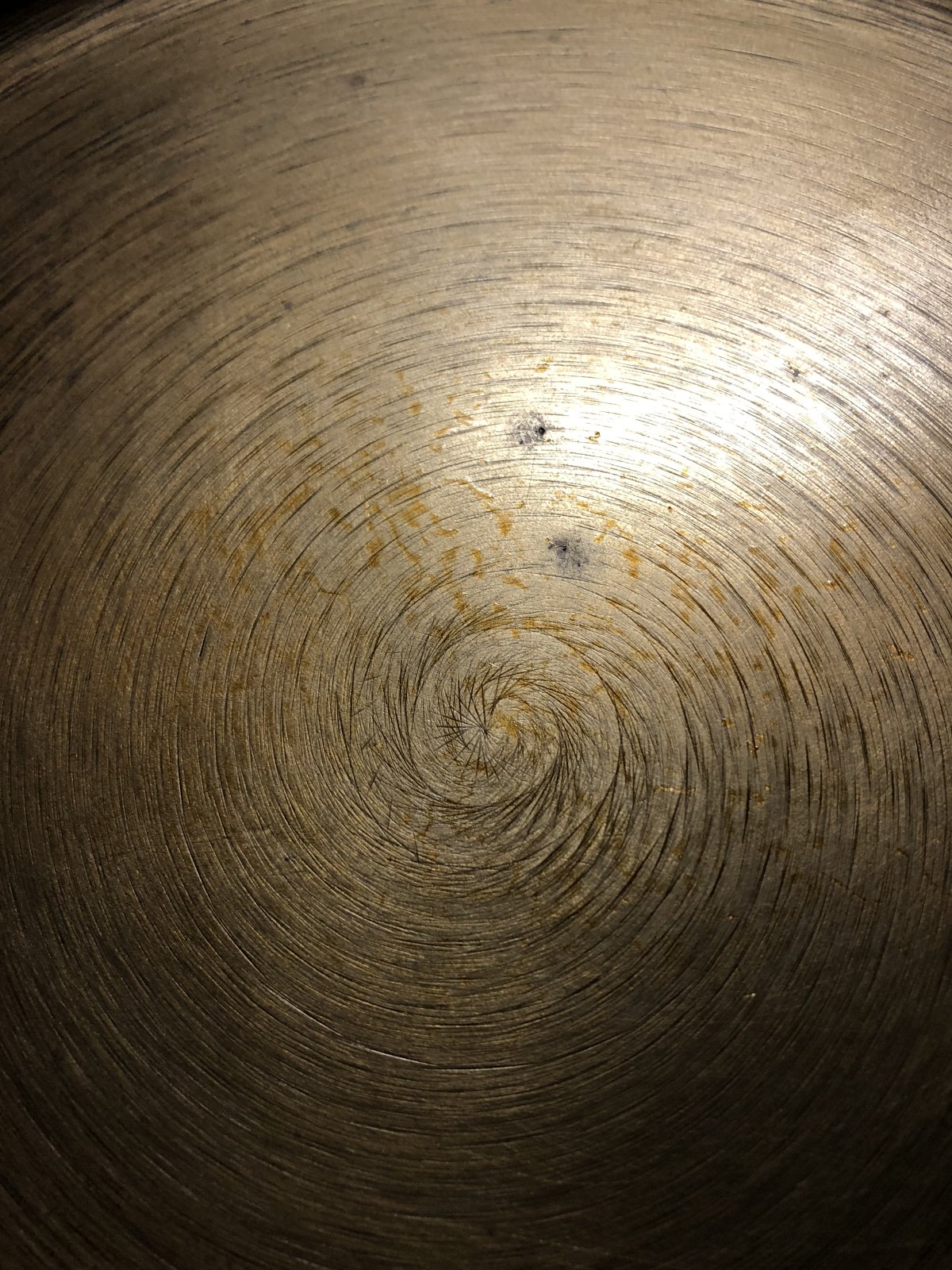

Don't have a before shot. Thought I did but nope. Anyway, Sanded it up and wire wheeled it some then polished a bit with scotch brite. Wasn't bad to begin with but did have a couple rust spots. So now what? Looking for best option for a beginner. Easy to do and understand please. And yes I could google but thought maybe there would be an expert on here to help out.

You did a good job cleaning it up. Now to do a good seasoning. Use either of the above videos (or better yet watch both). One hint, when you're done using it, wash it with hot water only! No soap. Then while it is hot, put some vegetable oil in it and use a paper towel to rub the oil all around. Let it sit for a bit, wipe out the excess oil and put it away for the next time.

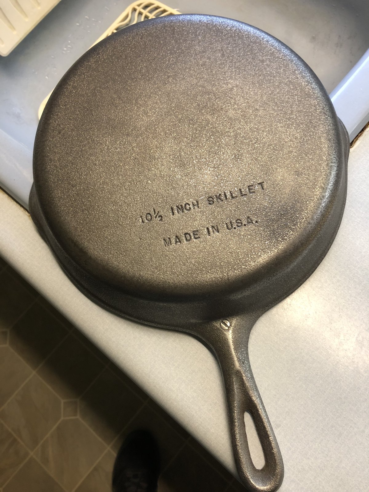

That looks fairly deep. If it is, it is a "chicken fryer." I believe that is an "unmarked Wagner".
To season mine, I used canola oil because that's what I have. Rub a thin coat of oil on it, very thin, and put into a 350 F oven for about an hour. Repeat. Repeat. If the oil is sticky, leave it in the oven for a longer time.
I use my chicken fryer for everything. Chili. Pasta sauce. Stew. I usually make cornbread in a smaller skillet. I make a baked tuna dish that goes into a cast iron skillet.
I clean it with hot water and a plastic mesh scrubbie. Detergent won't hurt it but hot water and the scrubbie take care of most issues.
My Wagner chicken fryer is about 100 years old. I have a similar vintage griddle.
For a lid for my chicken fryer and large skillet, I use a RevereWare lid that I found at Goodwill. You can find cast iron lids.
ETA: I remove rust with hot white vinegar and a copper scrubbie. Remove the rust and then reseason immediately.
In the time to type this and check out the links provided, I went back to find I must of got a drip of water on it as I dried my hands earlier. Rusted. I washed it with soap and water, dried it, put it on the burner for a few seconds to dry it a bit, wiped with canola oil (because that is what I had) and baked at 400 for an hour. It is still in oven cooling.

P.S. From my googling I agree it is an unmarked Wagner from post 1960. Got at a garage / church sale for cheap and should work well for me.

Why is there a slotted screw on the underside of the handle?
Google leads me to conclude it is a casting mark. It isn't really a screw, just a head stamp.
