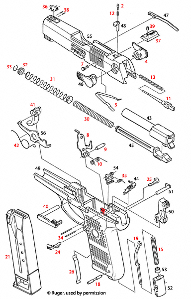

I colored the corner that's broken off in red. Obviously, it is a small piece. It helps to hold the ejector in place with a pin that runs through both and through the other side.

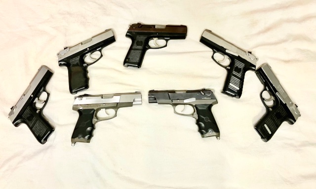

These are mine and this is after letting a couple go to different homes:
P95s are in the arch... two lower pistols are 89s.
I picked up a Browning pistol that had the part (#44 in above picture) that elongated the hole that it was in, and somebody put epoxy in to attempt to secure it, but that didn't work too well as it became loose again. I picked up some industrial liquid aluminum, and after getting out all the epoxy I secured the pin with that stuff. It is hard as a rock and cannot be filed down either. It worked perfectly and never came loose again.
