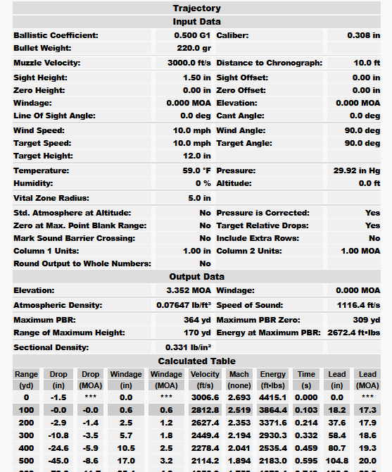

Looking at the jbmballistics link, it does not require SD as an input.
That's correct. It's not an input. It's a calculated value based on the bullet and displayed in the output. Hornady & others will tell you the SD they calculated for their bullets in the bullet specs:
https://www.hornady.com/bullets/rifle/30-cal-308-220-gr-interlock-rn#!/ Same bullet as in the JBM example
JBM example:
Gunny mentions JBM. If ya want the bottom line for various bullets & calibers performance(drop & energy) at a given yardage, this is the next to last step. The last step is to verify on the range.
But SD isn't really mentioned just as Gunny mentions in post as I was typing. I suppose the program figures all that in when you feed it the info it request. I shoot a lot of long range steel & JBM is used often.

It's interesting to note that the shape of the bullet has nothing to do with the SD. A 220grn .308 rnd nose has exactly the same SD as it's pointy nose cousin. Which is the main reason I ignore it. See the Hornady bullet page to compare whatever you like. :)
