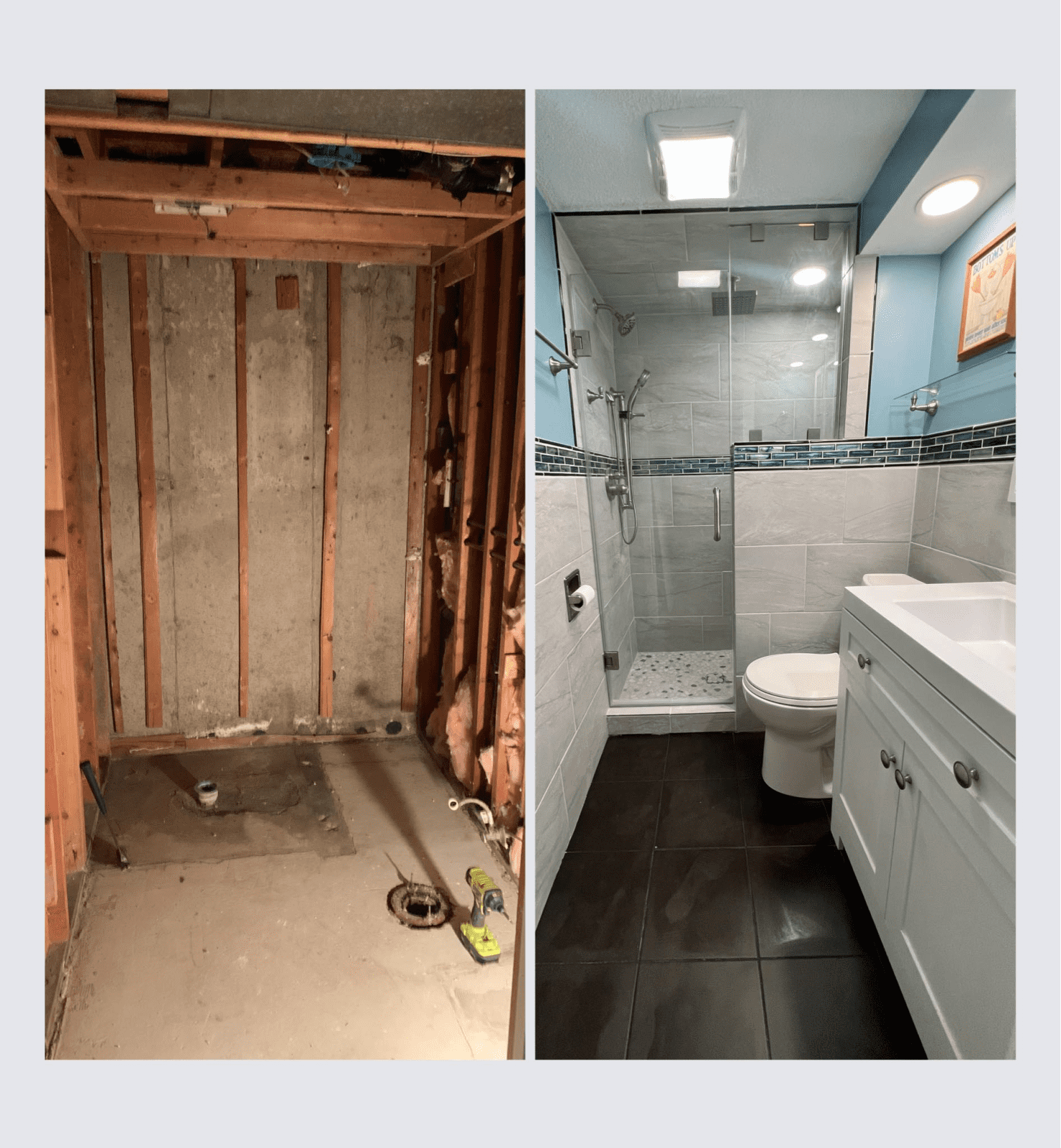

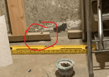

Another option, if you do not have access to the .22 cal nail gun, is to drill a slightly oversized hole through the treated bottom plate and into the slab, then pound two nails into the hole so they wedge against each other and hold the plate down. This is the method I used when rebuilding a bathroom in my basement:
(Which I realize you cannot see here....)
Here you go:
