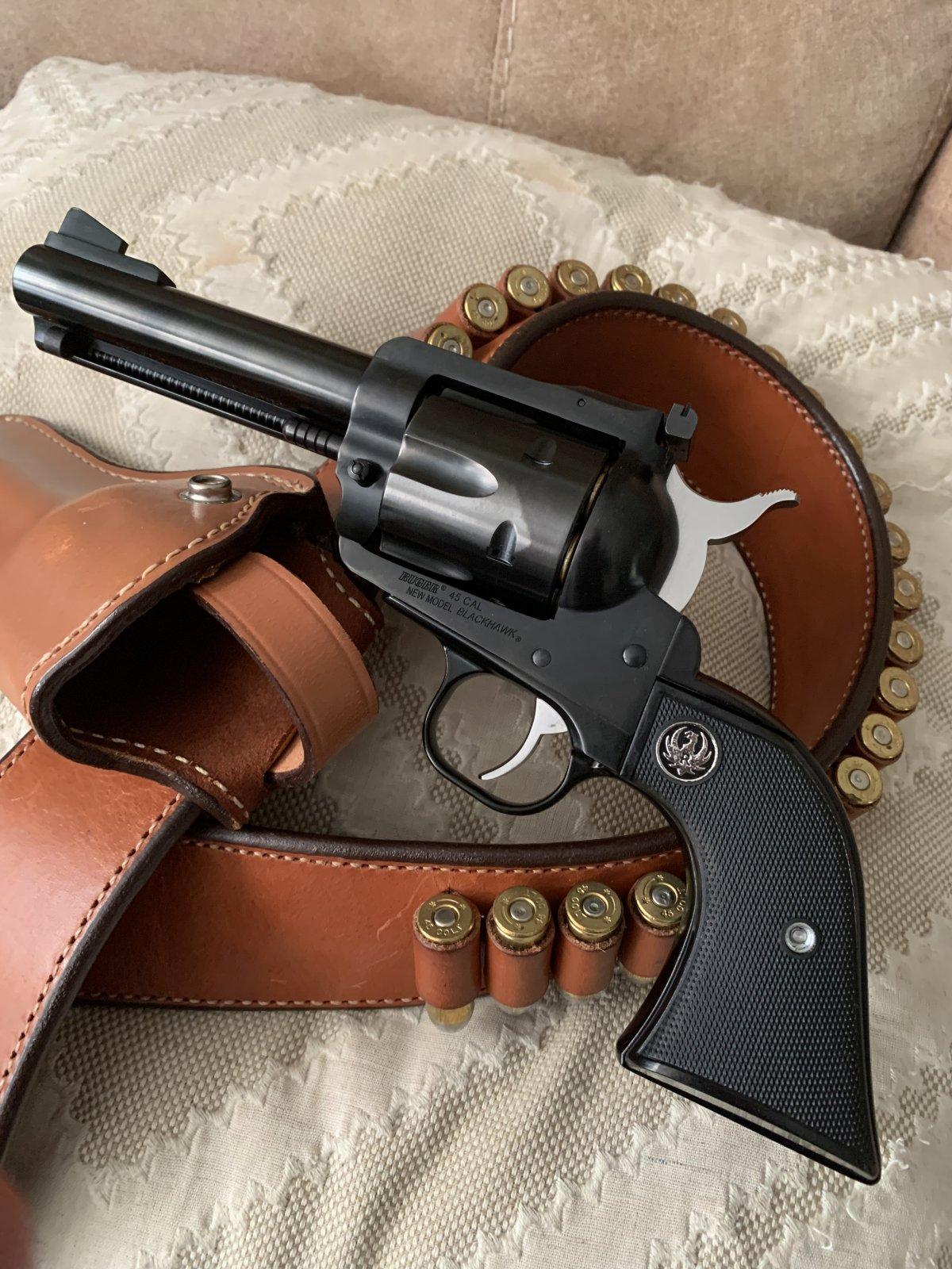

After checking it out I did notice some things that are odd. The right side of the trigger guard/grip frame is not flush with frame. The stocks are undersized to the grip frame. I would like to get some after market walnut stocks, so I'm hoping this won't be an issue. In usual Ruger fashion, you can't remove the cylinder base pin w/o removing the ejector rod housing. Belt Mountain is out of business so I can't get the Colt style pins for Rugers anymore. I also assumed the ejector rod housing would be aluminum, and in anticipation of this I purchased a steel piece. But the housing installed on my gun is steel (did the magnet test). Otherwise, I'm pleased with gun. I'll run some rounds through it shortly. I just put some dummies in the belt loops to make the pic look good. Don't know why it so large though.
Yep, those look like the current XR3-RED series black plastic grip panels. They may run slightly smaller than the grip frame, depending on the particular gun and panels. You might see the same situation on current Ruger wood panels as well. They "fit" but may show a little of the grip frame around the perimeter.
Had mine for a few weeks now....those plastic grips had to go immediately. Replaced with Ruger Rosewood, looks and feels much better.

Midway has some nice walnut XR3 stocks by Hogue. I tried a set of ruger OEM stocks from my old model vaquero and they were undersized too.
Miday and the Hogue website just list the stocks as XRT. There is nothing listed in either site for the XRT-RED. Of course the picture on Hogue shows a very well fit set of grips. Don't know if I should just order directly from Hogue and take chance. Sorry XR3-RED!
I almost feel like the XR3-RED grip frames are now slightly bigger instead of the other way around. Not sure it's the grips that have shrunk. I put some Old Model Blackhawk XR3-RED walnut grips on my Blackhawk sized XR3-RED Wrangler grip frame and the walnut was barely short all the way around on both sides. Gun and grips are 50 years apart in age. The OEM walnut grips and another set of walnut Ruger grips both fit my 1978 Blackhawk with no extra metal showing.

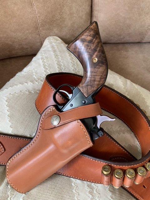

I don't know about all of them but my 2013 .357 did have an aluminum grip frame replaced with a stainless Dragoon style.
I can live with the aluminum GF. I would prefer a stainless if not only for the looks and a little extra weight. If it was a simple remove and replace it would be better but, nothing is easy when it comes to working on guns.
