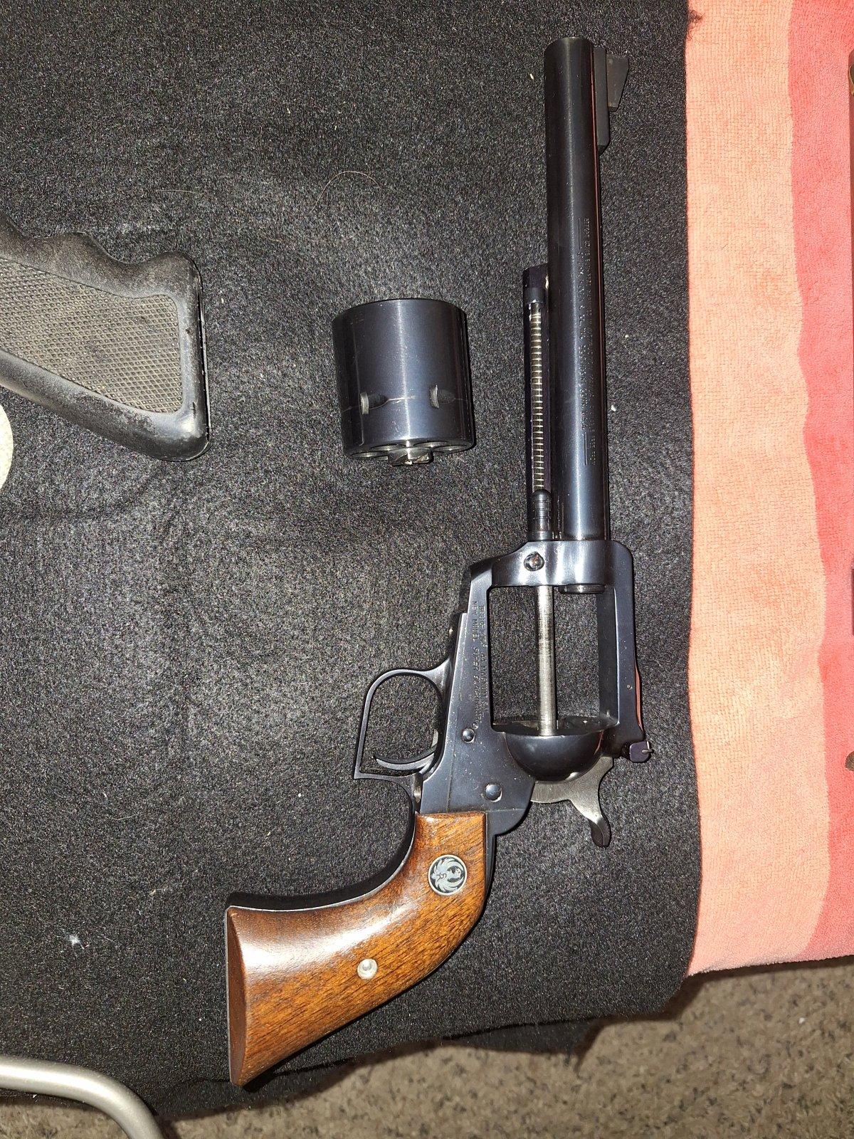

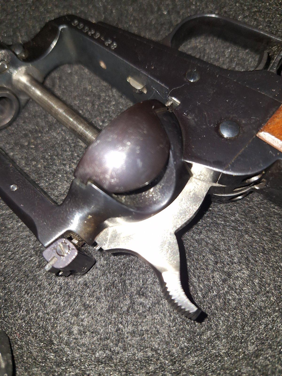

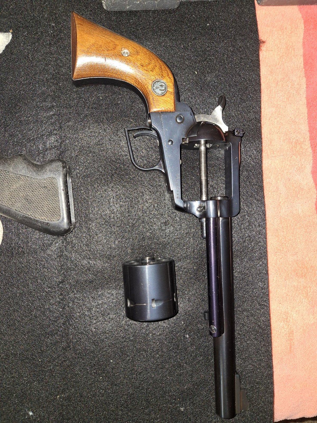

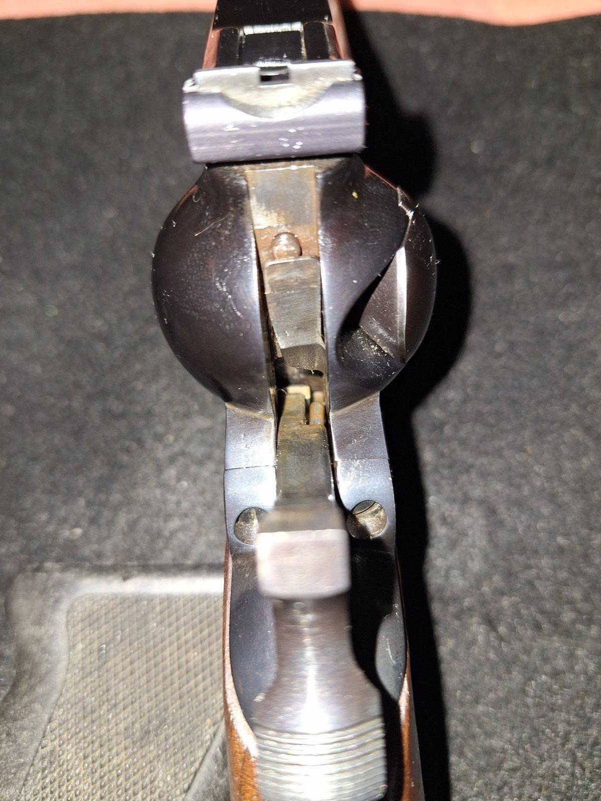

Okay, looks like a transfer bar, so New Model. I pulled the pin, got the gate open, and pulled the cylinder. Upon closer inspection, it was pretty dirty in there. I've cleaned everything accessible with the cylinder out.
Now I can't get the gate open to put the cylinder back in. I have the pin fully inserted. There looks to me to be a hiccup here - when I bring the hammer back, I here two clicks and it's at full cock. But it I try to just go to half-cock, so I can open the gate, the hammer seems to go all the way forward without resting at half-cock.
I plead total ignorance here. My life was carrying a Browning Hi Power and a shotgun, so I'm a noob here.

Well, an older thread. BUT,, we'll try to help.
Go back & RE-READ needsmostuff's post. You haven't taken it apart to where you can get to the loading gate spring.
A New Model doesn't have a "half-cock position.
Get a manual,, and read how to disassemble & re-assemble that gun. The things you are describing screams that it's the loading gate spring causing your problems. They can be a bit "challenging" to work with at times. Especially if you aren't familiar with the NM actions.
Ruger will send you a manual for free too!
jpsnides,
On a New Model Blackhawk/ Super Blackhawk, you do NOT cock/touch the hammer to open the loading gate. You simply open the loading gate. That is part of the re-design that makes it a New Model.
kean57
Jpsnides,
And if the hammer is not down all the way the loading gate can not be opened. It's a safety lockout system completely foreign to old models.
From post #12:
"when I bring the hammer back, I here two clicks and it's at full cock. But it I try to just go to half-cock, so I can open the gate, the hammer seems to go all the way forward without resting at half-cock."
My response:
You are working with a Ruger "New Model" action. There ain't no "half cock". You may also note that you'll need to leave the hammer down or the gate is not going to open.
DGW
Just a side note, without the cylinder pin installed if the barrel is pointing up, then the transfer bar will fall away from the firing pin and the action can be worked.
