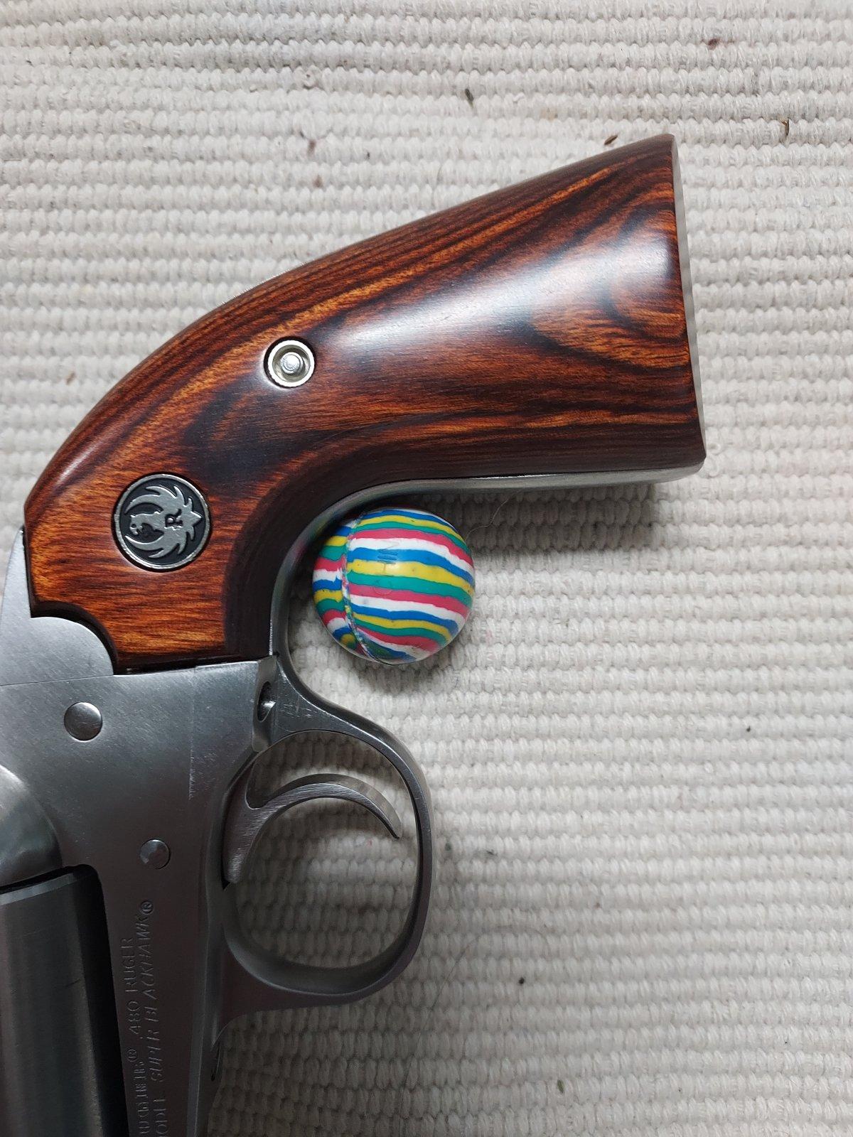

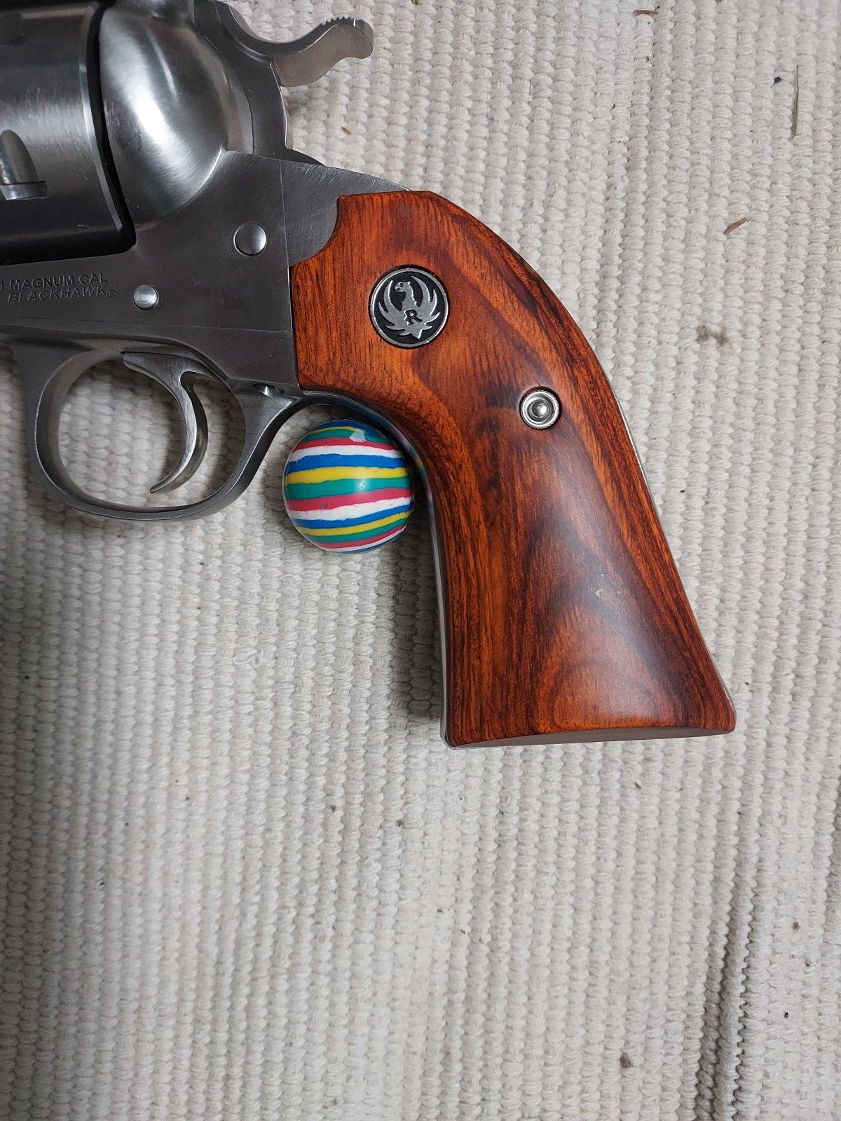

I have added a hunter grip frame to my 7.5" 45 colt Ruger Blackhawk and really like it. I gain some clearance on the Bisley grip frame with the stocks off and am now thinking about blending the stocks down to thin them where they come into the front of the grip frame. It seems like that will get my knuckle around the grip more and give me more room. I sanded the front edges of the stocks some and gained some real estate between my knuckle and trigger guard. It might be enough but won't know for sure until I shoot it.
Any of you guys that have a Bisley grip with a Huntington type mod care to take a pic of the frame without the grips on to show how thin the section that is relieved is?
Thanks, I started the process of reforming my grip frame earlier today but had to stop to go to a birthday dinner. I plan on doing the lower rear as shown in the above pic too. The hardest part will be the finish sanding to a even radius.
Difference between re-contoured grip frame of 480 and factory 41 Mag. Even though I gained space between trigger guard and front of grip my knuckle still seems to be pretty close to trigger guard. I guess my hand and the Bisley grip frame just isn't as compatible as other peoples are. I may do this to the 41 Mag grip frame but would want to find some better sanding drum sleeves than in the kit from Harbor Freight. I looked for Blue Zirconia drum sleeves but haven't located any yet. I have some finish fitting left to do then call it done. If it still raps my knuckle it will get a SBH Hunter grip frame.

I got out to try the grip modification. Shooting a 400 grain lead bullet with a max load of Longshot I only hit my knuckle once and that was was while resting forearms on roof of car shooting at an uphill target at about a 45 degree angle. Otherwise it was good. I still think I like the roll you get from the plow handle grip more so than the slam into the palm of the Bisley. The Bisley recoil reminds me of the recoil I had with my Thompson Contender with the 444 Marlin chambering and their Muzzle Tamer compensator. It would drive straight back like a battering ram. :shock:
