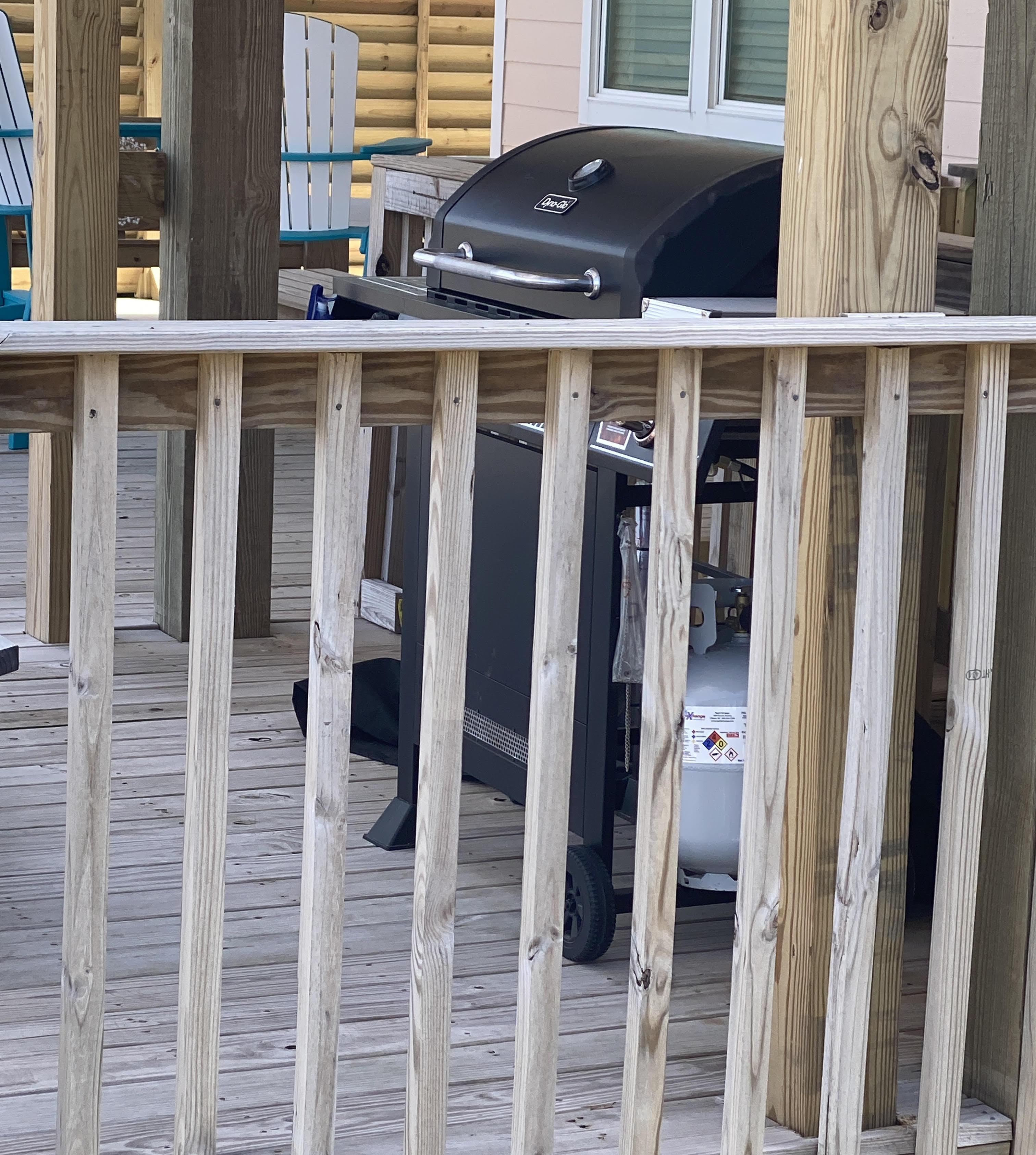

I remember a while back, someone posted something about propane bbq grills. Or some sort of mishap with a propane tank, I don't exactly remember what.
But is this safe? Our neighbors down at the beach have this up on their deck. It's a propane grill on a wood deck out in front of the house. I've thought about doing something similar, but wonder about the heat bothering the wood. I suppose it would also be pretty messy after a while.
But is this safe?
I had one inside my back patio for thirty years. The only time it became a problem was
when the grease had built up in the cover. Fortunately I had a spray bottle handy and when
it caught fire, I was able to put it out very quickly.
That said, I had a window just above it and a LARGE fan mounted in the window. I also did
not leave it unattended for more than a minute or so.
I got by with it, but I would not recommend it.
P.S. Sitting on CONCRETE, and nothing combustible close.
P.P.S. IMO, I got LUCKY!
P.P.P.S - - Really nice in a January snow storm. ;)
Also consider what is above the BBQ. Back in BP (before propane) days just about everyone used eithe charcoal or wood. And most BBQ's were open topped. We had a heck of a time putting out an attic fire when some numbskull set his BBQ under his patio cover. Cover caught and the flames drafted right into the attic through the eave vent.

Just keep the propane grill at least 2' away from combustibles. Most of the time ours was less than 2' from vinyl siding w/o even causing a wrinkle.
I believe I remember that thread you mentioned. If memory serves there was some type of malfunction with the propane tank or BBQ that caused it to vent a large amount of the propane all at once which caused an uncontrolled fire. If a propane grill is functioning properly don't think it would be a problem on a deck as long as it was monitored. I don't think it would radiate enough heat under normal operation to bother a deck. Now, that said, we had one in my neck-o-the-woods a few years back where they had a charcoal grill on a wood deck on a beachfront home. They lit the charcoal and went back into the house to let it get up to temperature. In the meantime, since the grill was a few years old and had had many BBQs in its lifetime and was subjected to salty ocean air every day the bottom had corroded and as the charcoal heated up it fell through the weakened bottom of the BBQ and lit the wooden deck on fire. They lost that home and the homes on each side of it also before the fire department got it under control.

Mine has been on a wooden deck for 20 years. Heat goes up, flame is 30 inches above deck. My gas logs are right down on the floor level in the living room and are safe. You do need to pull grill out from siding and railing when in use. Don’t ask how I know. I have one of those sheet metal fire pits I sometime use with screens. I have a heat shield under it and a pallet to give circulation. Works fine.
Ours is on a wood deck with a mat under it made specifically for that purpose.
It does need to be pulled away from the house or they will melt the siding.

I barbecued for 15 years with my weber gas grill on my wood deck next to my house with wood siding. Since wood typically combusts at over 570*F, I don't think it's a problem unless you can get your bbq higher than that. Now if you use coals or open fire, I could see embers potentially starting something.
A neighbor had a propane grill near the house and there was a flare up, not sure why. The flames went up into the roof soffit and lit up the siding and roof. The house was a total loss. Local code says says grills should be 10 or 15 feet from house.
That wood deck will get hotter from the sun than from the grill. As already mentioned be more concerned what's above and beside it.
Vinyl siding melts a a relatively low 160 degree range. Old house had a wood deck and the only issue was cooking grease spills or splatter

The people across the street had a propane grill right against the back of their home. Either the tank was not attached correctly, or the seal was damaged or missing. The man said they had just changed the tank. When they lit the grill fire spewed out of it where the hose connects to the tank. It was against vinyl siding. The siding caught fire though the homeowner said he was wetting it down trying to keep it from catching. From there the fire went right up into the eaves & into the attic. The whole house was on fire in short order.
The grill was behind their home. I was sitting on my front porch. It took me a couple of minutes to figure out what was going on. First, I heard popping noises. I thought they might be running some sort of equipment. Then I saw white smoke (steam from where the homeowner was wetting the siding down}. Finally, I saw flames shooting across the roof. That was when I ran across the street. They were coming out of the house. I asked if everyone was out. They were. I realized then that I don't think I could have made it in. It was very hot.

All of the manuals I’ve read say at least 2 feet from combustible materials. It goes up as the BTU rating increases.

This particular house is down at the beach. We bought a second home down there a while back. And this is our neighbor. His house is probably just 10 or 12 feet away.
Both houses have hardy board siding.
Last time I was down there. I looked over and the same neighbor with the bbq grill now has a giant 7 or 8 person hot tub up on the deck also.
I talked to a friend of ours that builds houses there at the beach. He said no way are those decks sturdy enough for hot tubs. So this neighbor doesn’t use very good common sense. I’ve only seen him a few times. They are just some nice retired people.
Next time I talk to my builder friend, I’ll ask him about the bbq grill. I wonder what he thinks.
Hardie Board siding is made of cement, sand & cellulose. I expect it would not be as flammable as vinyl. I still don't think it is a good idea to have a grill very close to the house. If something goes wrong it will make a problem worse. The house across the street has still not been rebuilt. The neighbor came back about a year ago & spent some time working with a bobcat. Grading & taking down trees. I don't know what the problem is. The last time I spoke to them they wanted to rebuild. Maybe they are having an issue with financing the rebuild.
