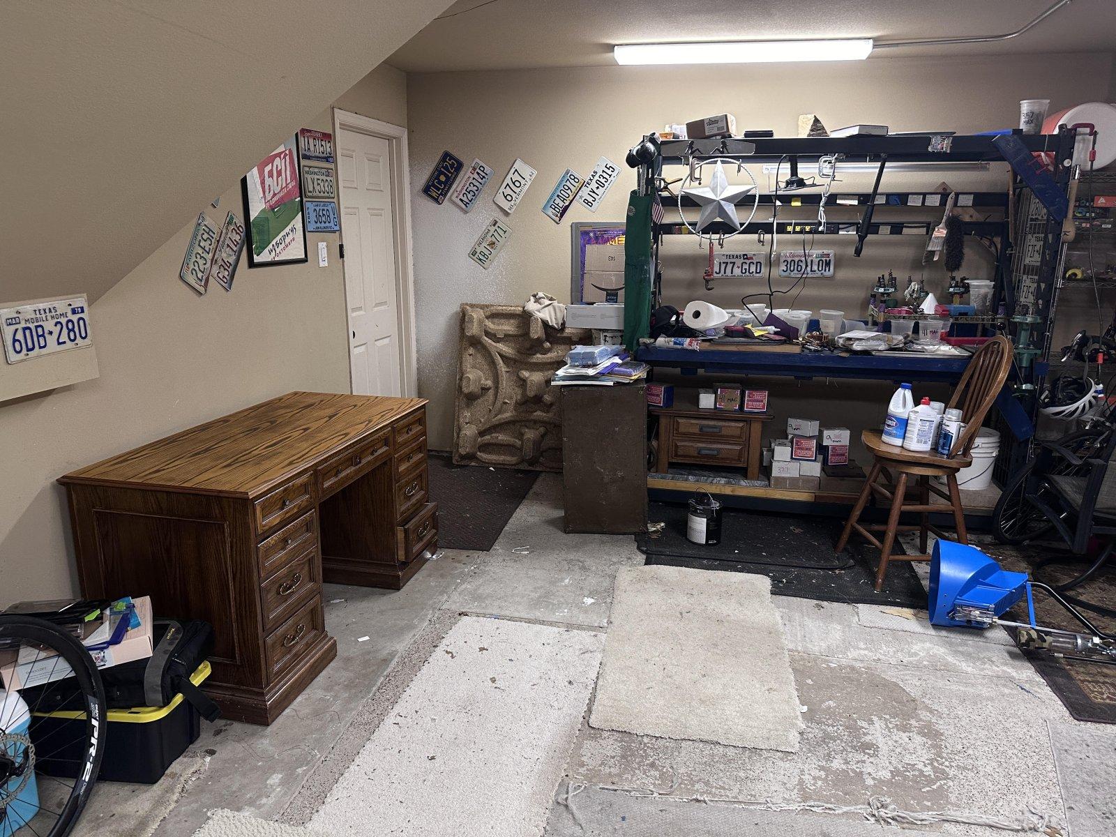

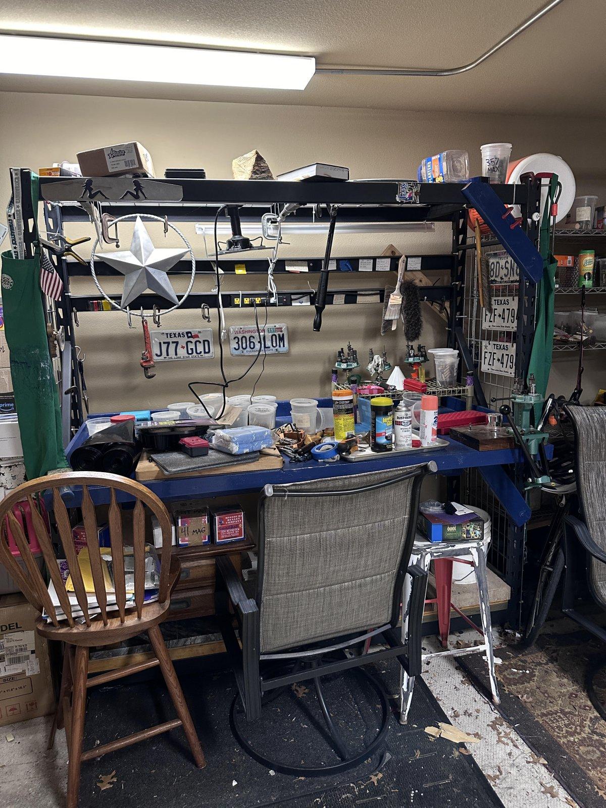

So I bought one of those heavy duty shelving systems from Home Depot. Here's a picture. I did a good job building the bench. It's not coming apart without destroying the whole thing. And heavy. It doesn't move when I'm reloading.
But, as you can see the top bar, part of the structure only gives me 37 inches of room between the blue shelf and the top cross bar. The problem is, the Dillon is 40 some inches, plus a strong mount, making it almost 50 something.
Here's the picture. Yes I know it's a mess right now. I donated my Hornaday press and powder dispenser to my range so they could have a reloading room there at the range. Hopefully that works out.
I think what's going to happen is on the other side of the garage, I have a heavy oak desk our neighbor gave us when they moved. The nice neighbor, not the anti-social one. It's very nice, and solid, I hate to drill into it, but 4 holes isn't that many, right?
At least, today is a nice cool day, so my plan of attack is to get both the bench and desk cleared off and ready to mount the Dillon.
It's getting there. I moved the desk closer to my reloading bench. Luckily it's Bulk Trash time again (each month) so some of this stuff is just going to get tossed. Like that pallet I thought I'd use. Not sure what for...
Like a spare dining room table. I think it's Maple and I just couldn't pass it up at a thrift store. But it's going back next week.
Anyway, here is the desk. I started to refinish it, and so I just put a coat of oil on the raw wood top. It looks pretty good, but I'm so sick and tired of oak. Perhaps someday I'll paint it.
Yes, I know the garage is a mess. In my defense when it's 110F outside, I don't really feel like cleaning a garage.
This is my Fall project. And what's better to do than document it here?

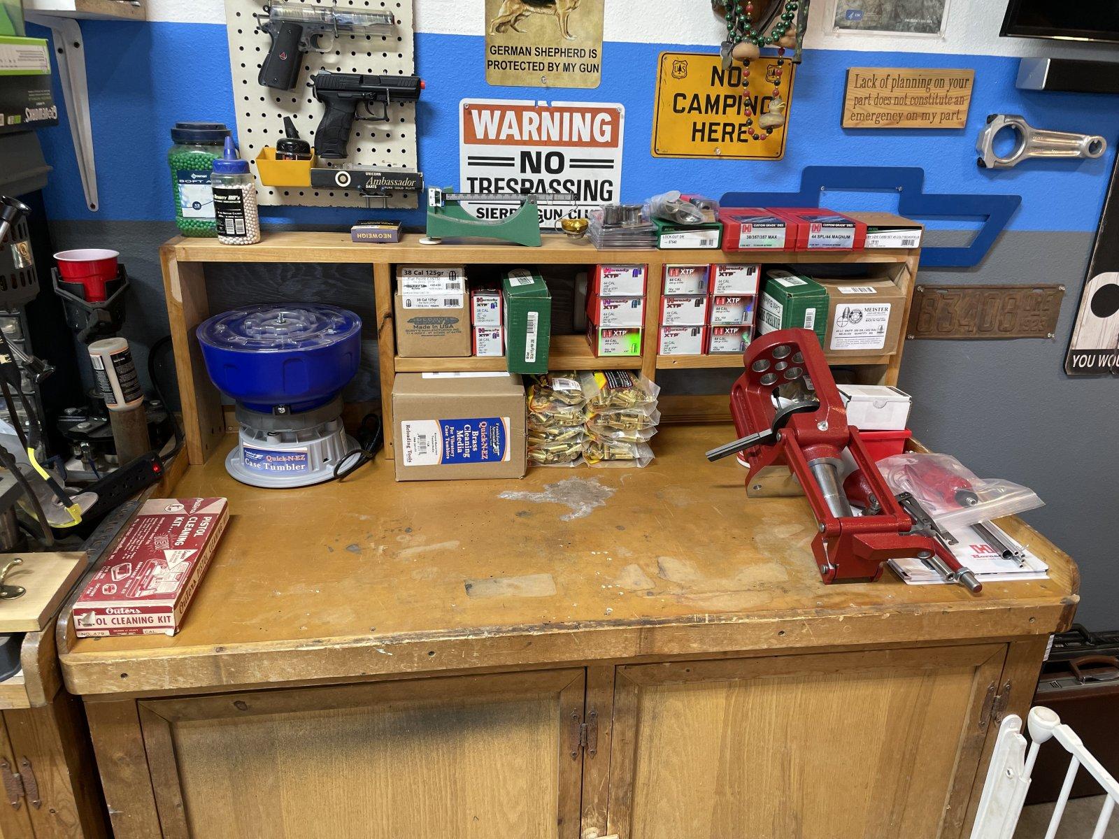

My first reloading bench was an old solid-core door across a couple of sawhorses. This is my new one. It is constructed on a layer of 2x10s with a layer of 3/4" particle board screwed down to it and another layer of 3/4" particle board glued on top of that. Oak strip on the face and 5 coats of gym floor poly to finish it. I still use my old 1974 Lyman Spar-T and a newer RCBS Summit press.
It normally doesn't look like this, there is usually so much crap on it I have to clear it off before I can do any reloading.

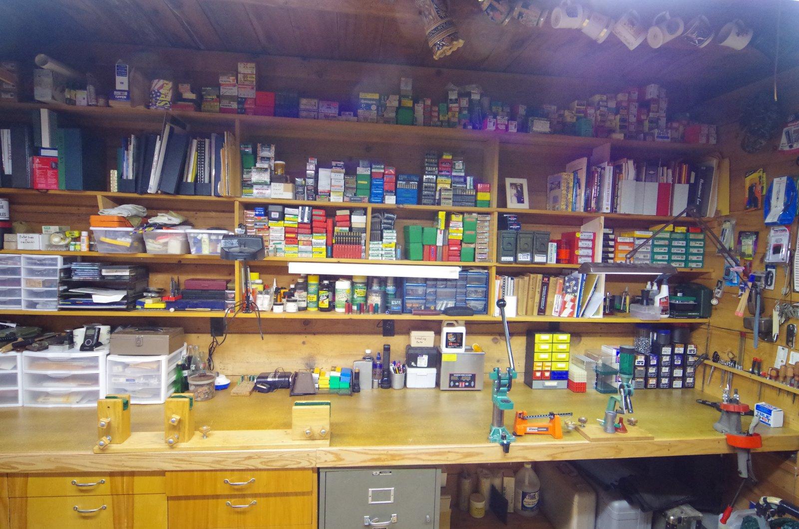

This was my setup ( before finishing) in my old shop. The shop was was 24 x 36.
My current garage is much tighter at 20 x 18.
I learned many years ago that to get what I needed was to build it. Done that in 3 homes. The current bench is 12 feet long. I like to stand and be able to move left and right so bench is made tall. I have another (work on guns bench) 8 feet long, lower so I can work while looking down on the guns. while mounting scopes or sit on a stool to clean guns.
My builds are like this. Bench top 3/4 thick plywood ripped so it's 2ft by 8 ft. I glue and screw that together. Mount a 2x4 on the wall at height you want. It's mounted into the wall studs. Cut legs from 4x4s. Use another 2x4 across them. Mount plywood top with screws. Add shelfs for what you want to store on them. Figure spacing by your needs. Use 2x4s for support with double thickness ply as the shelf. Figure out where you want to mount presses. You can even mount them on 2x8s that you clamp to the bench if you want to move them.
Build shelving above bench if you want. Mine don't move, wiggle when using them. Shelfs below hold ammo and bullets to add weight. Ammo cans with bulk ammo and bulk lead stay on the floor under the bench.
