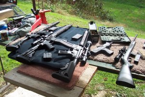

THE BARREL IS PINNED AND THAT SETS THE HEAD SPACE YOU CAN'T GO WRONG IT ONLY FITS 1 WAY . i SOMETIMES USE BEAR CREEK UPPERS BUT I TAKE THEM APART AND CHECK BARREL NUT IS TIGHT AND ALL IS RITE . sorry cap was on . i had 2 come back with loose barrel nuts so i check them all .But i do buy parts and build my own uppers to. all anderson lowers . stay away from 223 wylde if you don't want to only have to shoot brass case .steel will stick in chamber so your limited on ammo choice .

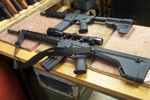

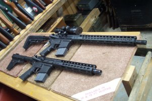

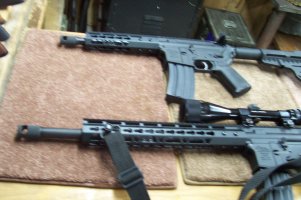

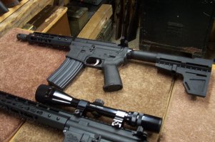

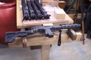

THERE IS NO HEAD SPACING, IT IS ALREADY SET BY THE PIN ON THE BARREL BUSHING THAT COMES ALREADY SET AND PINNED AND RECEVER HAS A SLOT FOR PIN TO SEAT . sorry cap. A monkey could build a ar15 only thing to make sure is gas block is in line with barrel port and your good to go . i collected for 30 years with no ars now i got over 10 and have payed off my house building for people .You have to have them do the ffl on lower receiver and i have them wait while i build it so no over night keeping there gun so no ffl needed . i have cut back but have done like 60 or so in 5 years .As long as they do ffl to them and are there when you build it as helper?? it is ok with no ffl .but if you keep there receiver and build it alone you will need a ffl or manufacturing license . i build my rifles and pistols to match have 556 set 300bo set 762x39 set and a single 458 not pictured and a few a2 rifles in 556 that dont match . I got Anel and sold my lowers and went with consultive ser# now on mine also
This is incorrect; AR headspace is set by the relation between the barrel threads, the barrel extension threads, shoulder, and locking lugs, and bolt locking lugs and bolt face depth. The barrel extension pin relates to gas port alignment only. The headspace dimensions on an AR are difficult to adjust but can be done with the correct tools; most people don't have them and so just swap parts until they are in tolerance.
