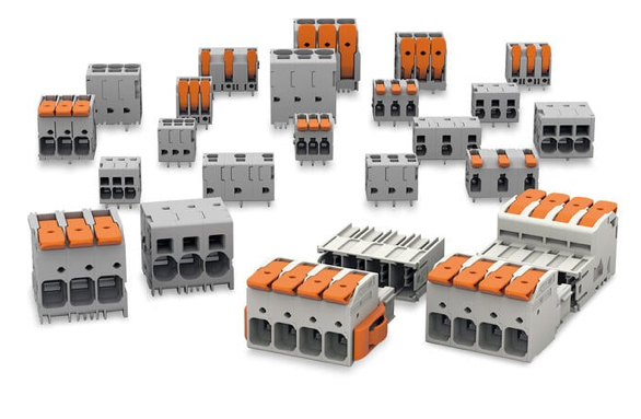

I’ve switched over to Wago’s.
https://www.wago.com/us/discover-pcb-connection
