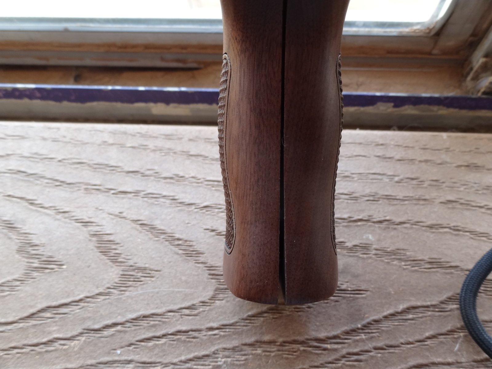

Altamont has been a go to for reasonable priced grips for a couple of hand guns and I have been pleased. Recently I bought a pair of Altamont's G-10 material, for a Heritage birdshead available only through Heritage not on the Altamont web site. The fit was nothing less than horrible, way too big everywhere around the grip frame and bad fit at the 90* top on one side. Oversized I can work with and a couple of hours of hand fitting later I was pleased. Not at all how I wanted to spend my time. The review I wrote on the Heritage web site was never posted for viewing. Just another data point.
Non Ruger Content Photo

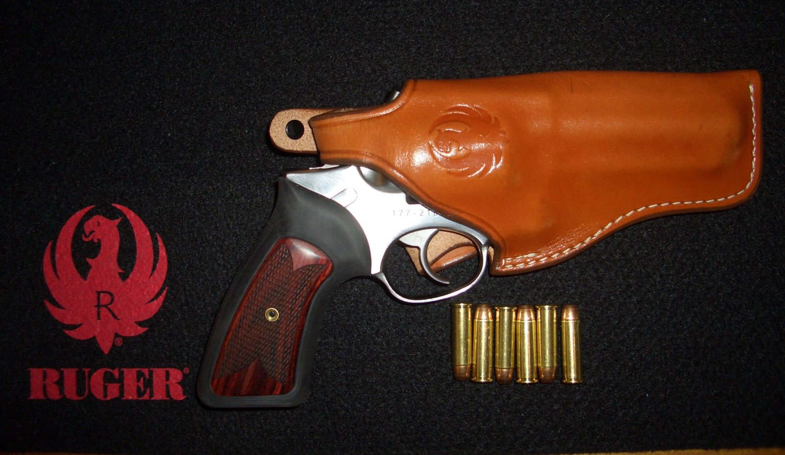

I bought a set of Altamont Grips for my GP-100. They were great. This was back in early 2015. Has everyone here purchased their grips from Altamont since then?

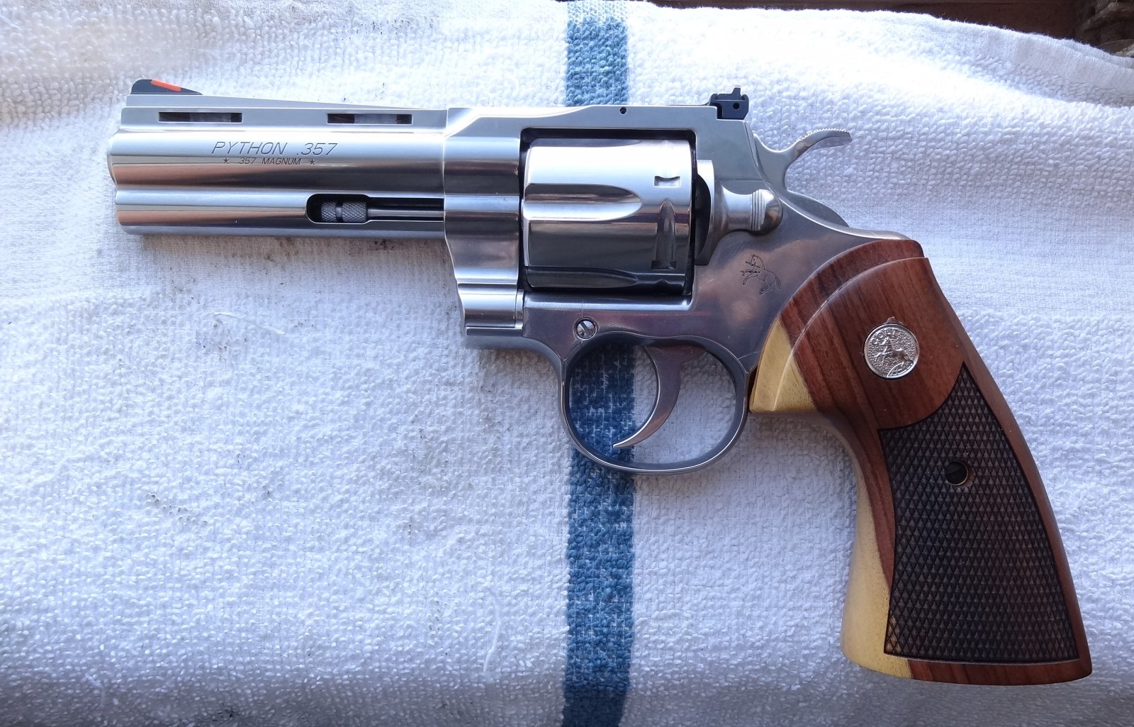

Have a few sets of Altamont grips, one on on my 2020 Python that I really like. Another set I order for a Smith & Wesson Coke Bottle style that fit like crap and the second set was no better. My 1920 Luger has a set but the cutout around the safety lever is too big. Called them on it and they said would forward it to there engineers?? My last two Blackhawk Ruger's the grips sucked also. I miss Lett grips.
