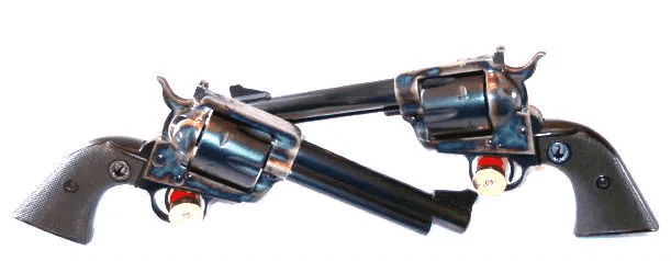

A couple of beaters I had converted to 45 Colt.
Wyandot Jim… Yep,,, I like those… /\/\ 😁 /\/\
