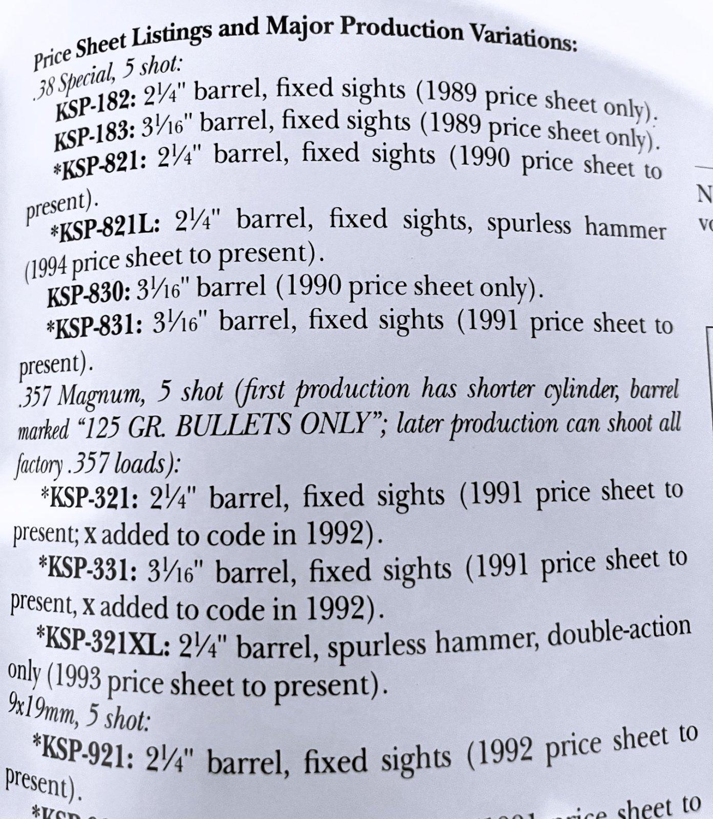

Mine is an early one, (4 dgt sn#) 38 Special Cal. It's a Ruger,,, so if I wanted to +P ,,, I wouldn't hesitate.
Yes this had me thinking as I have a very early Sp101 in 38 SPECIAL.
It is a little weird in that the Box is marked KSP-182, but the shipper is marked KSP-821.
Never noticed that catalog numbering inconsistency before.
In the original instruction manual, page 5 states the SP101 is safe to use with +P AMMO
This is in "Ruger & His Guns" by R.L. Wilson. I don't know if that makes anything less confusing?

As others have stated, the first SP101 chambered in .38 Special had a shorter cylinder and smaller frame window than current models.
When Ruger chambered them in .357 Magnum the cylinder could only handle cartridges with 125 grains bullets because of LOA issues and marked such guns in the frame window. I wish I had one of those.
They soon lengthen the cylinder and enlarged the frame window to handle any .357.
Examples with the shorter cylinder were still produced in .22LR and 9mm because those are short cartridges. I have examples of each.
All that said and to answer the OP's question: Yes the early SP101s marked .38 Special can safely fire any factory .38 Special ammo.
Very first SP-101s had cylinders that were 0.1" shorter. There were models chambered in both .38 and .357. The longer cylinder had been adopted within 3 or so years of the start of production. .357 models with shorter cylinder are marked for 125gr loads only.
Absolutely no concerns firing .38 +P in a .38 SP-101.
I think the 125gr caution was only because of the overall length of the heavier bullets in a 357 case.
Gunsmiths commonly bored them out to accept .357 Magnum loads -- even though, in early examples, it meant the cylinder was too short to hold any .357 load with a bullet heavier than 125 gr. Later, the cylinders were slightly lengthened and the chambering changed to .357 Magnum. A .38 Special SP101 shooting .38 +P is practically immortal...
