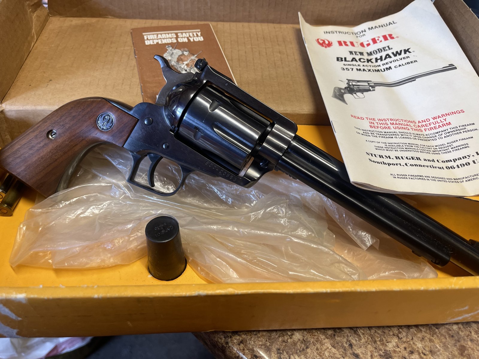

Just purchased my bucket list Ruger. Blackhawk 357Maximum. It is the cleanest used revolver I have ever seen. I feel Blessed

Welcome to the Forum!!!!!
Uhh, I see a problem with that. You see that gun needs to be shipped to me for proper & careful evaluation for,, oh,, maybe 20-30 years to assure it's good for you! :D :D
Seriously,, VERY NICE!!!!!!
Do you handload?
If so, do you cast your own bullets?
If the answer is yes to both,, you need to get the "Bradshaw/Martin" cast bullet mold to match that gun.
David Bradshaw helped Bill Sr. & Bill Jr develop the .357 Maxi. (I have a copy of the G&S magazine where he wrote an extensive, detailed write-up on the (then) new .357 Maximum. A few years back,, David applied his knowledge, as well as working with Lee Martin,, and designed a bullet JUST for the .357 Maxi. I have (2) molds,, and it has become THE bullet I use in my Maxi. It weighs 194 grns (approximately, depending upon alloy,) is then powder coated,, then deep seated, and when the shooter does their part,, an easy 3"-4" grouping at 100 yds.

Sorry, you will need to evaluate by pictures Yes I do reload but do not cast. I ordered Montana Bullet Works 180gr WFN-GC for pig and deer hunting. Probably use IMR 4227. Thanks for the comeback. 🇺🇸🇺🇸

Nice gun. I'm sure it will perform for you with those 180 WFNGC Montana bullets. I don't cast either, but have had good accuracy with the Montana bullets in two Maxis with 4227. I've had even better results with GT Bullets 180 gr HP hard cast and that powder. That bullet will go hunting in a 7 1/2" Maxi with me this Fall.

Seriously,, great snag. And handloading is dern near required for the Maxi since factory stuff is hard to find and expensive.
Your choice of bullets is a good one. And the powder choice,, also excellent. It's the powder of choice for the Bradshaw/Martin bullet and in general, about the best for the Maxi.
If you want to learn a lot about the Maxi's,, visit the single actions forum, by Lee Martin, look for bradshaw,, and his postings. Tons of data & experiences there.
