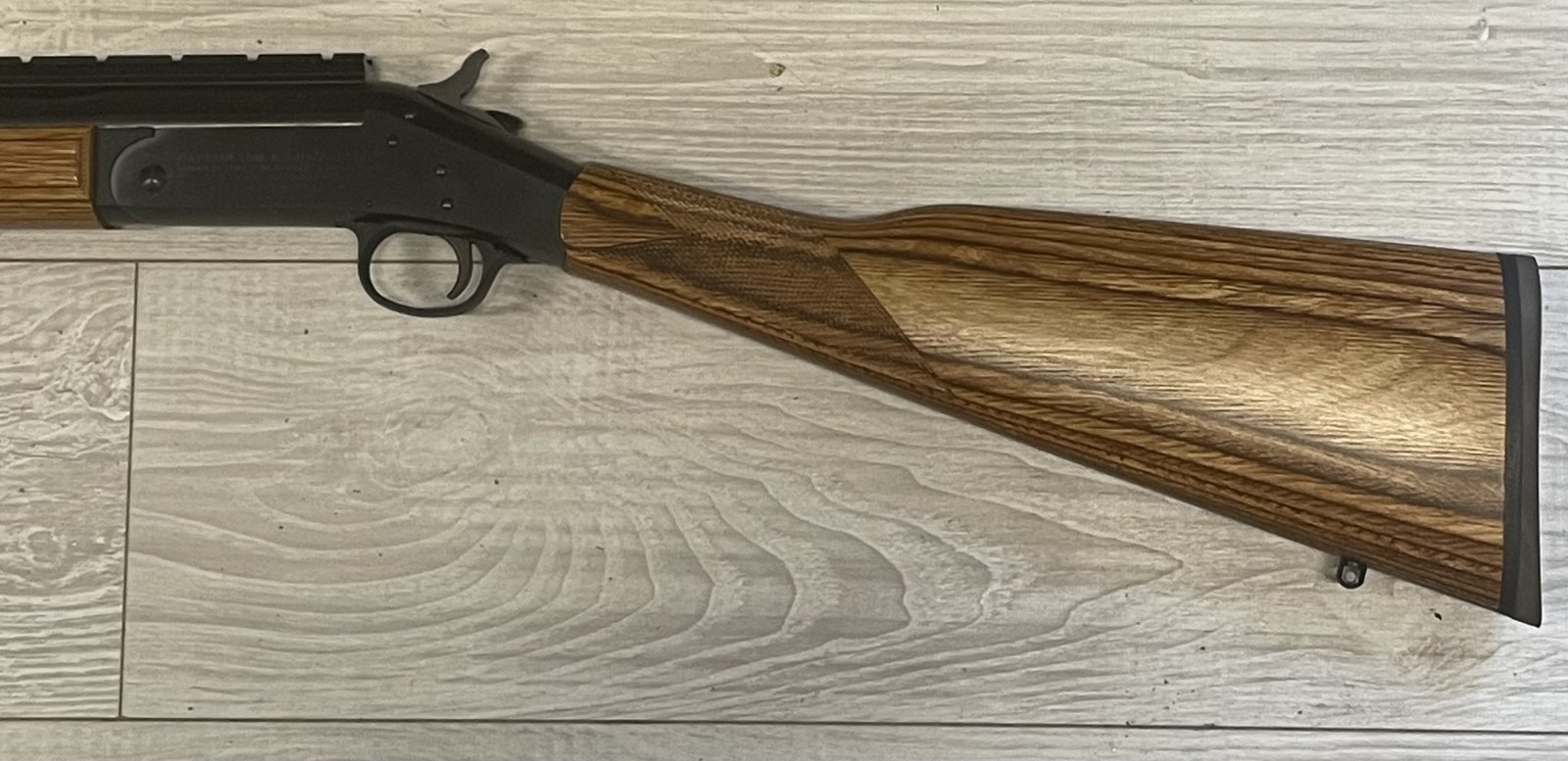

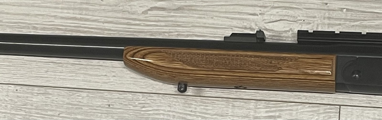

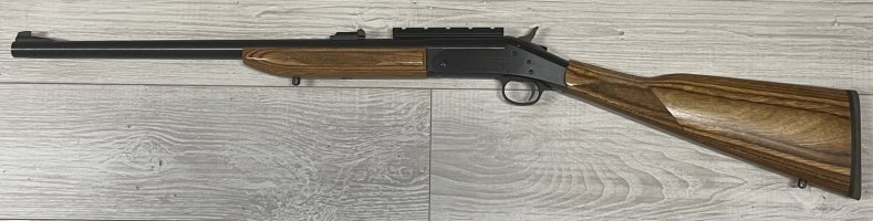

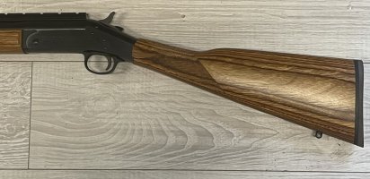

.357 Maximum Rifle. I bought this one 15+ years back. I also have a 7.5 Ruger maximum and a Dan Wesson maximum. I would like to get a 10 Inch Ruger maximum also.

maxfan wrote ".357 Maximum Rifle. I bought this one 15+ years back. I also have a 7.5 Ruger maximum and a Dan Wesson maximum. I would like to get a 10 Inch Ruger maximum also."
Wow! I didn't know H&R made a Handi rifle in 357 Max. Is that an iron frame like the 357 Mag, or a steel frame like the rifle cartridge Handi rifles?
I'm thinking that if it's an iron frame, then a 357 Mag Handi rifle barrel could be reamed out to 357 Max. Handi rifles in pistol calibers and shotgun came on iron frames to reduce costs, but rifle caliber rifles came on steel frames.
