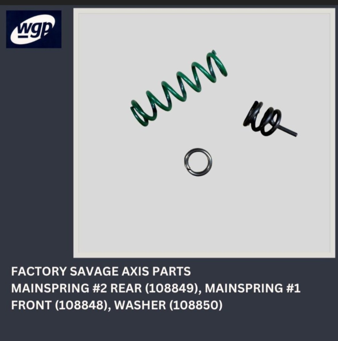

Riddle me this batman, my savage axis in 270win dam misfires 3-5 rounds out of 20. Maybe a tick up more. Dont get me wrong, she can group but when she goes bang. Ripped the bolt apart, dam firing pin spring is in 3 pieces. 1 short piece in front with a washer thingy in the middle followed by a longer piece at the end. Thinking the springs binds up, What were you thinking savage?

You're going to trash a Savage Axis over a broken FP spring? I'll admit Axis isn't top of the line but you did say it's accurate. Why not just replace the $3 spring and see if that fixes the problem?

It's not broken, that's the design.
hats off to savage for a unique design. That tail thing is actually forward of the setup. Apparently it aligns parts of the bolt mechanism together.
