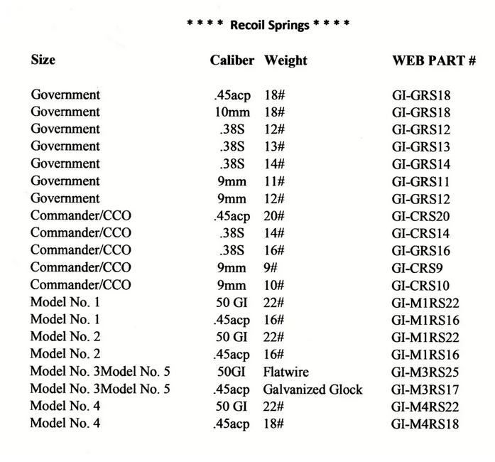

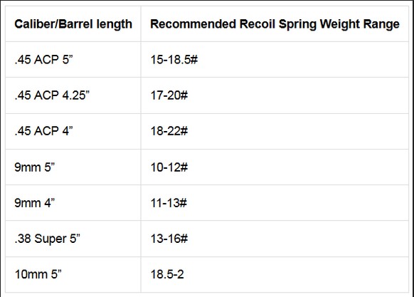

Digging around yesterday I found a few recoil spring charts. They almost all have 9mm Commander length using a 9-13# spring. Might need to order a set of Wolff's.

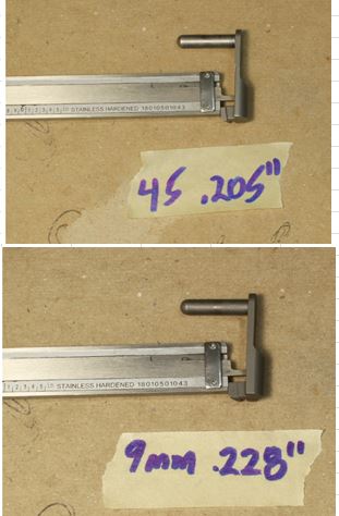

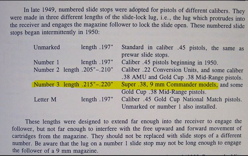

Well, I lied. Second outing was still way better but about 80/85% proper function. In more digging I found a nugget that I truly believe is the issue. Apparently it is not spoken about much, but 9mm/38 Super get a unique slide stop. While it is always a separate part to order, I never saw a reason why until now. I found only two instances in a LOT of digging that told the dimensions of the slide stop lug. Every slide stop I have tried was .197" but one. It was about .200" which was the one that ran better. In finding this nugget I started looking at the follower and stop engagement. The amount of engagement varied from mag to mag and, of course, the more engagement the better they worked. I finally found a #3 length slide stop and plan on testing as soon as I can. I can tell you that on the worst mag I can clearly see MUCH more engagement. For your reference the "golden nugget" of info.
The second reference of dimensions.
