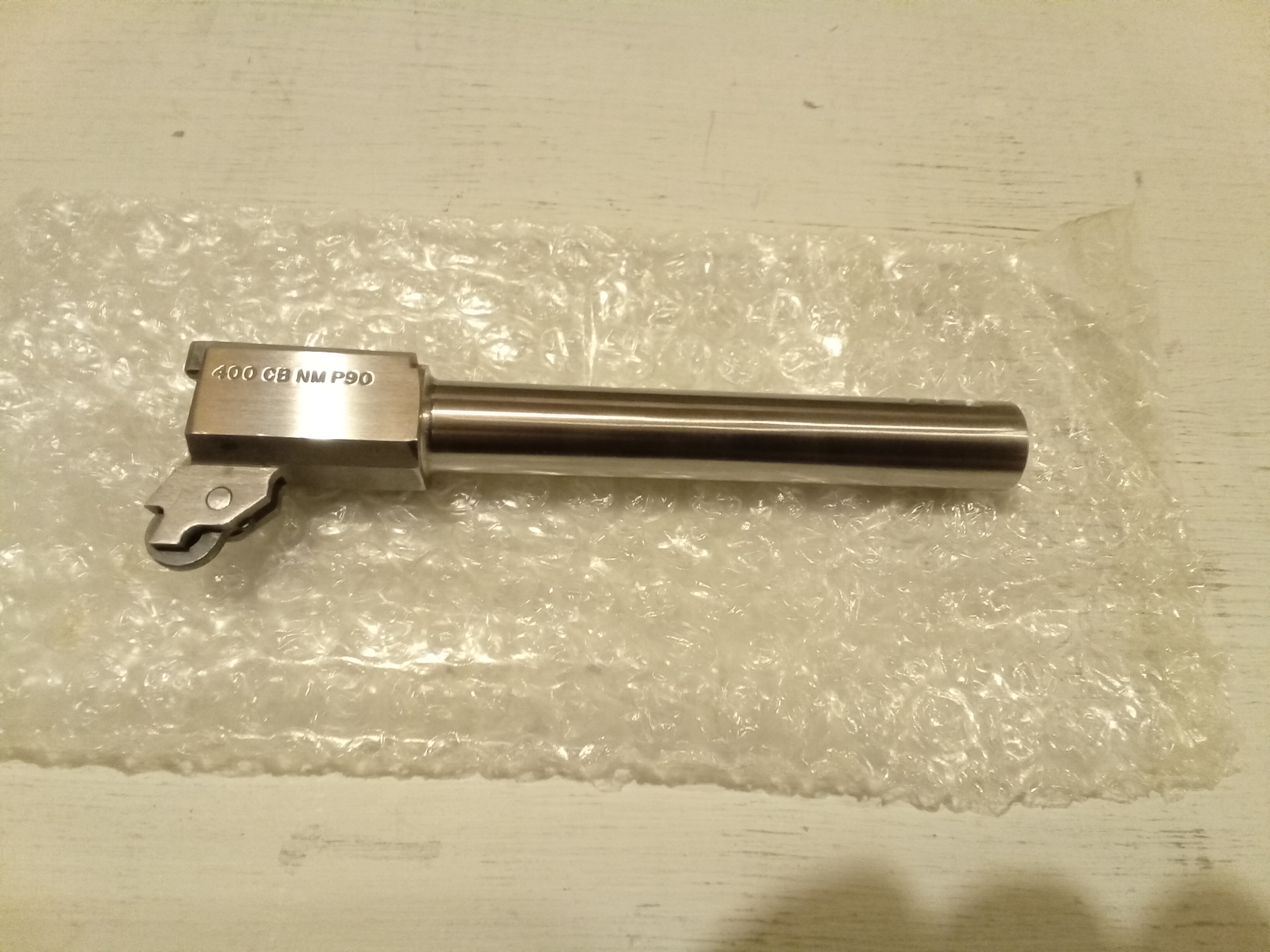

Well, if you're willing to reload, an easier (and cheaper) option might be to find a .400 Cor-Bon barrel for a P90: that's a simple barrel swap, no gunsmithing involved. Probably add a 22 pound recoil spring if you're planning to shoot full-power/10mm equivalent loads. Factory .45 mags work fine.

A 10mm chamber will fully clean up a .40 S&W chamber. The taper is the same and the case mouth dimension is the same, so the reamer will just kiss (a few .0001") the walls of the chamber as it extends it to 10mm length.
Measuring a few ejection ports, 1.299" seems like it would support 10mm. As I said, I don't have any P-series guns to measure, but if all the barrel hoods are the same size, then that's a good indication that at least the slide would support 10mm.
P-series barrels incorporate a lug over the case rim (like a 1911) as opposed to having the rim recessed in the breech face (like a CZ-75), so headspace/chamber depth is properly measured from the back of that lug (which in a properly fit pistol should correspond to the breech face). Easier to chamber and check, just a note for your discussion of chamber depth (which seems to indicate a recessed breech face).
Tangfolio 10mm magazines are 1.369" between the parallel faces and ~1.40" measured parallel to the feed direction. They are .837" wide. If this were my project, I would purchase a magazine (likely the cheapest and most critical part of the conversion) and make sure that the angles and dimensions were conducive to the next steps.
The only other issue I see is that the P91 and P90 barrels definitely have different feed ramp geometries, and you may need significant modification here as well.
