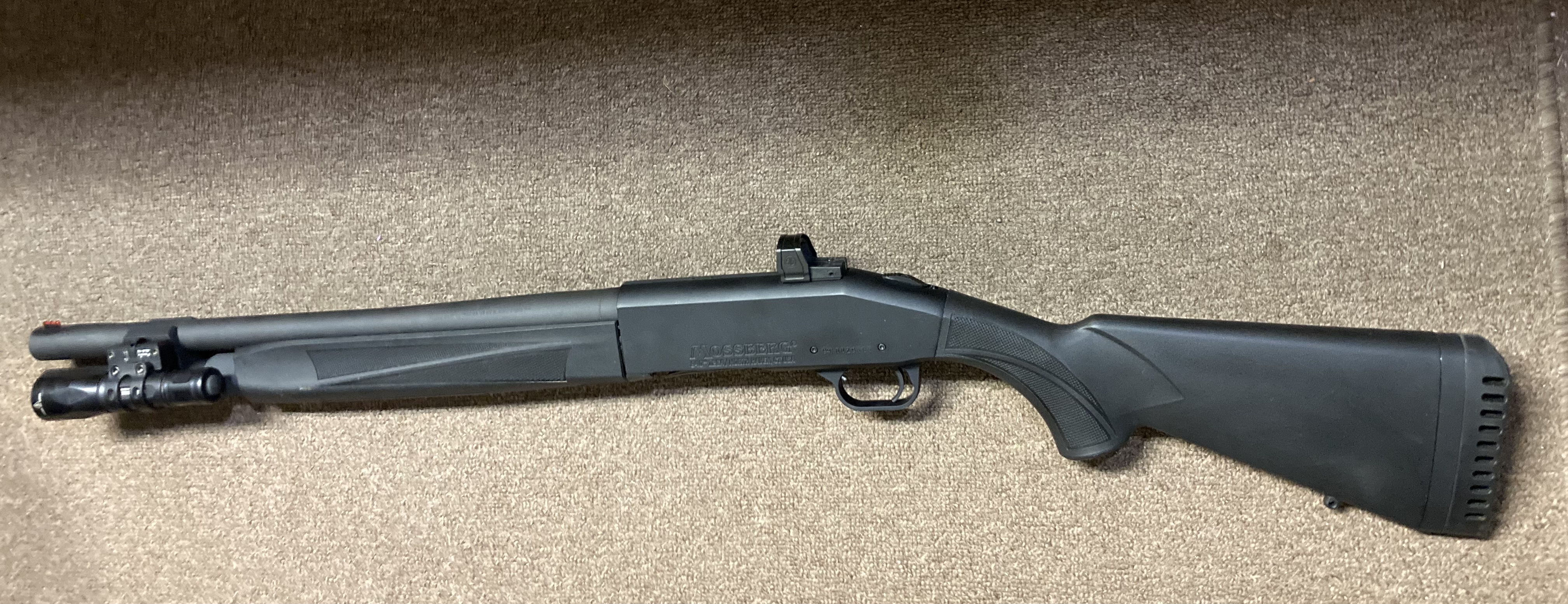

I have a 940 pro tactical. I bought it from my buddy who had to send it back twice for jamming. Second time they replaced the barrel supposedly. We had suspected the bolt cutout in the barrel hood was the issue. Looks like we are right. Runs like a top now. But he went and bought the Beretta Patrol instead and I got a great deal on the Mossberg.
