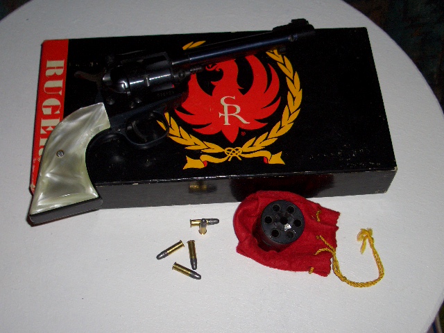

I wasn't concerned about collectability when an unconverted 1970 RSSMX had been sitting for a wile at the LGS. Actually, I couldn't scoop it up fast enough, living in a more restricted State. I didn't actually know the model at the time other than a SS. Over time I picked up a box, instructions and a Mag cylinder. I just like the idea of a close to complete package.

Purchased this in 1967. As one can see both the LR and the Mag cylinders are fluted. I gave this gun to my oldest son as he had fond memories of taking him out shooting, loading it with blanks and teasing him about not being able to hit the broad side of a barn.
After a year, I kinda missed that gun and came across a new single six with adjustable sights. It too has both cylinders fluted. It was mfg. in 1973. I have rarely used the LR cylinders as I prefer the .22 Mag.
