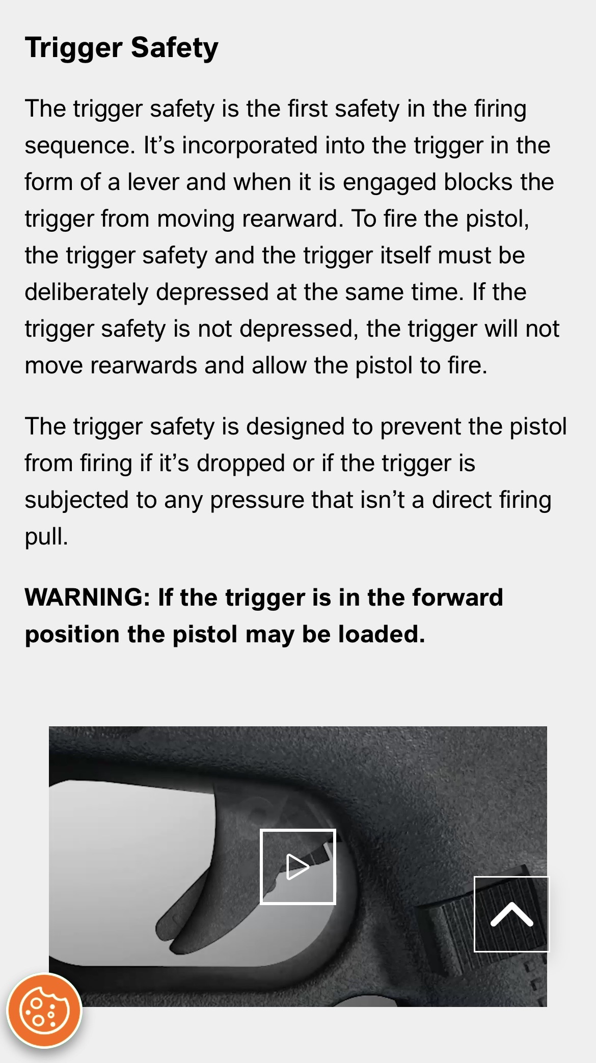

Blume it's not a double trigger. The center blade is a safety.....just like on Ruger pistols and rifles, Savage and so on......
No idea about the other brands

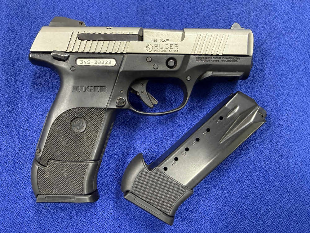

I do have a Ruger SR40c but I'm not a big fan of the trigger and safety design.
Maybe with a lot more practice I'll get past that feeling of that safety slowing my finger insert and making what I want as proper contact on the pad of my finger..... jmo 🤔

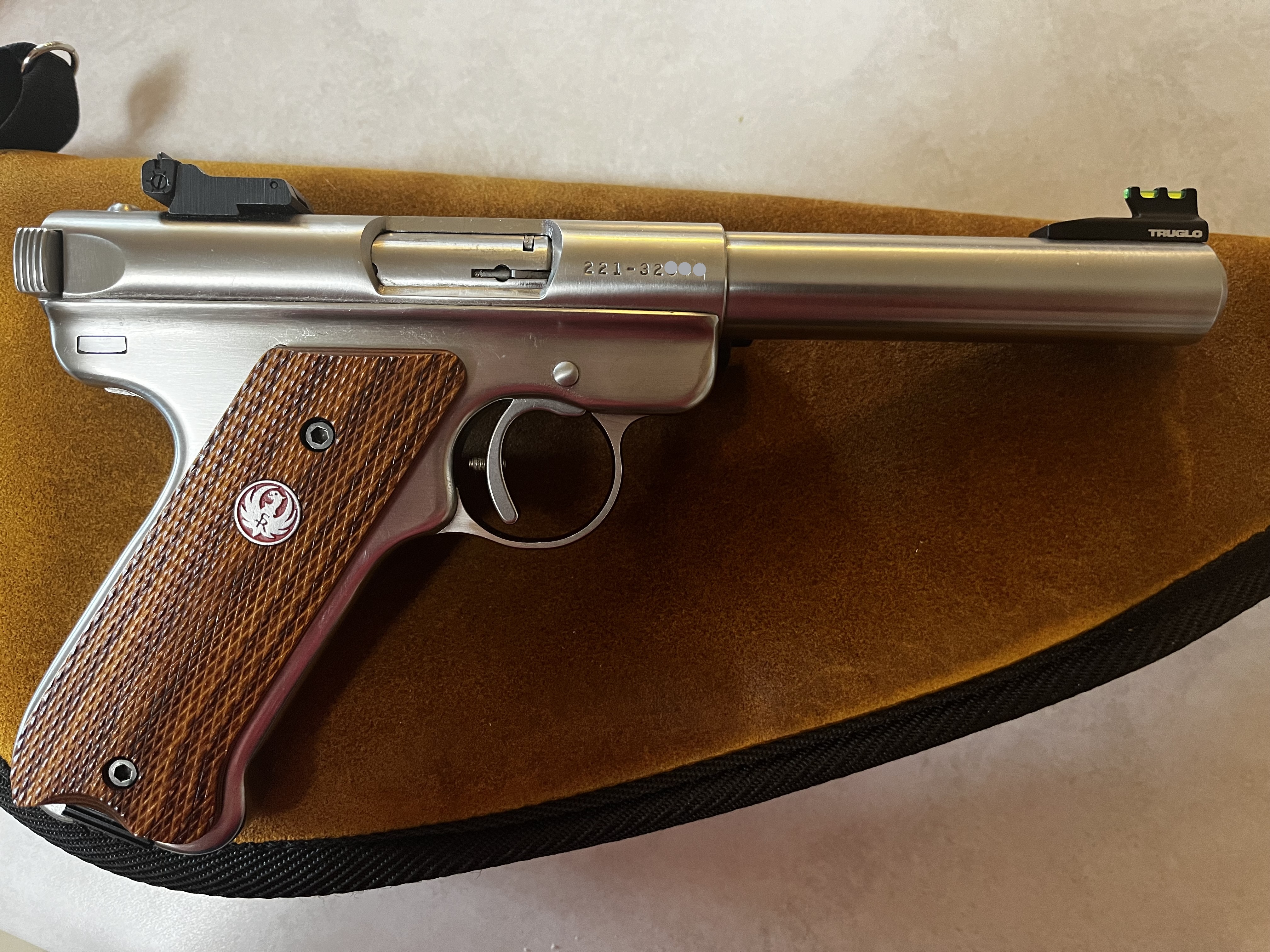

I like both flat and curved triggers. The first one is on my Ruger MKII and it's a curved Volquartsen, no grooves. It allows you to slide your finger down to the bottom for more leverage and lighter perceived trigger pull.

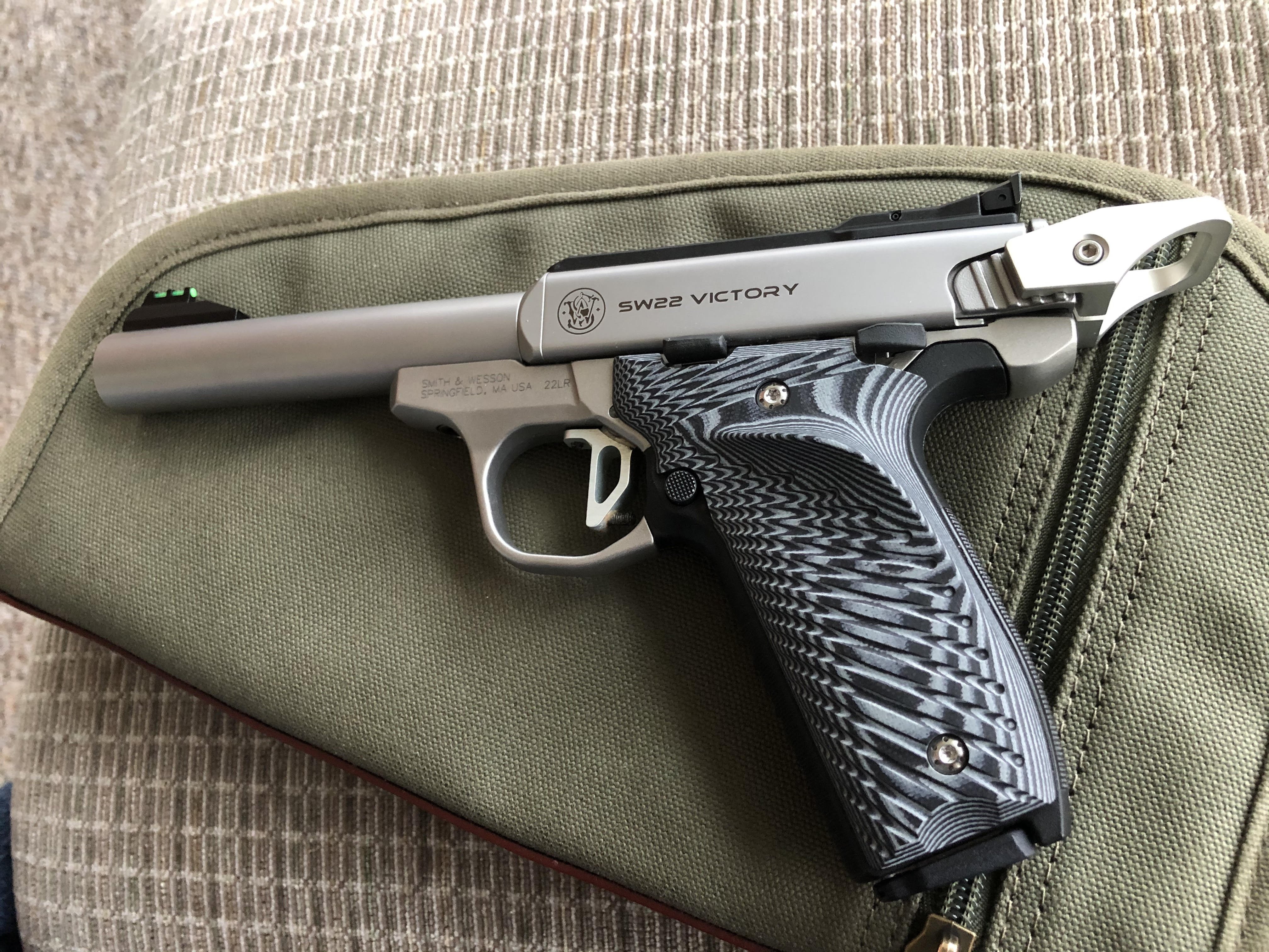

and then there is a flat faced Tandemkross trigger on my Smith & Wesson Victory. I like it but if Volquartsen made a trigger for the Victory I would buy it. The reason I say that is I wish the Tandemkross trigger was a little longer. There is plenty of room in the trigger guard to allow for that.
I'm just dense I can't see how it is a safety... somebody once did say it had something to do with the drop test. Seems to me it is just as easy for a foreign object as well as a finger to pull both as compared to a single piece trigger.
