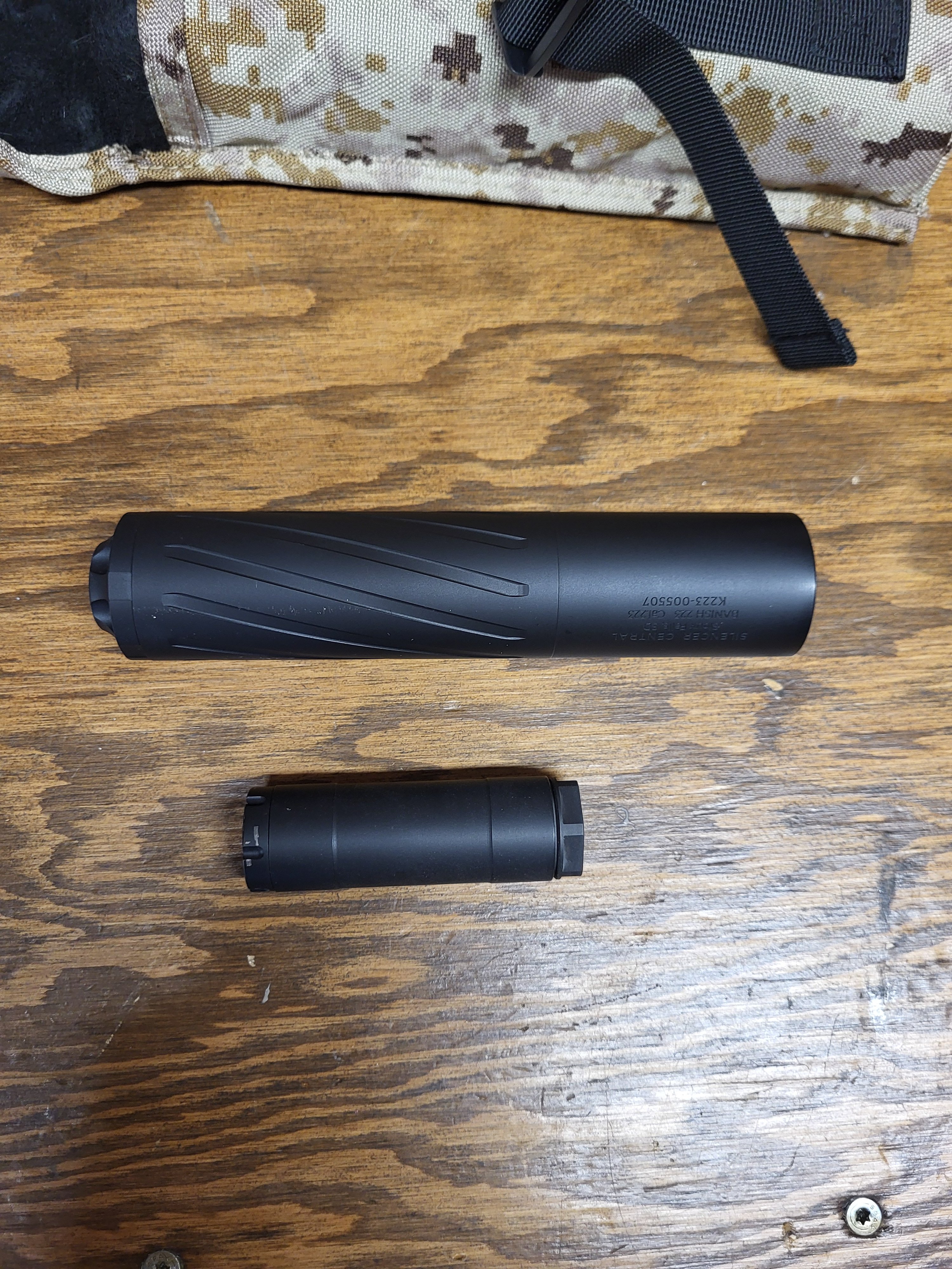

The large 1 is rated for .22 centerfire and rimfire. Smaller is rimfire only. Firing either of them on a 10-22. My ears can't detect a difference with CCI mini mags, regarding sound.
You would believe a 7 inch suppresser does more suppressing sound vs a 3.5 inch. It likely does but I can't hear any difference.
