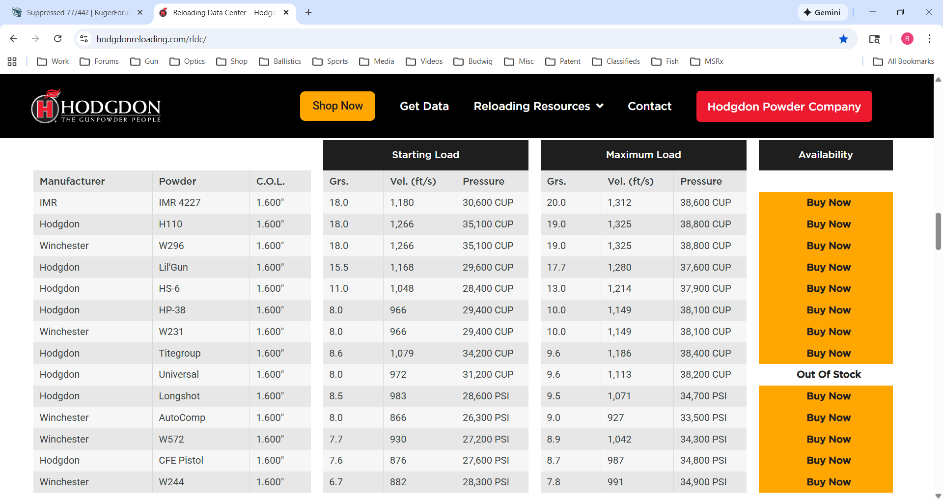

Anybody here shooting a suppressed 77/44? I'm looking for loads. Ideally, I'd like to drive a 300 grain XTP to 1050 fps. What little I've found is for 240 grain bullets. Share what you're shooting or point me to a source?

Thanks. I've been on Hodgdon's site but hadn't figure out how to get multiple loads at once. You showed me it could be done, so I messed with it until I figured it out.
Looks like several options will get you to a sub-sonic velocity with the 300 grain. I'd suggest trying some of the mid-range powders which will burn more completely in the rifle length barrel making suppression more effective.
