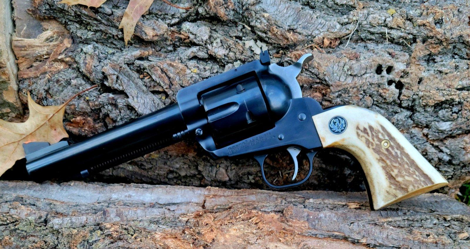

Flattop .44 (6 1/2" barrel)

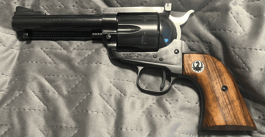

Flattop .357 (4 5/8" Barrel)

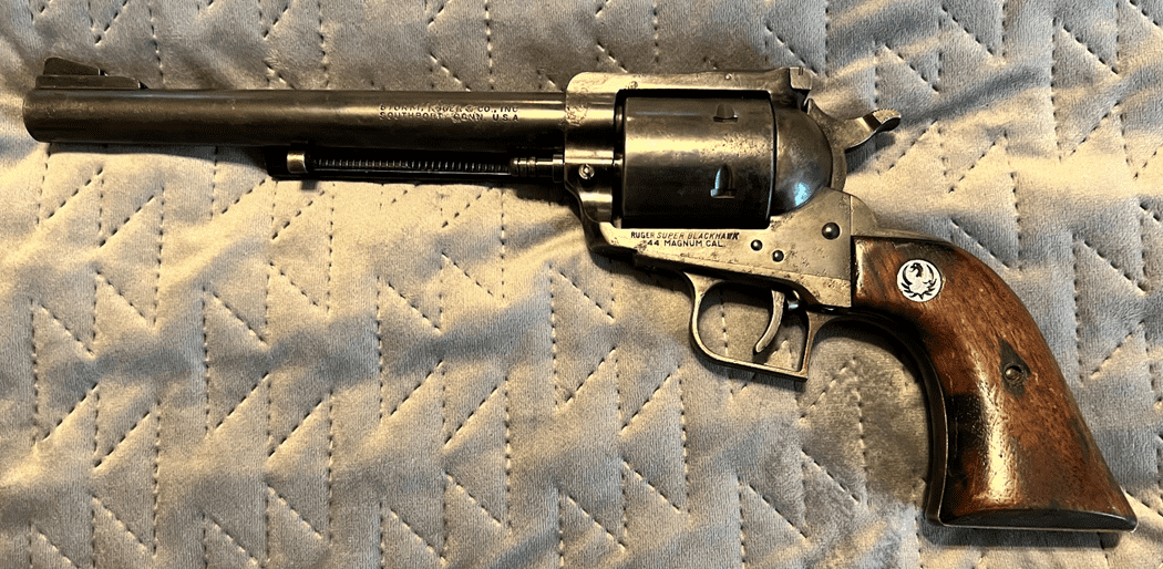

OM SBH (7 1/2" barrel) notice the difference in cylinders and trigger guards:

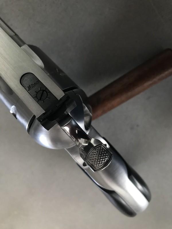

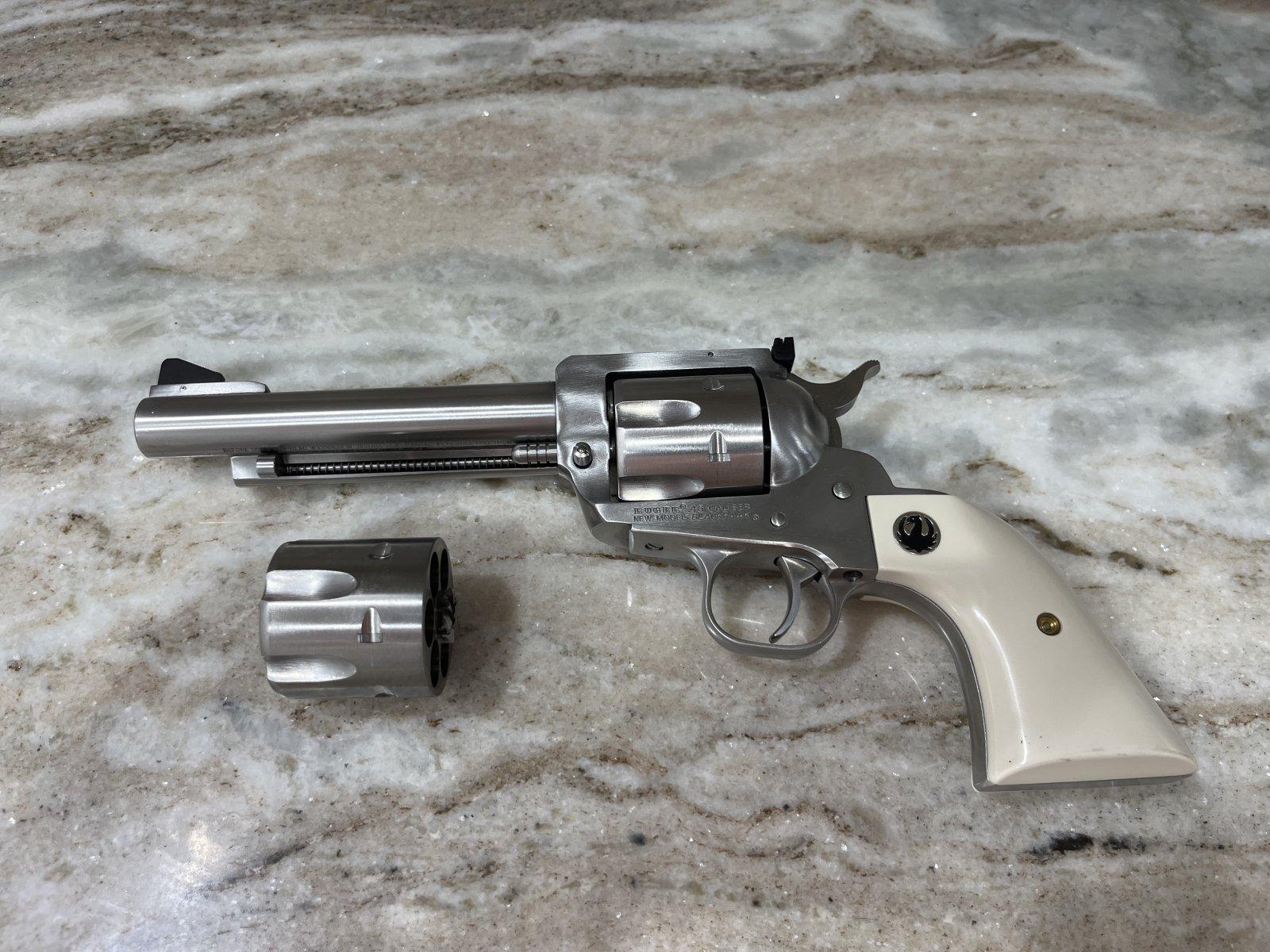

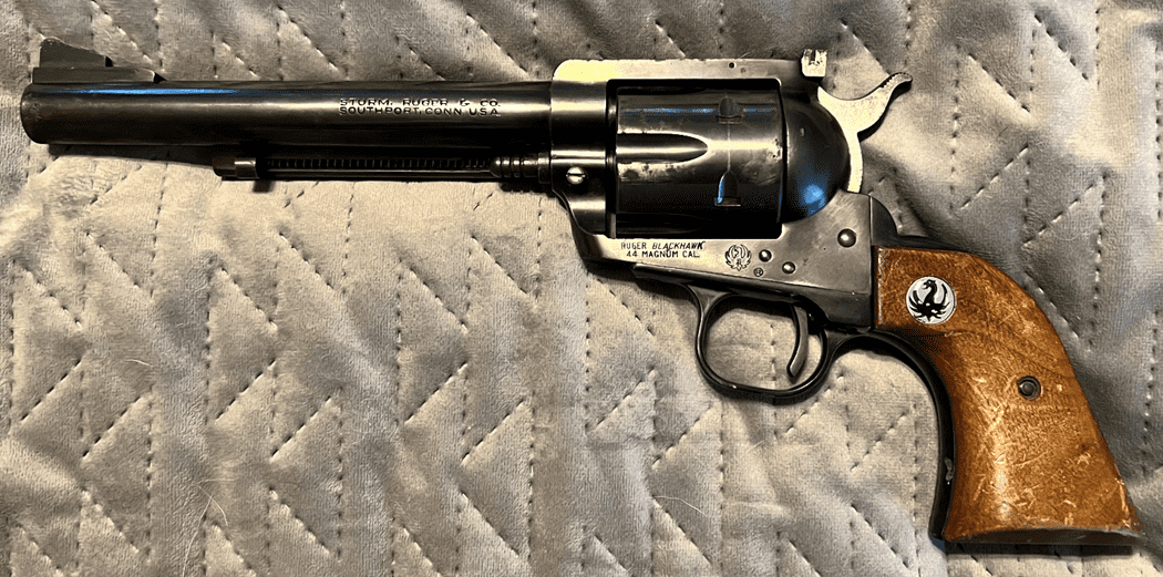

Top gun; 1958 Old Model Flattop 44, that has; Super Hammer/Trigger. A XR3-RED Brass GF with a straightened back strap to emulate the XR3.
50 years later,,,
Bottom gun; 2008 New Model Flattop 44, that has Super Hammer/Trigger.
A Hunter Brass GF w/ straightened back strap again to emulate the XR3. (same size as Dragoon Super grip frame but with a rounded trigger guard vs the square back of the dragoon.)
Both of these guns are built on the LARGE Frame,,,, Same Size Frame, as the OM or NM Super Blackhawk is built on.
FWIW: The Top Strap on NM FLATTOP is a bit thicker than the OM,,, made by Ruger that way.

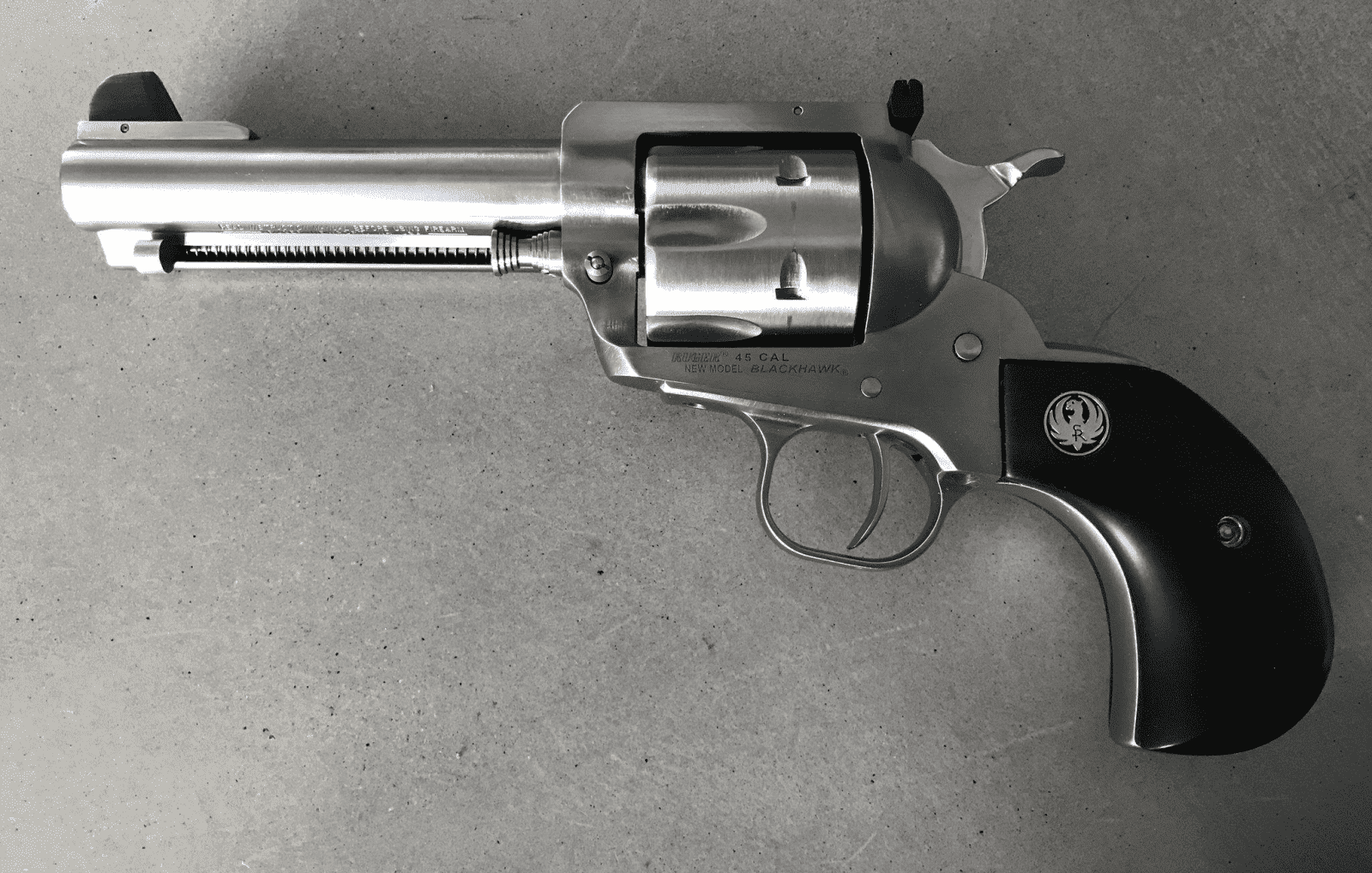

This being my custom 45 Cal. Flattop,,, is a MEDIUM frame, that has had the hammer changed out to a Montado Hammer, same as a Super Hammer but w/ cross cut checking. The NM thinner XR3 size Gripframe was changed out to the Birdshead. #5 Basepin
The Medium frame is good for 45ACP & Standard Velocity 45 Colt loads.
They can be loaded up a little to what is referred as a medium velocity load. Load Data is out there. Ruger ONLY 45 COLT LOADS, are a NO GO!
I shoot this gun using 45 Cowboy Special 99.9% of the time, very enjoyable, accurate, and easy

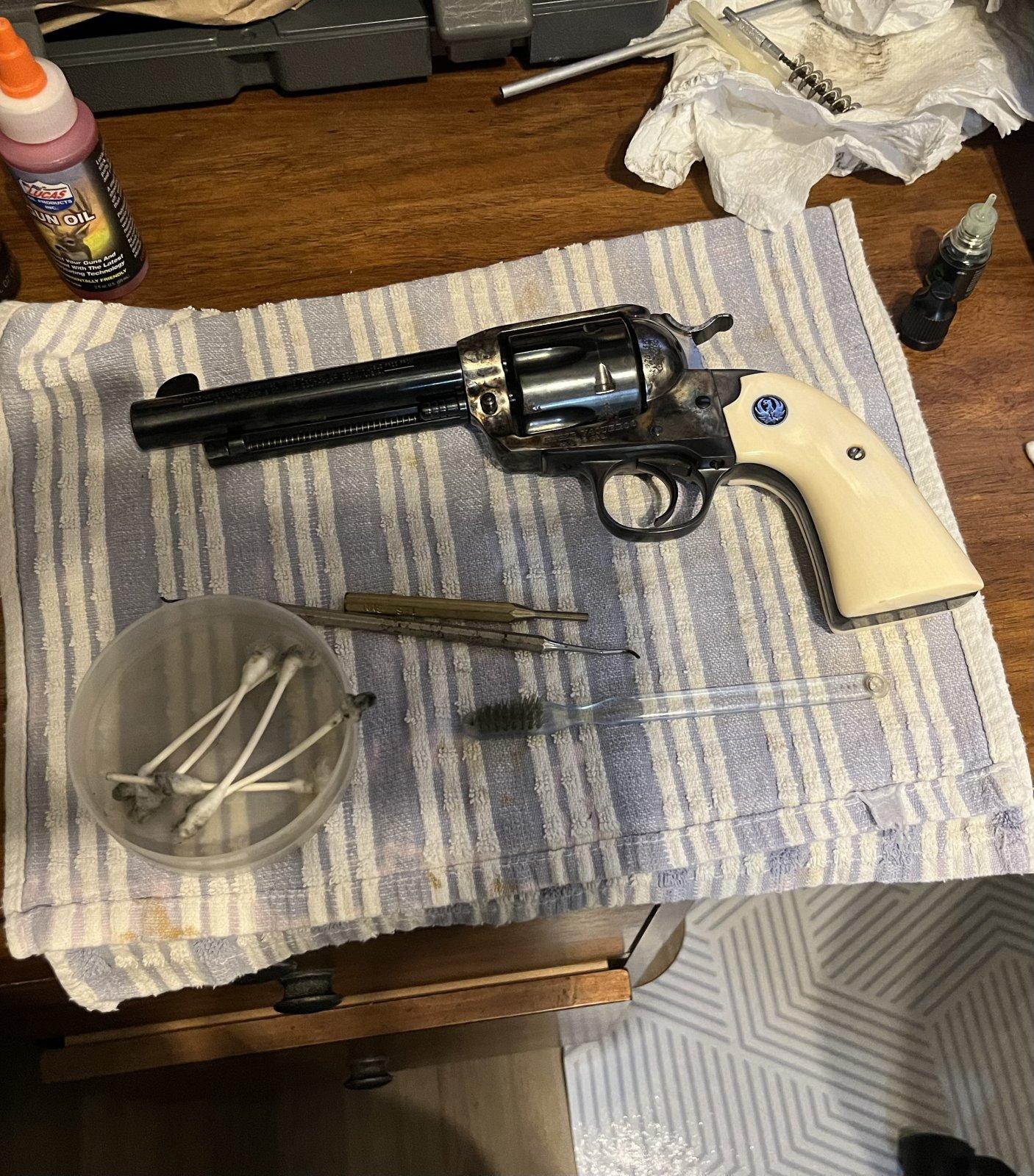

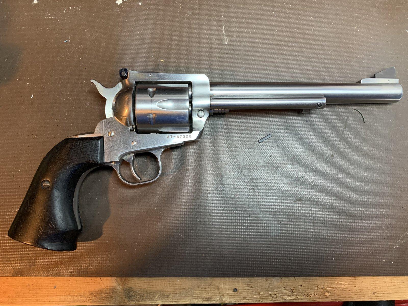

Large frame Blackhawk 7-12” barrel (a project gun) large frame Vaquero Bisley, and medium frame flattop, all in .45 Colt.
