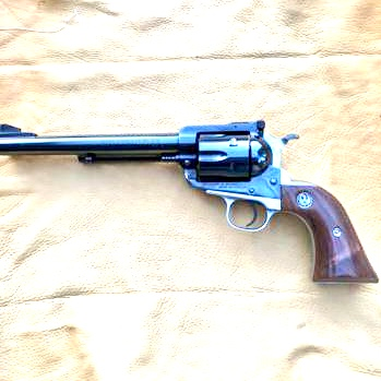

Just bought a Stainless Blackhawk flattop. looking for the Houge rubber grips. Will Model 83000 fit? Seems these are for the 'regular' Blackhawk, will these work OK?
The Flattops (and New Vaqueros) have the XR3 size grip frame which is 7/16" wide. So any grip made for the regular Blackhawk which has the XR3-RED size grip frame and is 1/2" wide, will likely fit loosely.
The website confirms the 83000 grip will not fit your Flattop and they do not make rubber grips for it.

You might consider installing the XR3-RED size grip frame that the rubber grips are made for. It's interchangeable with yours. Does your gun have the internal lock, or was it made after 2012?

Made in 2024. So is that doable to change out?
Thanks
Absolutely, easiest grip frame swap there is. Since you have a stainless gun, if there's minor fitting needed to the height of the grip frame "ears" around the hammer, you won't have to touchup bluing. And since your frame doesn't have a lock, it's mainspring is the same as the new grip frame.
But don't buy a new grip frame! They are oversize and need a lot of fitting and polishing. Buy a take off; post a want ad in this forum's classifieds.
Get one from a gun produced after 1998. That's when the mating surface on the main frame (for the ears on the grip frame) were raised so Bisley grip frames would fit any main frame to simplify production. Also made it easier for owners to exchange standard plow handle grip frames for Bisley grip frames.
@Tommyhof ☝️ what @Hondo44 said. You might even want to look at a Bisley gf with your larger hands.

I prefer the grip on the GP-100/SRH, and the Bisley feels similar in that regard. The plowhandle is fine for soft shooting cowboy action stuff, but there is a reason you see the Bisley handle on most of the heavy custom builds from Linebaugh, JRH, Reeder, etc....
I shot about 50 45ACPs today. Really enjoyed shooting, but my knuckle it feel the recoil. Going tomorrow as well, maybe try moving my hand a bit to clear my knuckle.
I'm on the hunt for a Bisley grip LOL.
That's because of the old model XR3 size grip frame; it has 1/8" less space between the back of the trigger guard and the front grip strap. Imagine shooting the first 44 Mag Blackhawk when it came out in 1959....with your grip frame. That was the reason it was replaced by the XR3-RED (redesigned) size grip frame in 1963.
