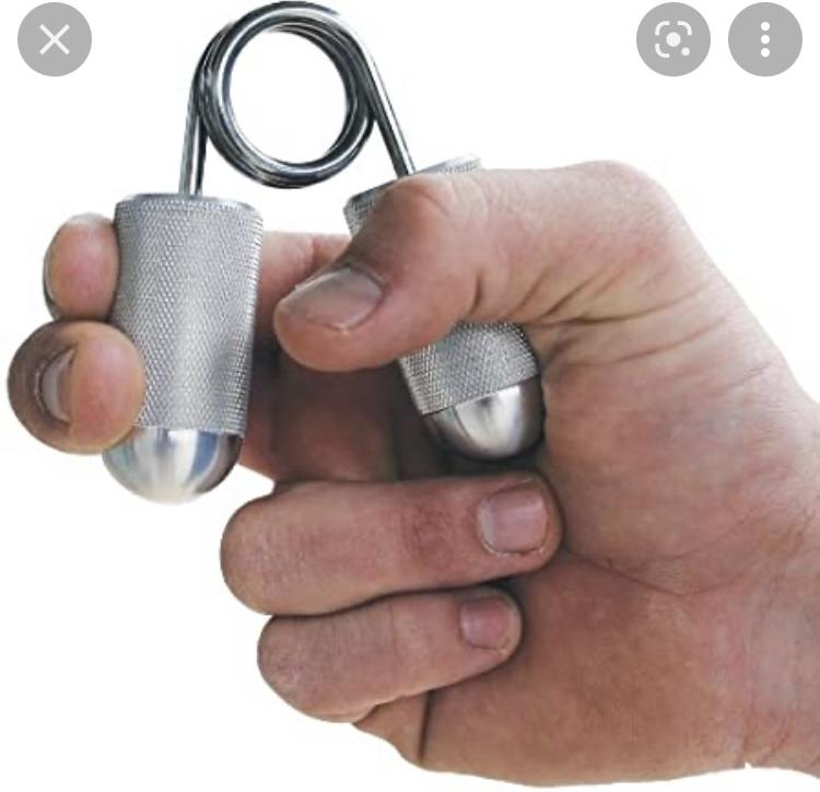

The Iron Mind TUG finger gripper for one or two fingers is excellent for developing f di usual finger strength. The Iron Mo d hand grippers are good for full hand strength.
