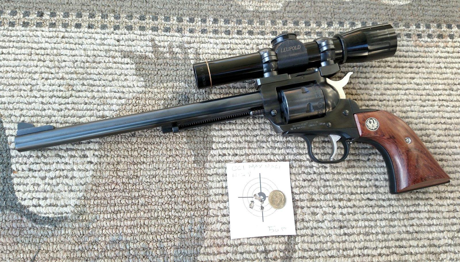

Ok,
So I have owned a few of the revolvers and a few MK's.
To my thinking the revolver should be more accurate than an MK.
Kinda like a bolt rifle being more accurate than an AR for the most part, not always of course.
So I have yet to see the revolver come even close to MK in accuracy.
What say you?

I don't have a single six(never had a 22 revolver). I have one 22/45 III and three 22/45 II. I'd be very surprised if the single six comes even close to the 22/45 accuracy. The thing is: I've not found a 'doggy' Ruger 22 pistol. What's the average accuracy expectation of a random group of singe six revolvers?
I’ve had Single Six and MKII ( not III ). Had a couple different barrel lengths MKII.
Never ever in a million years was I as accurate with the revolver as I was with the MKII. Not even close.
I never owned a MKlll, but...
The first MKll I ever bought was a Competition model. No reason to suspect it would shoot any better or worse than a MKlll model.
I mounted a 2x6 scope on it and shot consistent one small hole 10 shot groups at 25 yds. off sandbags--over and over again with Winchester Power Points. I'm talking 3/8".
About the same time I shot my '75 Super Single Six off sandbags and the best 6 shot groups I got averaged 1.84" with the same Power Points, though without a scope.
It would take a rare Single Six that could outshoot a MK anything.
You have 6 different chambers with varying dimensions on a revolver and only one on a Mk III. I’d bet the lock time on the single action is longer as well, so you have to hold steady for longer while you wait for the hammer to strike. Add in the rigidity of the fixed barrel of the semiauto vs the slight wobble possible between the cylinder, cylinder pin, and the barrel of a Single Six and I can see why the Mk III frequently outshoots one.
The auto will likely be easier for most to shoot accurately. But to say for sure that one is more accurate than the other would require a lot of testing.
I've had several Single six hunters and a single MkII Target. The Mk II was much more accurate. With a revolver, there are multiple chambers and forcing cones that have different alignments with the barrel and you have a varying space for gas to escape. Just an awful lot of places for things to be different with each shot.

It just seems obvious, given the mechanical differences that the Mark series pistols would provide superior accuracy over the Single-Six revolver...Where the post convertible Single-Six shines accuracy wise, is with the 22 Magnum cylinder installed. Some will argue until they're blue in the face about this, but every last one I've tested has provided far superior accuracy in 22 Mag, due to the bore actually being rifled for that particular cartridge.

A decade or so back, when I was testing .22 ammo, I put a scope on my 5.5" Mark II and proceeded to shoot groups under 1" at 25 yards with it with several different kinds of CHEAP .22 ammo. Runs in my mind the best groups were around 1/2" at that distance, with Winchester Dynapoints. That was the best performance of ANY of my .22 handguns.
NONE of my SIX .22 revolvers has ever shot even ONE group close to that performance, and the Single Six is the least accurate of the six.
So that's MY answer to your question. As always, YMMV. ;)

I find the Mark II to be more accurate by a small margin. I like the 5 1/2" bull and the 6 7/8" taper with target sights to be my favorite. The latter having a longer sight radius and a slightly better trigger shoots best.

Done the same, 10" and 6 7/8 slab, one hole at 25 yards. Love my revolver, feels great in my hand if it goes to the door in the middle of the night.
