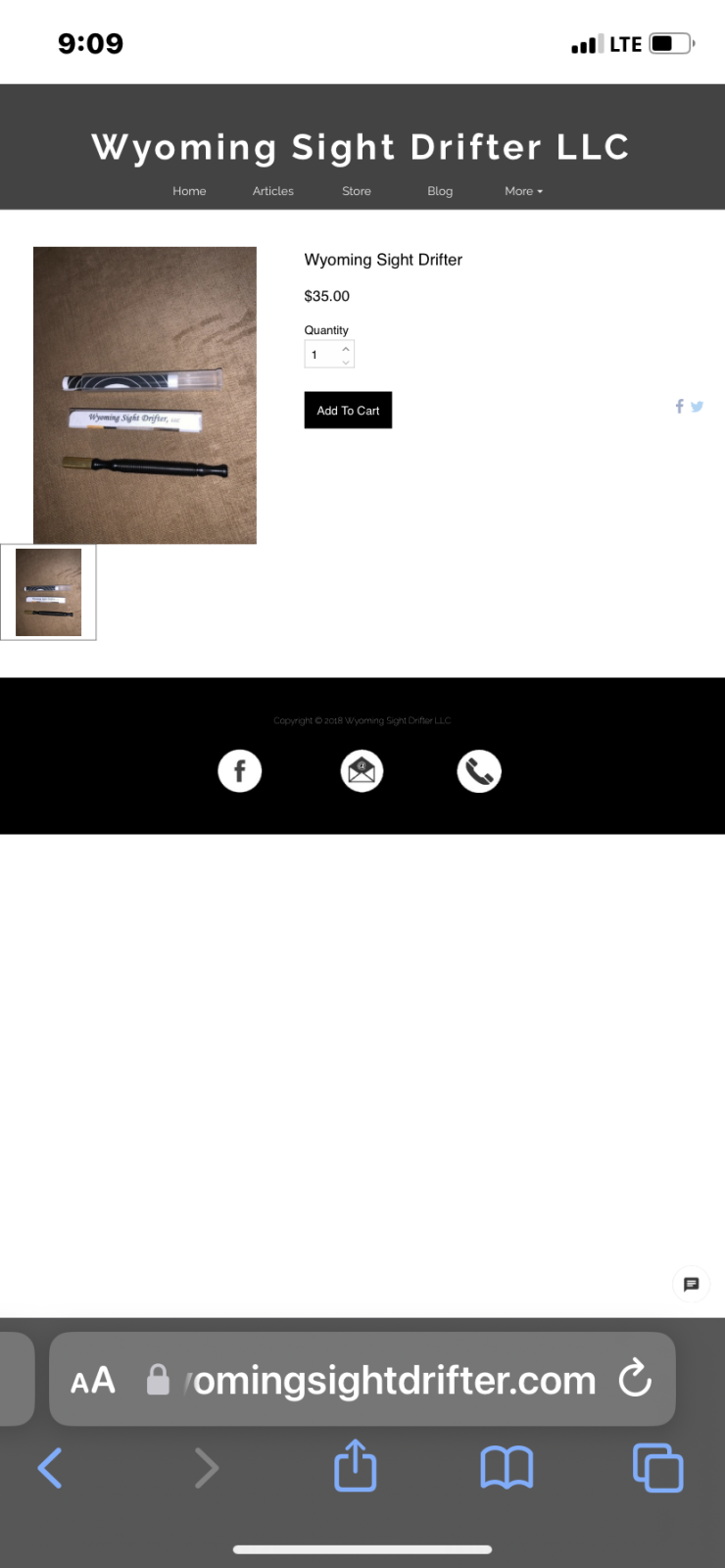

https://www.midwayusa.com/product/1019396518/
