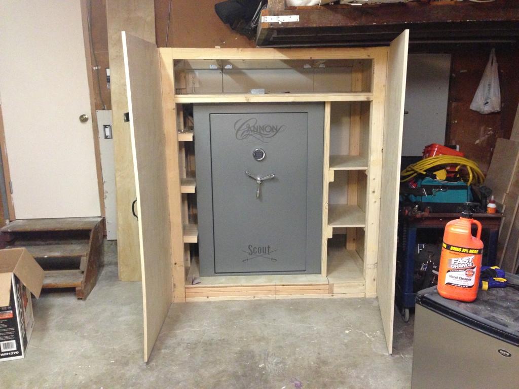

I did a lot of research on safes and theft before buying mine and figuring out where to put them. Most safes, even the good ones are vulnerable to attack on the top, back and sides, only the front door is secure (on some that isn't even true).
The safe in the picture below is substandard, not even a safe in my opinion (a residential storage container), but the owner did something smart, he built shelves around it and then concealed its location. It is always best if they cannot find it, but if they do, the safe should be bolted to the concrete and have something protecting the top, back and sides.
The longer it takes to get to the safe and get it open, the less likely they will bother with it.
Also keep any tools that can be used to get to or to open the safe locked up. Most burglars only carry a screwdriver or small prybar.
Here is the perfect stealth idea to work from. If wanted, you could also add an alarm in the house for if the wood door is opened, even as far as sending a text to your phone with right setup.
The wife rules more than a lot us want to admit (Happy wife, happy life). So you will do as she desires.... with the conditions of how it is protected.
I mean.... she does not want the guilt of having the stolen weapons in the wrong hands..
